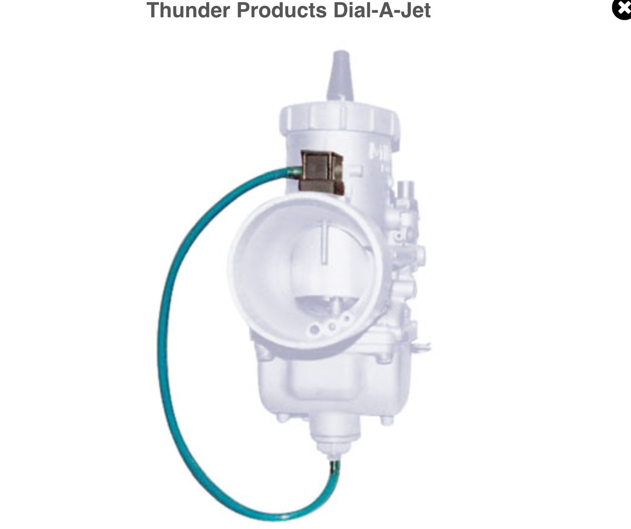

One question… the Lectron self-adjusts for altitude/temperature changes. How does the RB do this?
If it doesn’t, that’s the only difference I’m aware of. However, it appears the Dial-A-Jet kit for about a $100 (with the required snorkel kit) would do this. Has anyone tried one?
https://www.rockymountainatvmc.com/part ... al-a-jet-p
