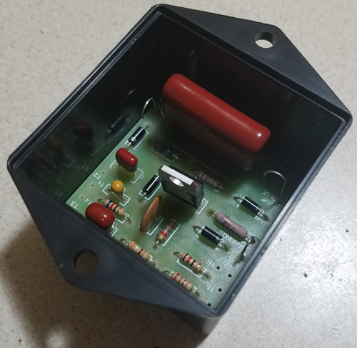

The failure of the Jaguar CDI is something I kind of saw coming. While his electronics were awesome, his execution could have been better. See, the Jaguar CDI died due to nothing more than vibration. Here's a pic of the Jaguar CDI I bought...
- Jaguar CDI.jpg (160.23 KiB) Viewed 44115 times
The large orange-ish capacitor at the bottom is what failed initially as it broke it's leads at the circuit board. I didn't bother to remove the whole CDI from the bike when it failed and the next time I opened it up the IC chip had broken off as well. I even installed the CDI using a rubber insulator but it didn't stop the breakage.
Anyway, notice what's different between it and a what you see on a factory Kawasaki CDI? The factory CDI is potted and the Jaguar one is not. For those that don't know what potted is it means that the electronics are encapsulated in a special epoxy. That shiny black surface on the back of your factory CDI is the epoxy potting. The epoxy seals off the electronics from moisture and dirt, acts as a heat sink,
and it protects the electronics from failure due to vibration. My CDI will be potted and the switches/jumpers will be the only things exposed (they will be water/dust proof) but still held by the epoxy so they don't fail due to vibration.
On worrying about it failing, well, like I said, I thought a failure was probably likely so I left my factory CDI mounted in place and mounted the Jaguar in another location. I didn't modify the factory wiring in any way so, when it failed, it was just a simple unplug one CDI and plug in the other and I was on my way riding again. The CDI I am planning to build will not suffer the same fate as the Jaguar CDI but electronics can and do fail at times. I would always recommend keeping the factory CDI mounted to the bike just in case of a failure. Of course, I do plan to offer a warranty on my CDI and, if it were to fail, I would either replace or refund at the owners request. I haven't figured out what my warranty policy should be completely yet but I am trying to figure it out.

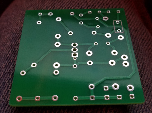

Look what finally showed up today! Woohoo!
- cropped.jpg (111.56 KiB) Viewed 43395 times
Posted: 12:38 pm Jan 29 2022
by Slick_Nick
Oh dude! This is gonna be sweet!
Posted: 03:33 pm Jan 31 2022
by Kawibunga
That sure looks like it's going to be properly done!! Very nice!

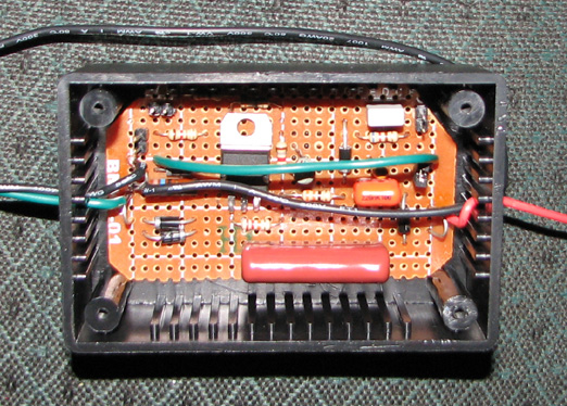

Setbacks are the name of the game, can’t tell you how often this has happened to me. Anymore I just expect things to be wrong when I order stuff. When I was a kid I remember being sooo excited to order something out of Boys Life magazine and then to get it and be disappointed with it’s form or function. … why I never ordered the hovercraft kit!
QUESTION… so the pink cdi that guy did has two tiny switches in his non-potted design. How are you going to set up your switches? My son’s 2008 KTM 144SX had an adjustable cdi that you had to pull the tank, find the harness, unplug one wire, and then plug in another. This softened the hit and gave better soft terrain traction. I liked it softer, but Henry liked it in ‘wild mode’ better so I bought some tiny red push button switches on Amazon and wired one in that I mounted under the tank for easy access. Problem was, it was kind of hard to tell which mode you were really in without hammering the bike. So it would be nice for this interface to allow you to just look at it and know.
Does this make sense? So what do you have in mind for mode changes? Let me know if I can help you model some practical ideas from a user-interface perspective. Something bar-mounted would be interesting to consider.
