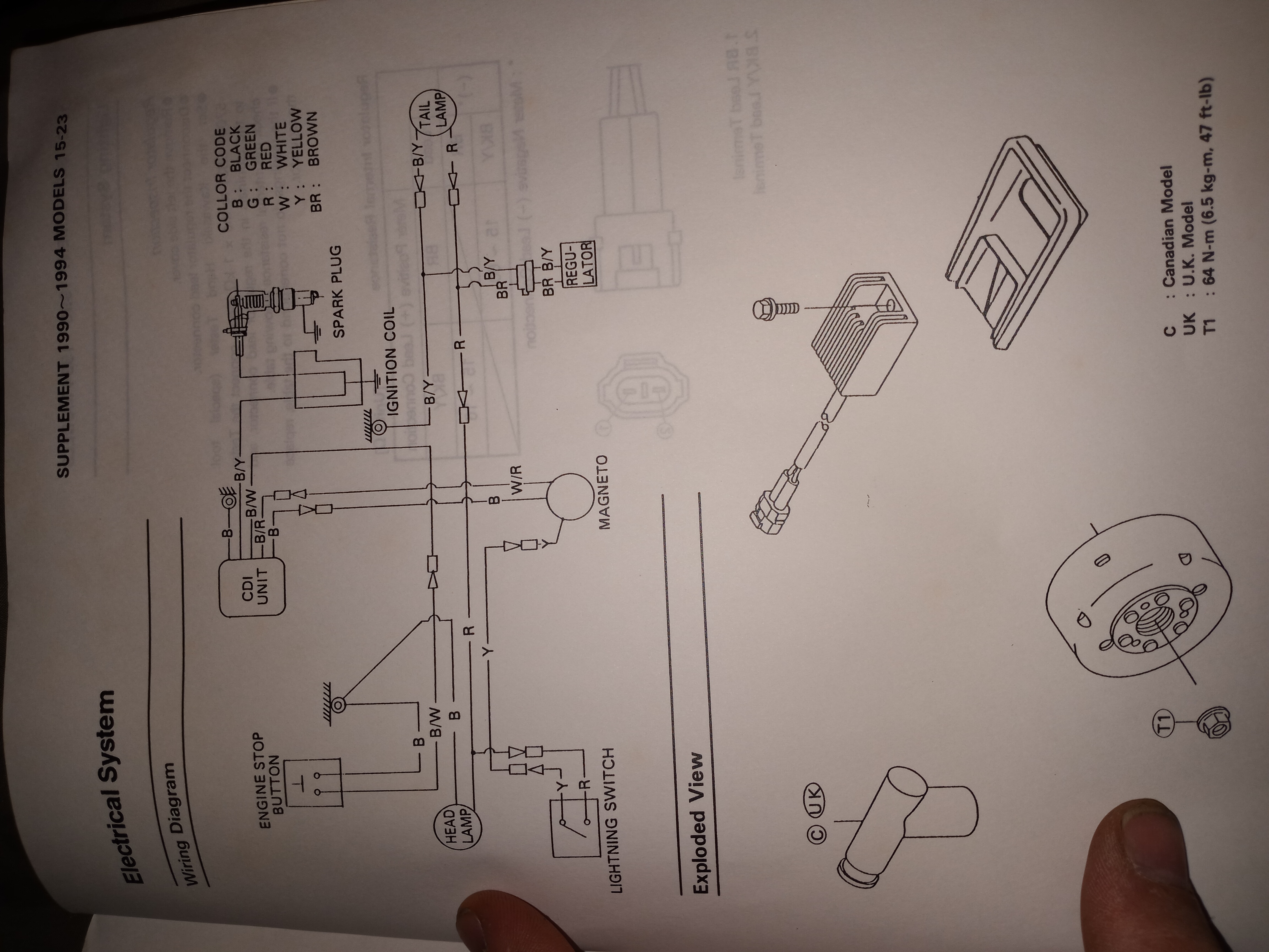

One thing we couldn't find is how is the ignition system grounded? The bolt from CDI to steering frame is clean and no rust but the frame is still painted factory green from day 1, but I couldn't find any other ground to main frame. We checked wires looking for cracks or rubbed insulation and all looks good. So the bike now has a new stator, coil, spark plug wire & boot and new spark plug. Swapped out CDI & lighting regulator from a working bike.
I've searched and read all the posts I could find on here and tried all the suggestions. Unfortunately I'm pretty limited knowledge when it comes to electrical systems and diagnosis, but am good with following directions. Any suggestion on what I'm missing?

About the only thing never checked is the wire going from the outside flywheel cover to the coil. I guess I would just look for continuity to make sure wire is good.
Any ideas appreciated, if not its shop time and $$..........................................Opihi

If all your parts are known to be good and in working order, that sounds like a wiring issue. If you have a multimeter electrical tester I can get you some resistance values to check on those parts. Are the magnets on the flywheel strong still and in place? Timing marks lined up on the plate the ignition pickup coil and lighting coil are mounted to?
