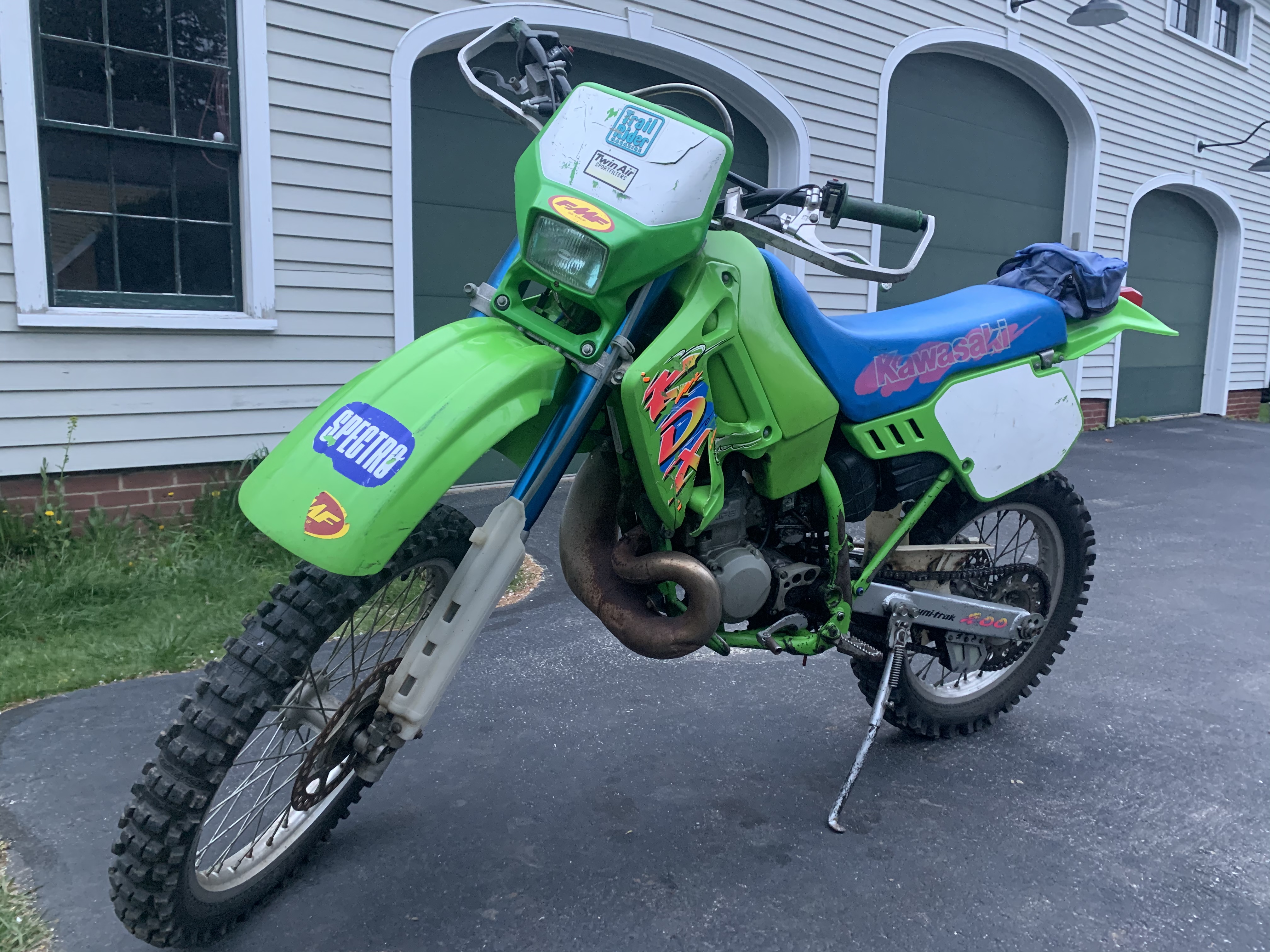

This is my first real post here after reading a lot. I have a fairly new to me 1993 kdx200 that I have been going through. It is clear the maintenance has been neglected, so Ive flushed coolant, changed trans oil, semi-straightened brake rotors, replaced bars/adaptors/grips, muffler packing, countershaft seal, front sprocket, and a couple other small things here and there.
I am fairly competent fixing bikes and I'm mechanically inclined. It starts right up first kick and runs great.
It sounds healthy at idle (rattly at idle as they usually are) but when I get up into 5th and 6th gear under load, theres a knocking sound that it makes. I cant tell if its top end or bottom end (as i was going 40-50mph on the road at night and didn't want to take my eyes off the road).
Im not sure of when the top end was last done, if ever. It doesnt seem to have a TON of hours on it, given I can tell its definitely been ridden by the wear on the frame. The odometer was broken at 59mi, so ill never know.
Could this knocking be carbon deposits on the piston? Or would this knocking be the common kips rattle and I just didn't realize it would sound like this?
I havent pulled the kips cover off. is there any fluid in there or is it dry? im not yet sure how the kips system works.
Thanks for any help, it is greatly appreciated. If i can figure out how, Ill attach some photos so you can see the patient.

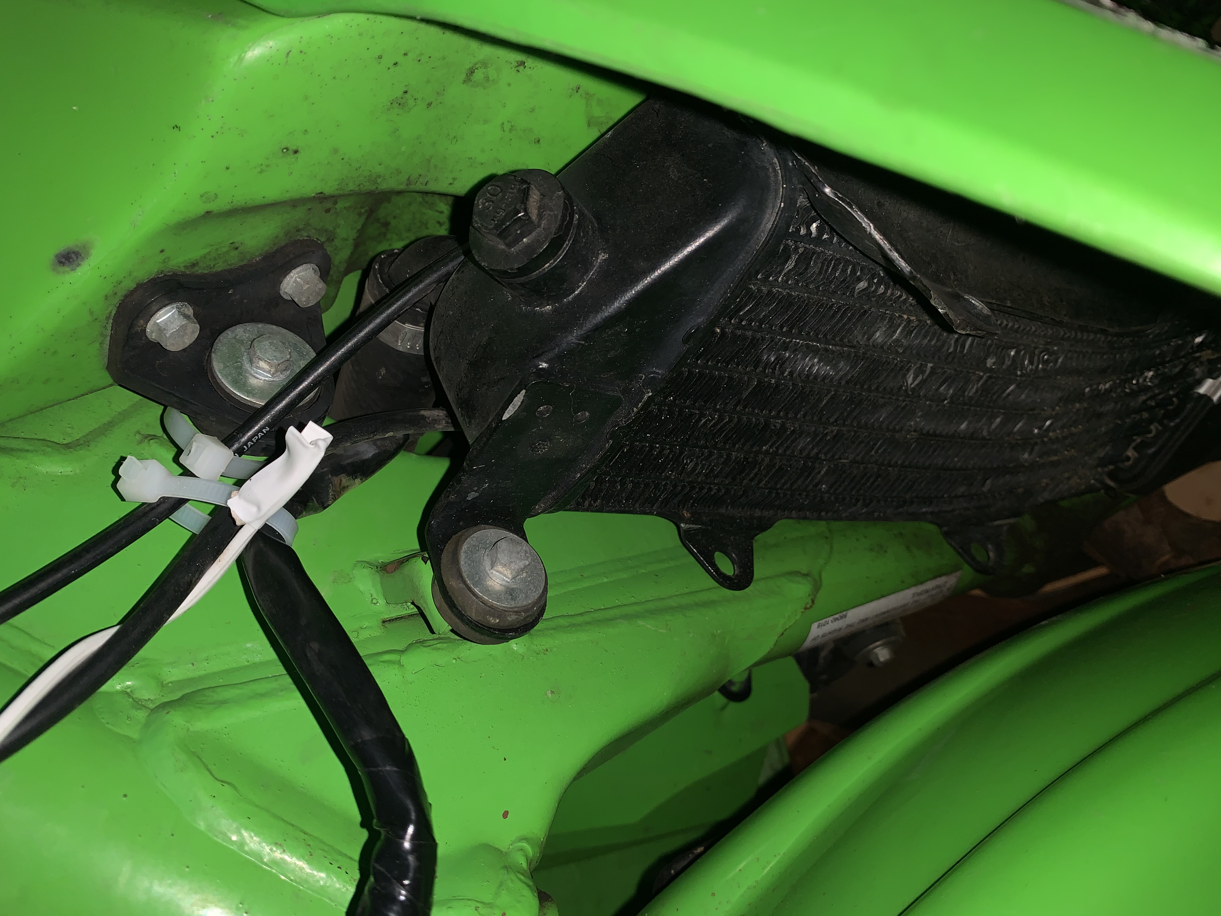

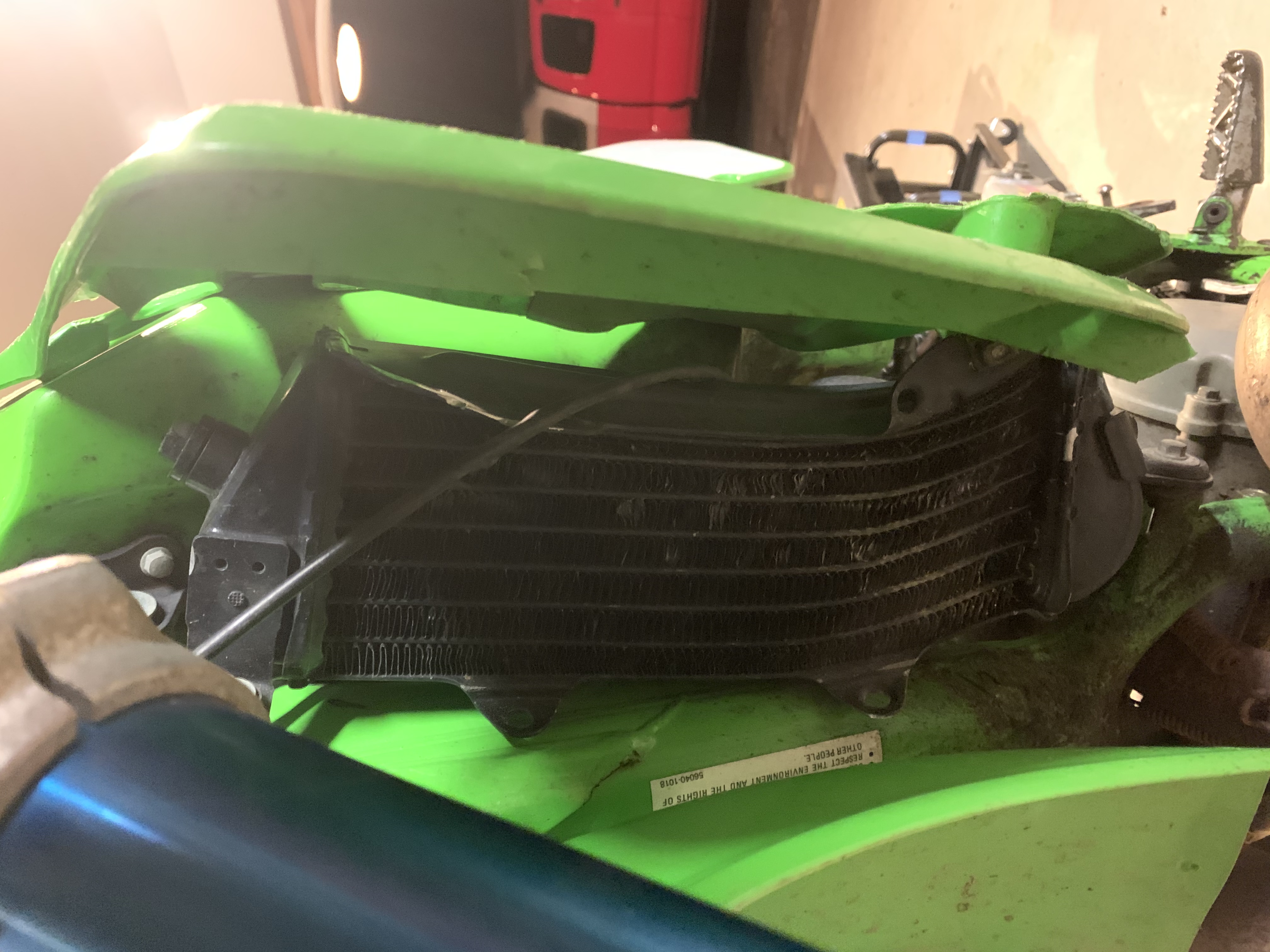

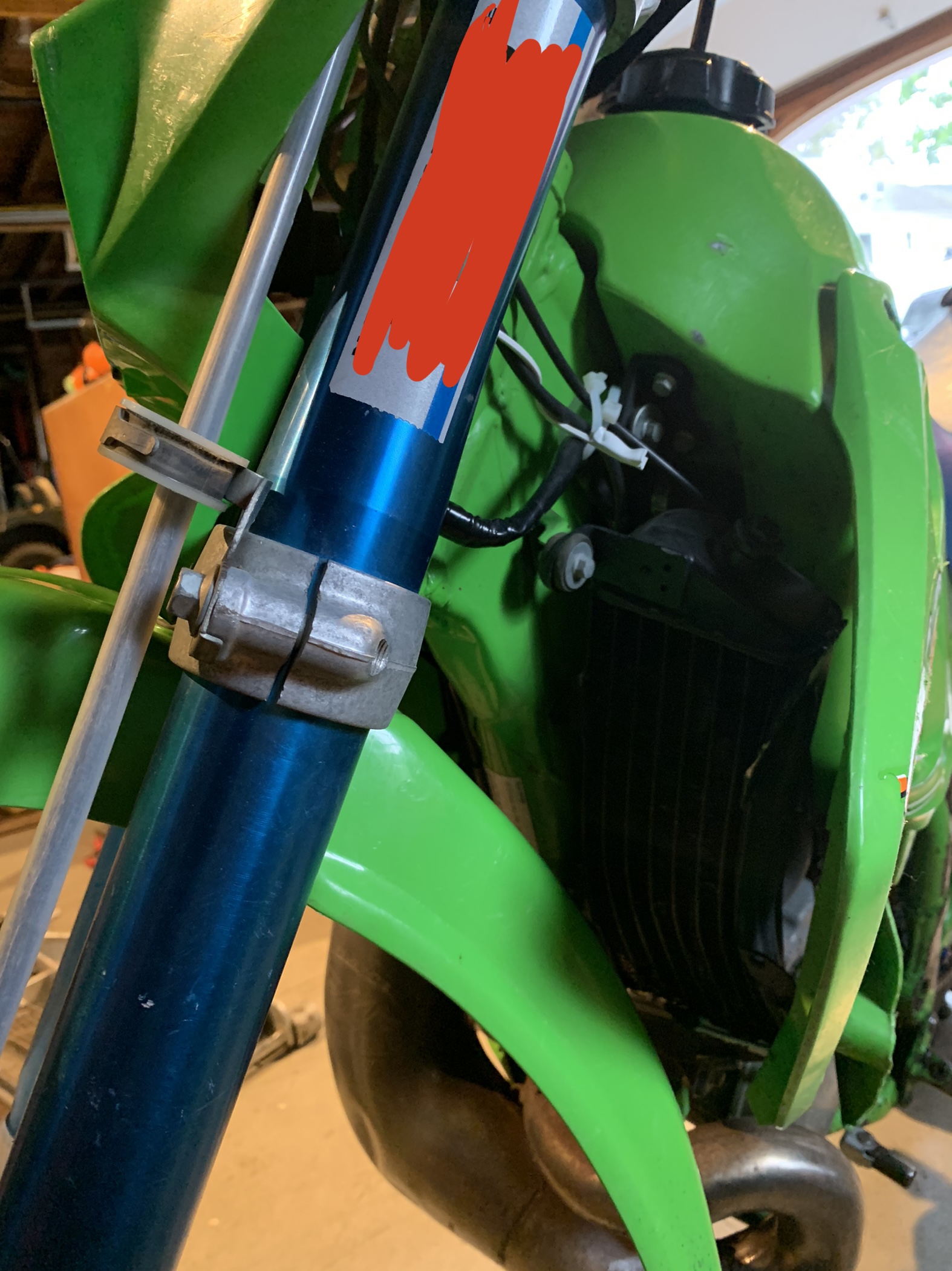

Radiator:
Posted: 02:00 pm May 30 2021
by Goofaroo
You definitely need a radiator. Are you sure you aren’t just hearing the radiator banging against the frame while you’re riding? Stick a piece of rubber between the radiator and the frame and see if the noise stops. Is the radiator mounting tab broken off the frame?
Posted: 02:11 pm May 30 2021
by Goofaroo

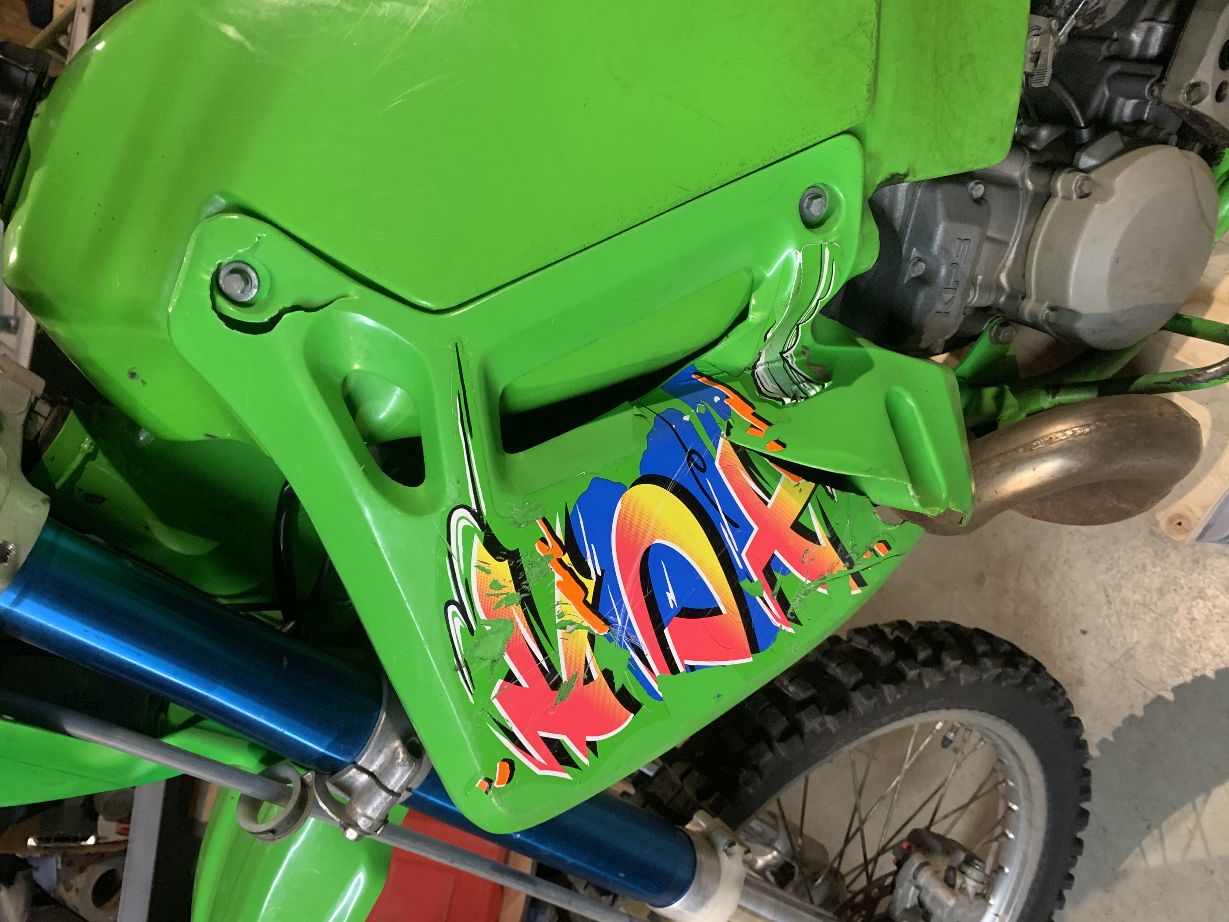

A bigger problem is the crack in your triple clamp. This bike took a very awkward hit.
Posted: 02:16 pm May 30 2021
by emmett
Goofaroo wrote: 02:00 pm May 30 2021 You definitely need a radiator. Are you sure you aren’t just hearing the radiator banging against the frame while you’re riding? Stick a piece of rubber between the radiator and the frame and see if the noise stops. Is the radiator mounting tab broken off the frame?
rad is solid and does not move or rattle. I do plan on replacing it, but i am 100% sure that is not the noise. mounting tab is not broken either. and theres at least 1/4" between rad and frame and i cant make it touch the frame or even wiggle by pushing on it.
Posted: 02:21 pm May 30 2021
by emmett
Goofaroo wrote: 02:11 pm May 30 2021 A bigger problem is the crack in your triple clamp. This bike took a very awkward hit.
haha you had me worried for a second because that photo makes it look like a crack. but nope, thats just the clamp. My theory is the bike fell over onto a rock/sharp edge at a stop, and the rider weight added to the impact.
heres the clamp so you can see it.
