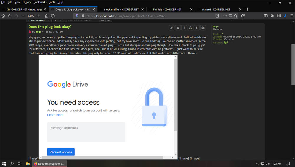

Hey guys, so recently I pulled the plug to inspect it, while also pulling the pipe and inspecting my piston and cylinder wall. Both of which are still in perfect shape. I don't really have any experience with jetting, but my bike seems to run amazing. No bog or sputter anywhere in the RPM range, overall very good power delivery and never fouled plugs. I am a bit stumped on this plug though. How does it look to you guys? for reference, I believe the bike has the stock jets, and I run it at 50:1 using Amsoil Interceptor with no problems. I just want to be sure that I am not going to ruin my bike. Also, this plug only has about 20-30 mins of runtime on it if that makes any difference. Thanks

You have to set the permissions for the pics to show up. I only see this...
