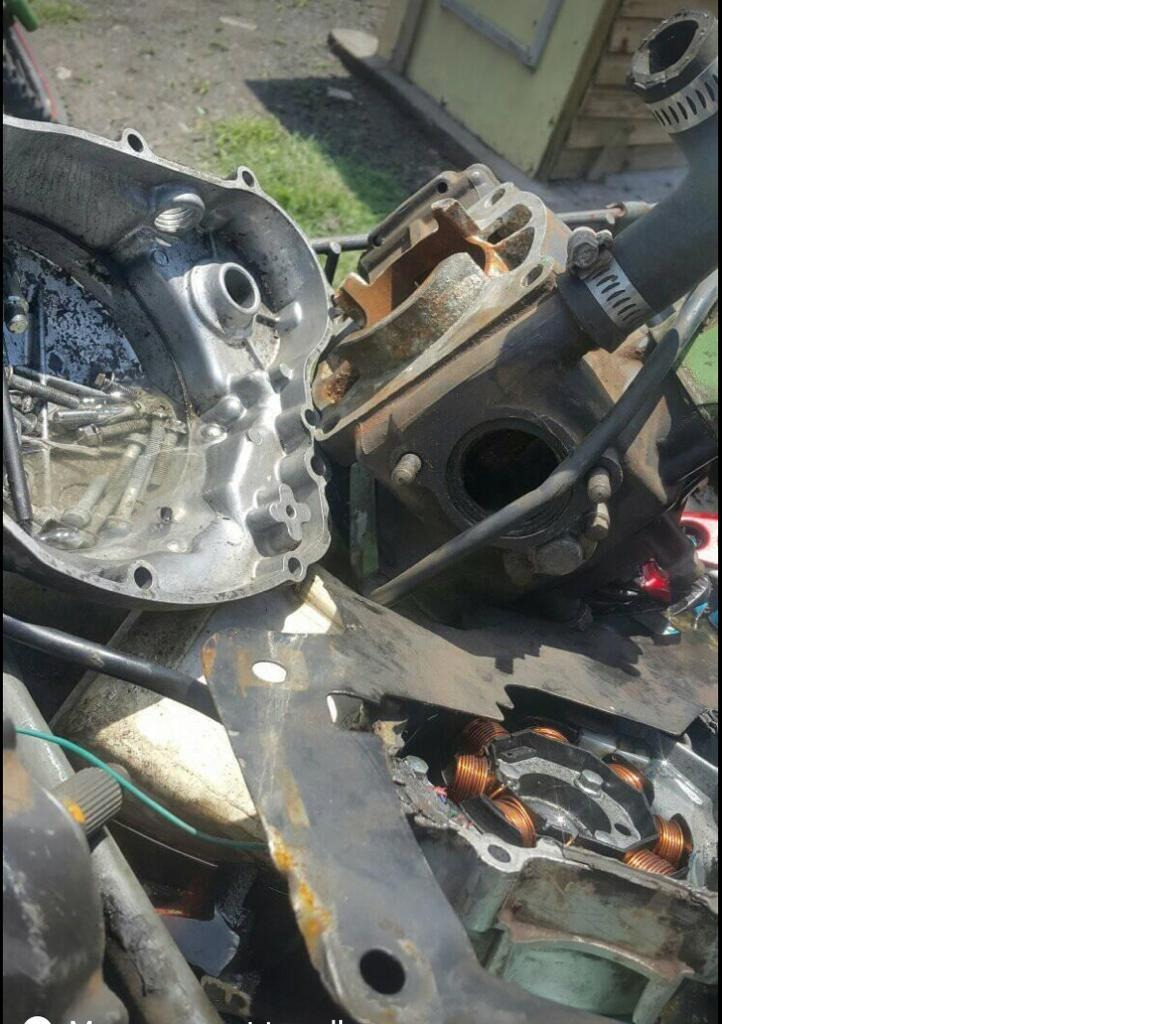

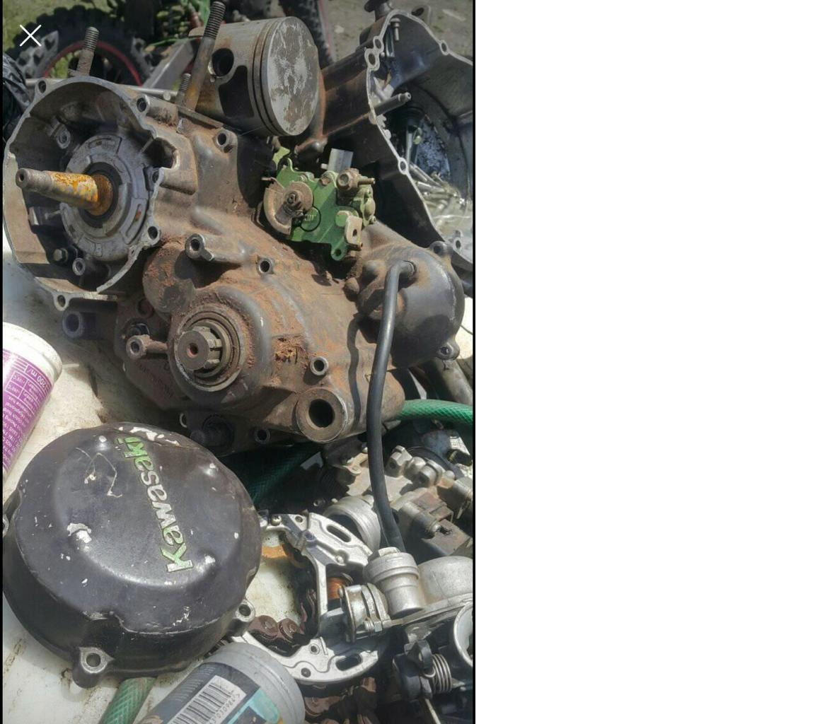

i am new to the forum and need help as i resently descoverd and you all know finding parts for the E series is a challange
i found a engine of a KDX 200 SR i assume it has the oil mix thing on the engine please tell me the parts of these two motors can be used as they are the same
i bought two E series KDX and the one is running the other motor is sized and a mess....actully both of them. But i cannot help myself i had to have them :oops:
so now we are at this point HAHAHA please help

Can you post a few pictures so we can see what you are looking at? Thanks.

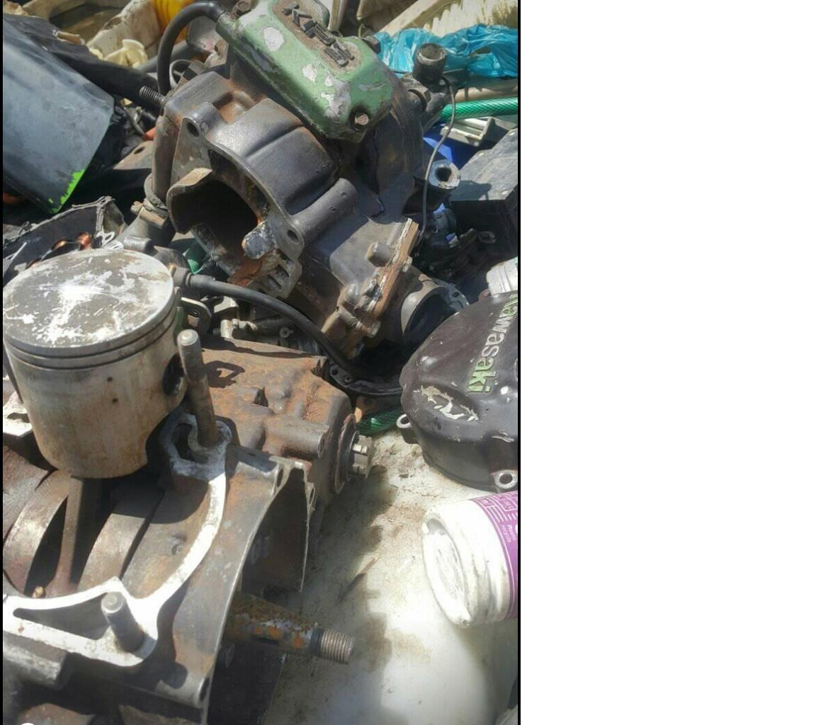

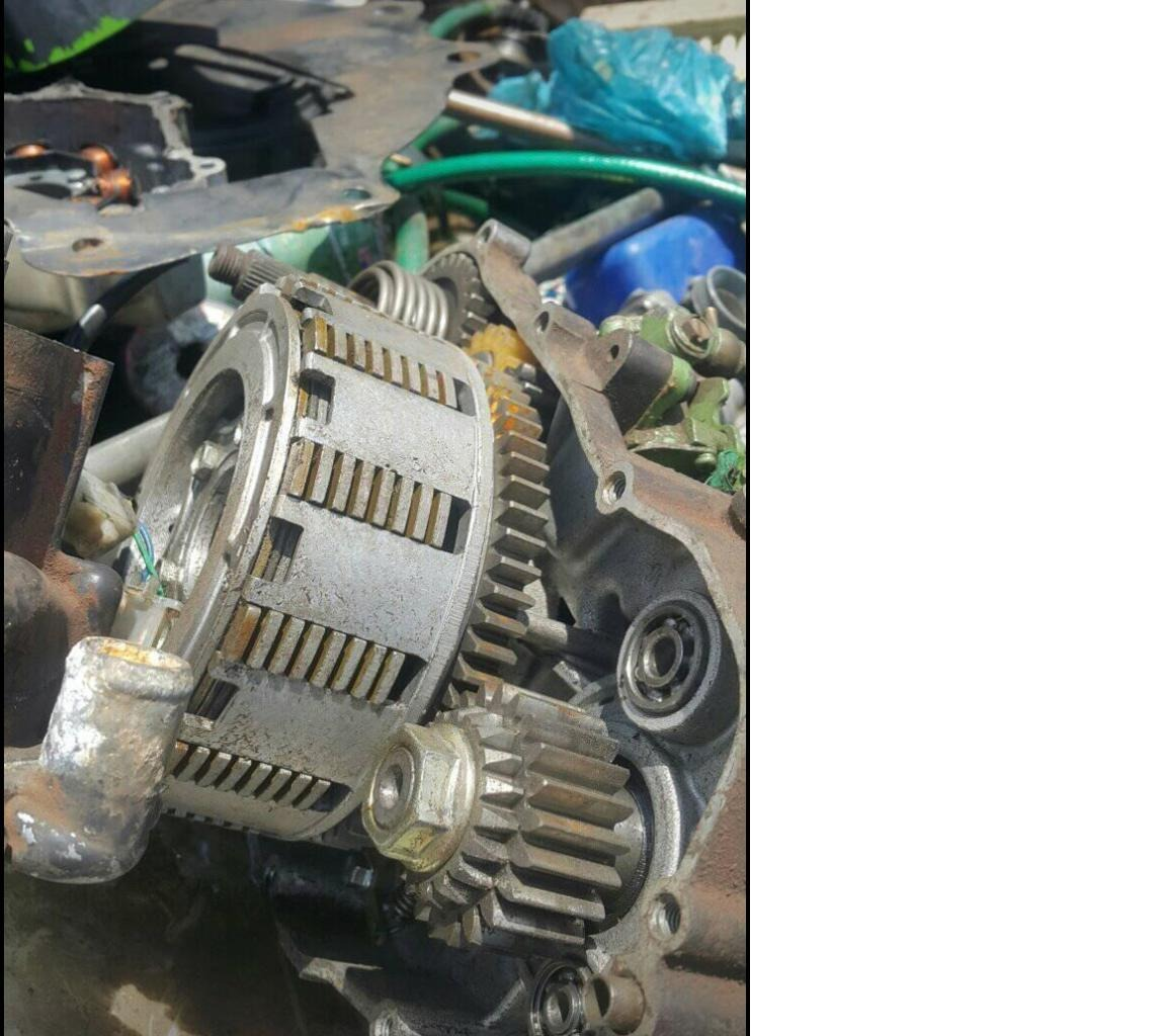

this is the craigslist add i am trying to buy this engine but the seller is not helpful

Re: KDX 200 SR suppliment KDX 200 E Rebuild
a lot of parts are different
oil pump
different carb
exhaust pipe mounts differently
generator (and cover) are bigger
