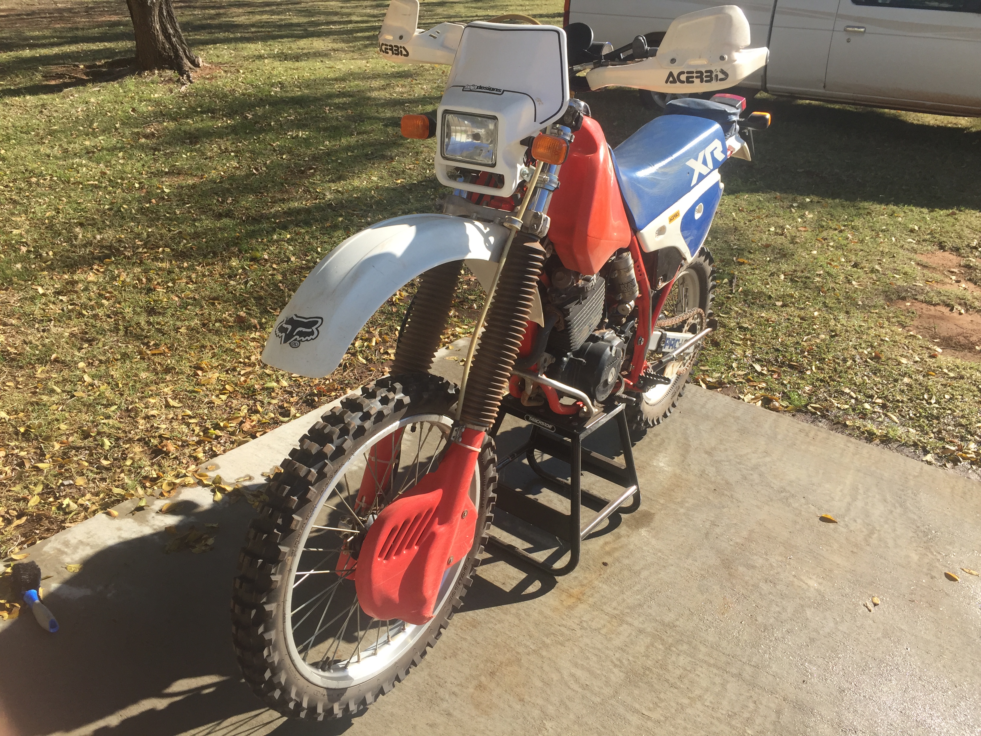

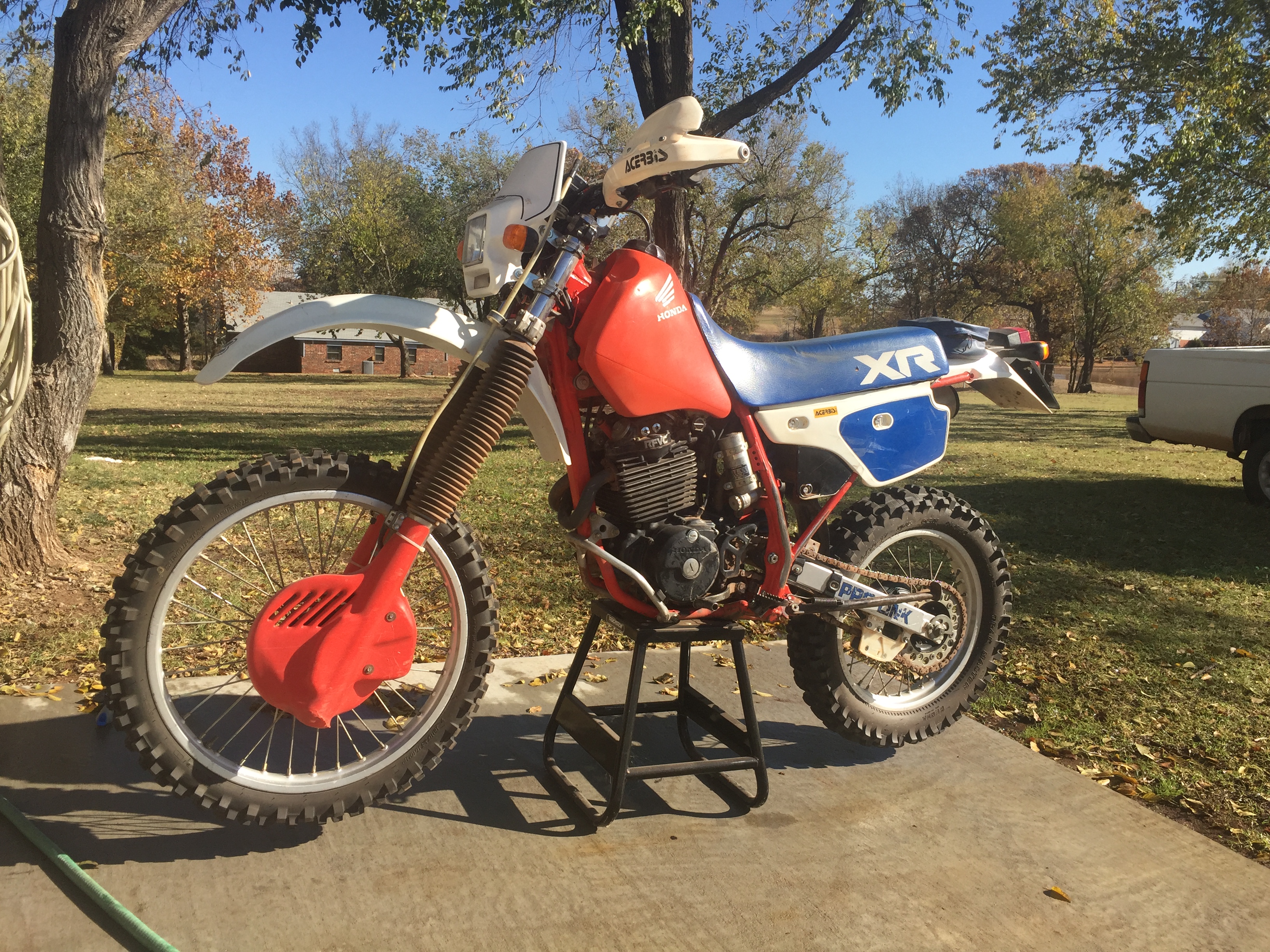

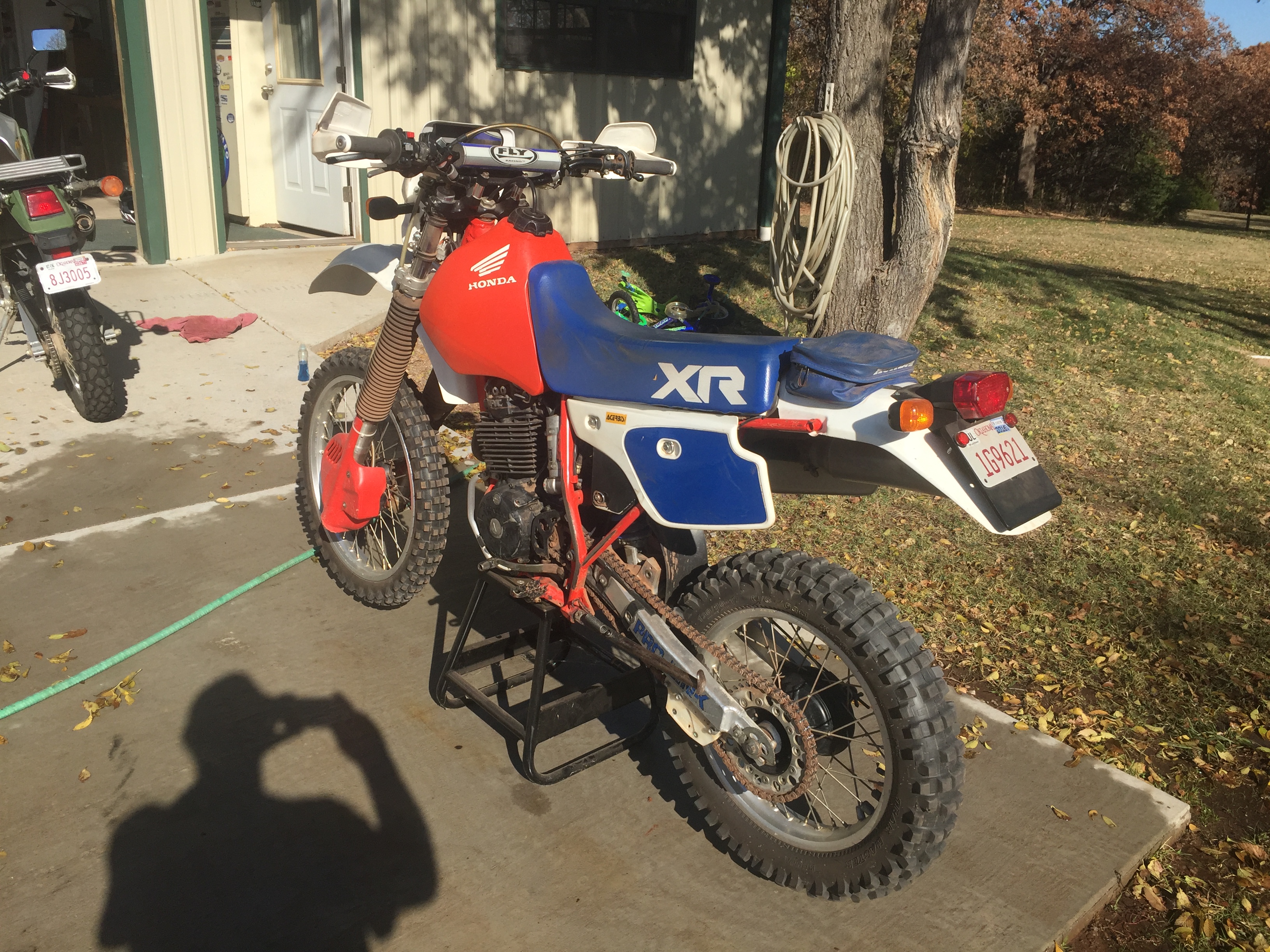

I used a Baja Designs kit. It had everything I needed. It has a battery in the headlight shell. I’ve had it on my XR for at least fifteen years. It’s been pretty reliable.
Tusk offers a less expensive kit but I don’t know if it has a battery.
