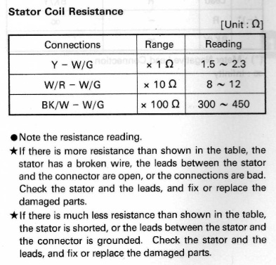

Does anyone know what the output ohmes should be on a kdx250 1991 model source coil please

I don't know if the UK version is the same but here's what I have for US spec '91-'94 KDX250.
