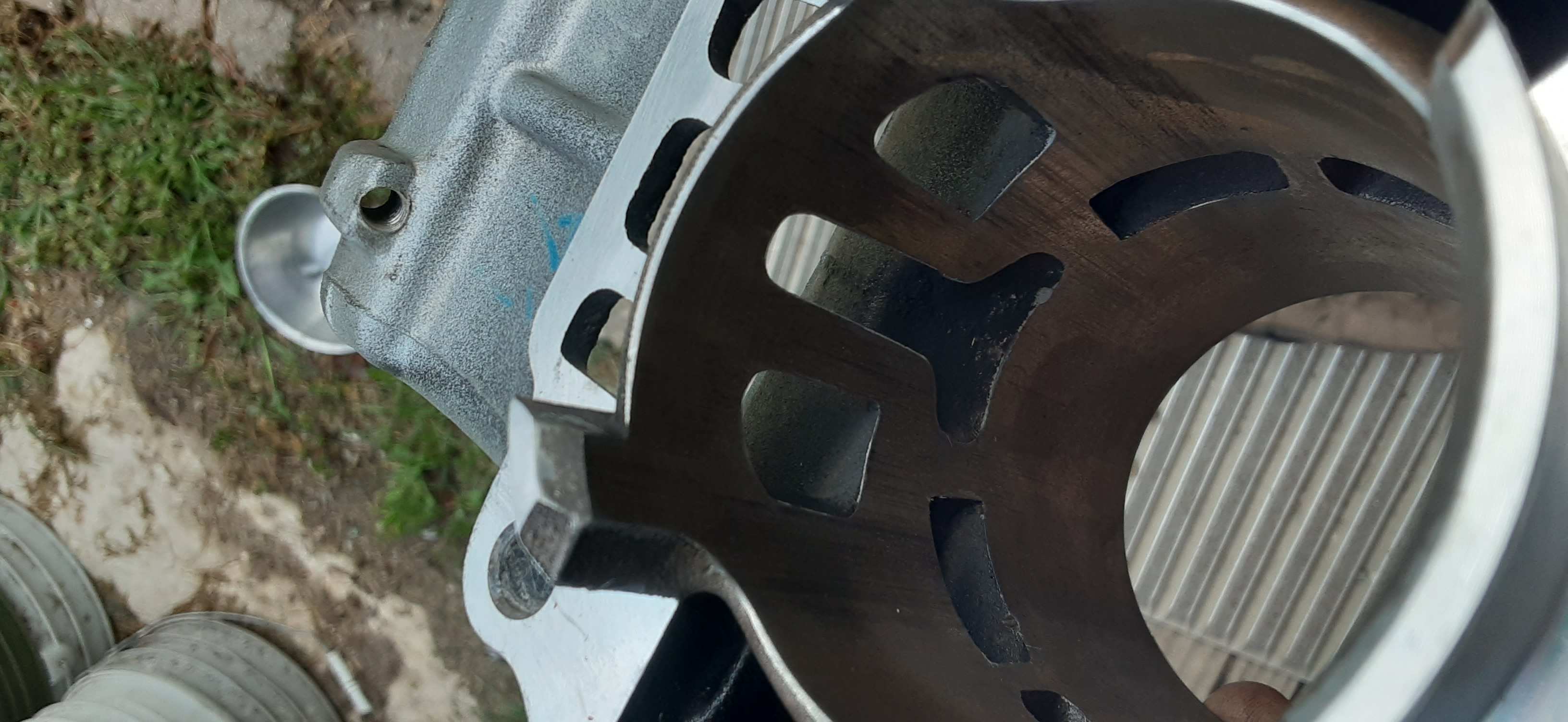

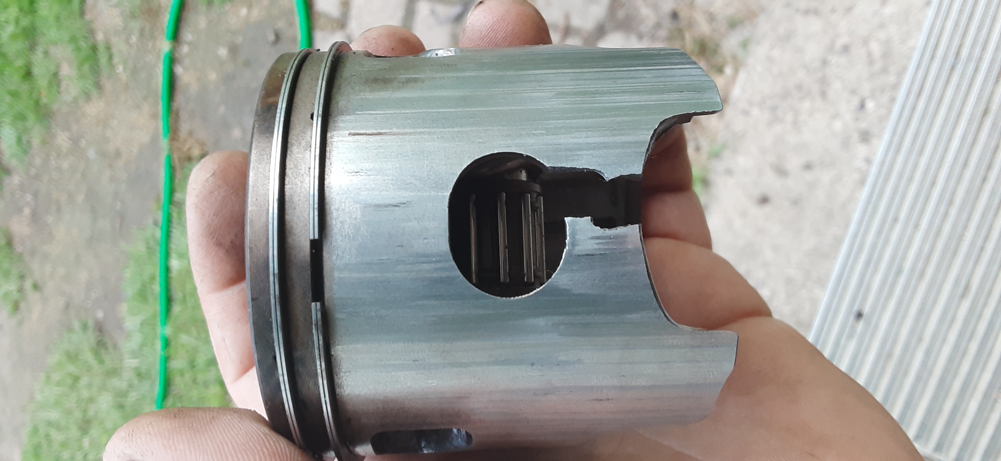

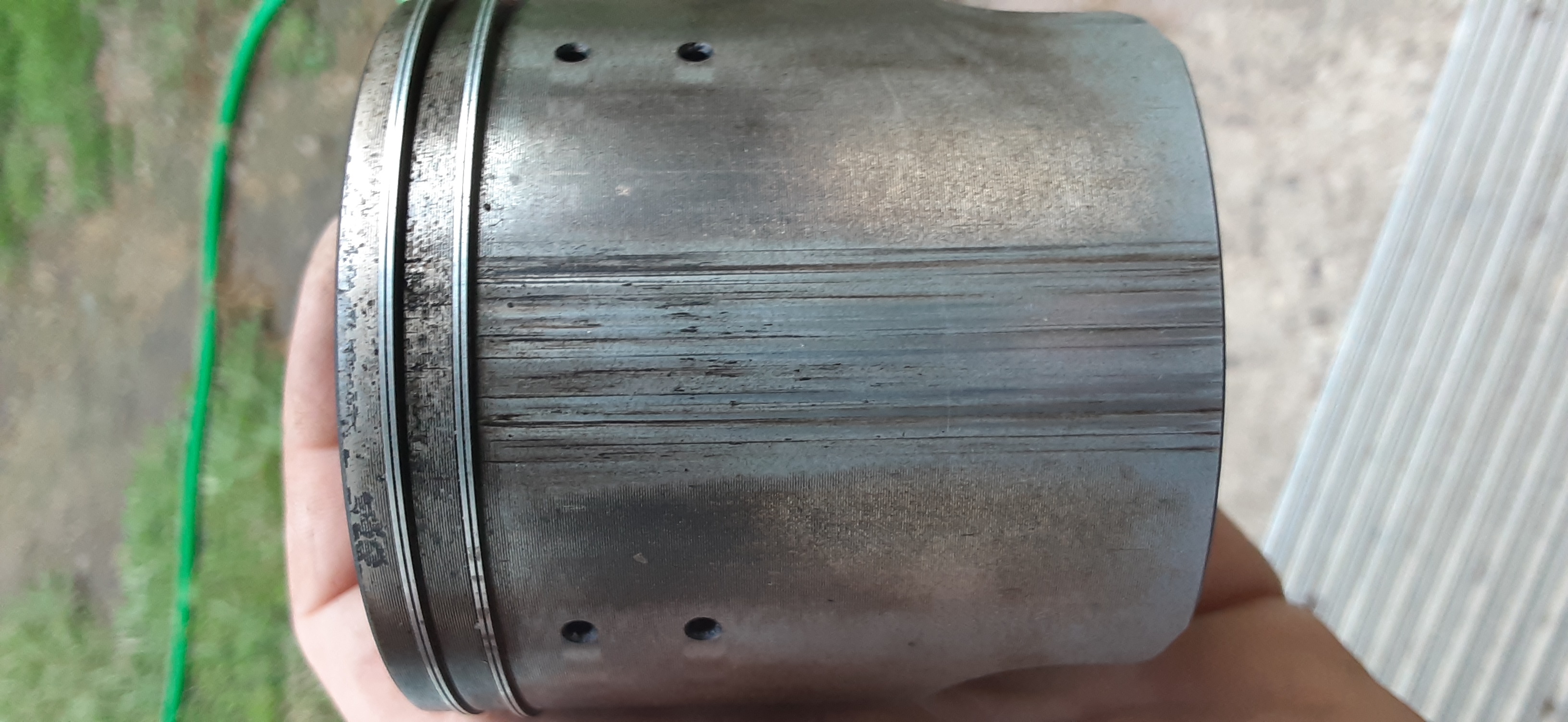

Just finished up taking off the cylinder. I'm happy I didn't run the bike at all..but have a bit of work ahead.
Piston is toasted
- 15971871944311909295117211317196.jpg (1.25 MiB) Viewed 5093 times
- 1597187211792106204132616828676.jpg (1.13 MiB) Viewed 5093 times

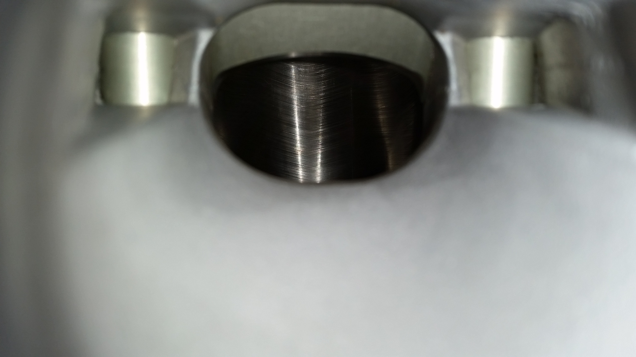

I'm definitely sending the cylinder out to be plated. Can now clearly see scoring all around and some dings

Hey, look
an OEM 220 piston...

Good job on taking it down. I would suggest rebuilding the crankshaft (connecting rod kit or parts) as well as the main bearings and seals.
It's an 18-year old stock piston. At some point, it is not the "stock pistons are bad", but "having an 18 year old piston is bad".

Man, you're lucky. If that OEM 220 piston had gone to pieces, you'd a pretty much wrecked the whole engine. Be sure you use a forged, (Wiseco) piston. Don't go back with OEM.

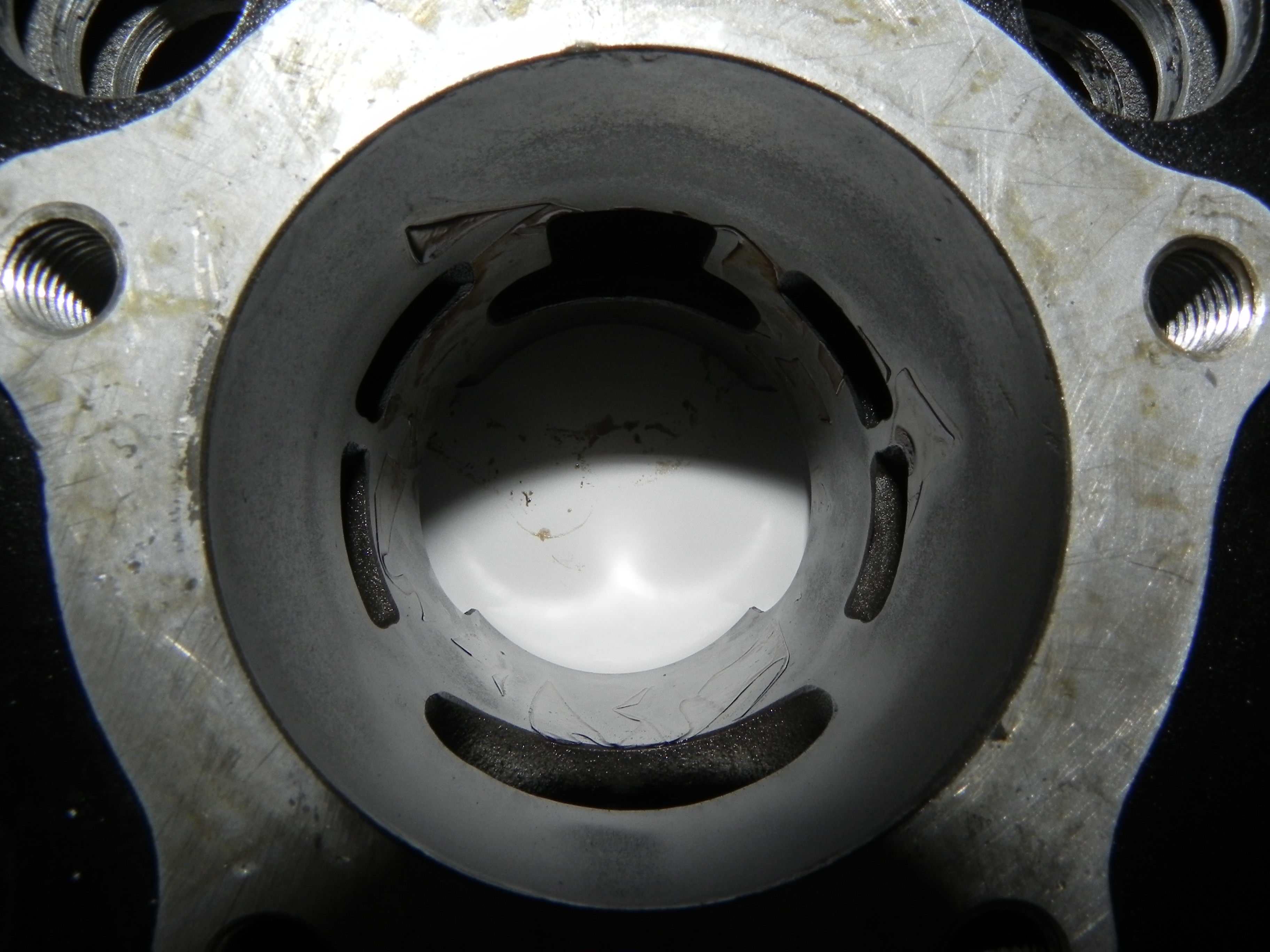

I'm wondering is this an electrofusion coating or nikasil? I've been searching around and sounds like Kawasaki switched at some point in 2003 but wondering the difference. I stopped at the local shop and the owner wanted to just ball hone the cylinder and lightly dremel the chips.

tystick82 wrote: 09:40 pm Aug 14 2020
Nicasil is the material, electrofusion is the process
Either way never hone it...the plating is very thin (like 0.001 thin) and honing will expose any damaged areas and make it worse. Once it chips it's done.
Re: New kdx220r top end inspection
Posted: 10:57 pm Aug 14 2020
Electrofusion is Kawasaki's proprietary coating name. Nikasil is a name brand from another company. The 2003 change was not on the KDX's.
DO NOT BORE OR HONE an Electrofusion cylinder (manual says so)
DO NOT run a ball hone. If you think you have port edge chips now... !!

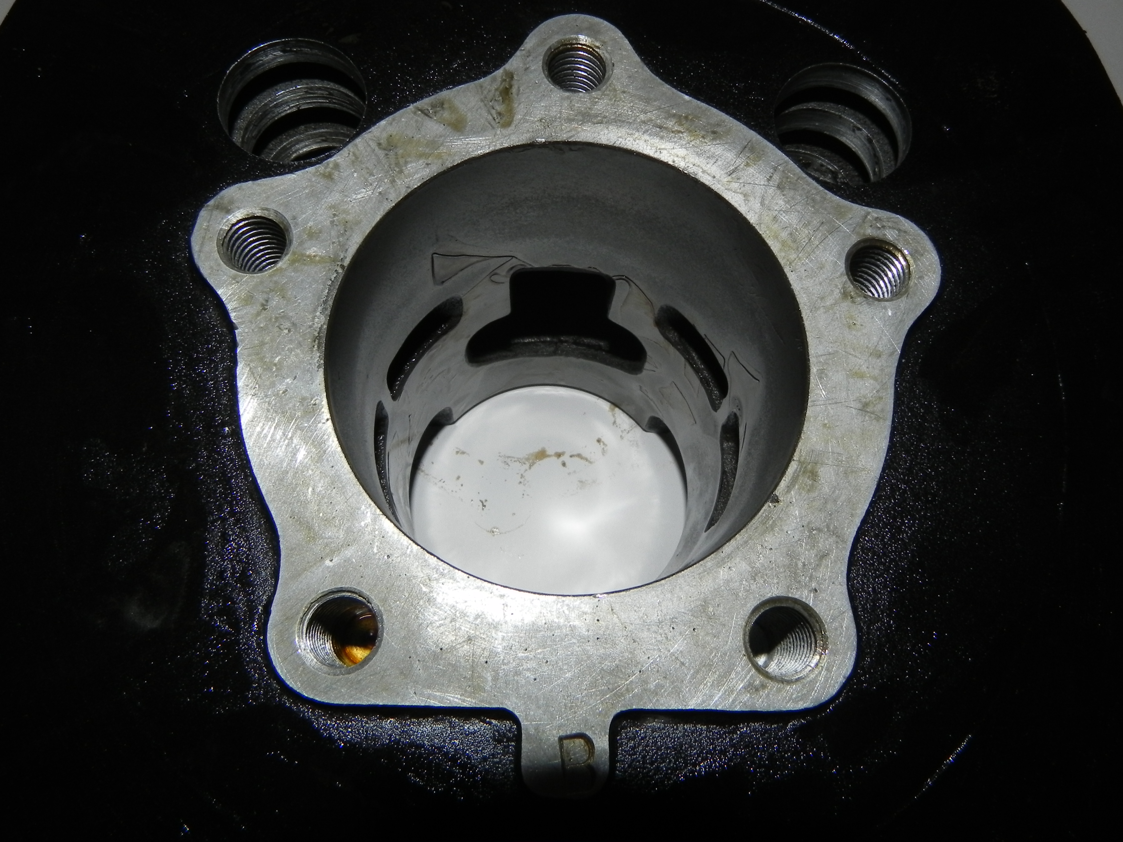

Here's a pic of the inside of my new 2005 KX250 engine's cylinder wall. Below that is a couple of pics from a new KDX175 cylinder I used to own. There is no cross-hatching on Electrofusion that gets worn off. I have a new 1989 - 1994 KDX200 cylinder in the "lime green hoard" that is smooth-walled also.
- 20170118_173319.jpg (521.74 KiB) Viewed 4895 times
- DSCN2448.JPG (3.29 MiB) Viewed 4895 times
- DSCN2446.JPG (3.53 MiB) Viewed 4895 times
