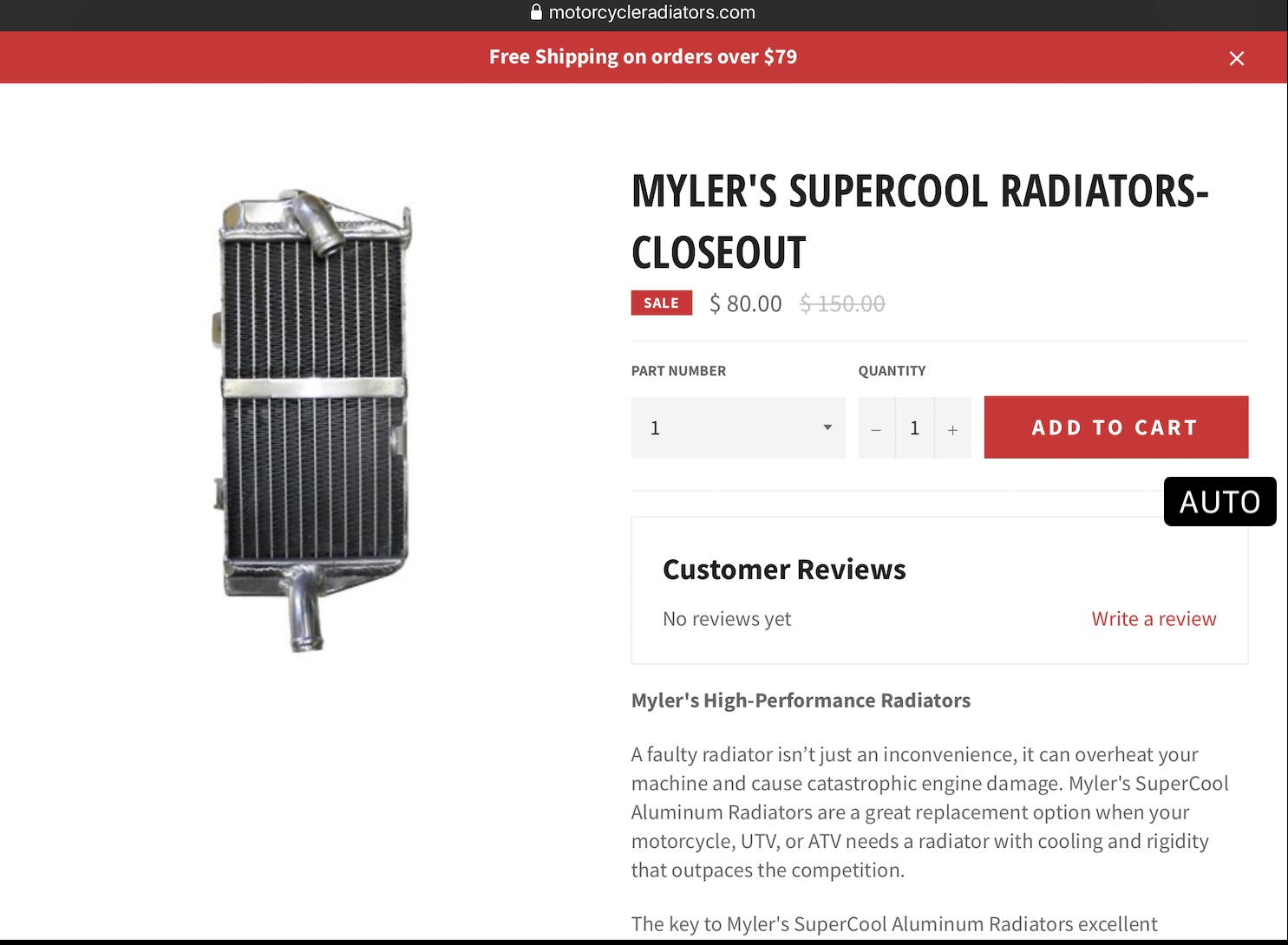

by Kdxfan4130
These guys are in the usa but Mylers motorcycleradiators dot com can rebuild your factory radiators and reinforce them to better than new. They pressure check their work, they also have a kdx200 95-06 cap side radiator for sale currently in their close out section right now. They specialize in aluminum radiators. The website has pics of the work they do, rather than buy a Chinese radiator with fewer veins check into the repair section on the site. I have oversized Mylers radiators on my Honda and have no issues boiling over.
