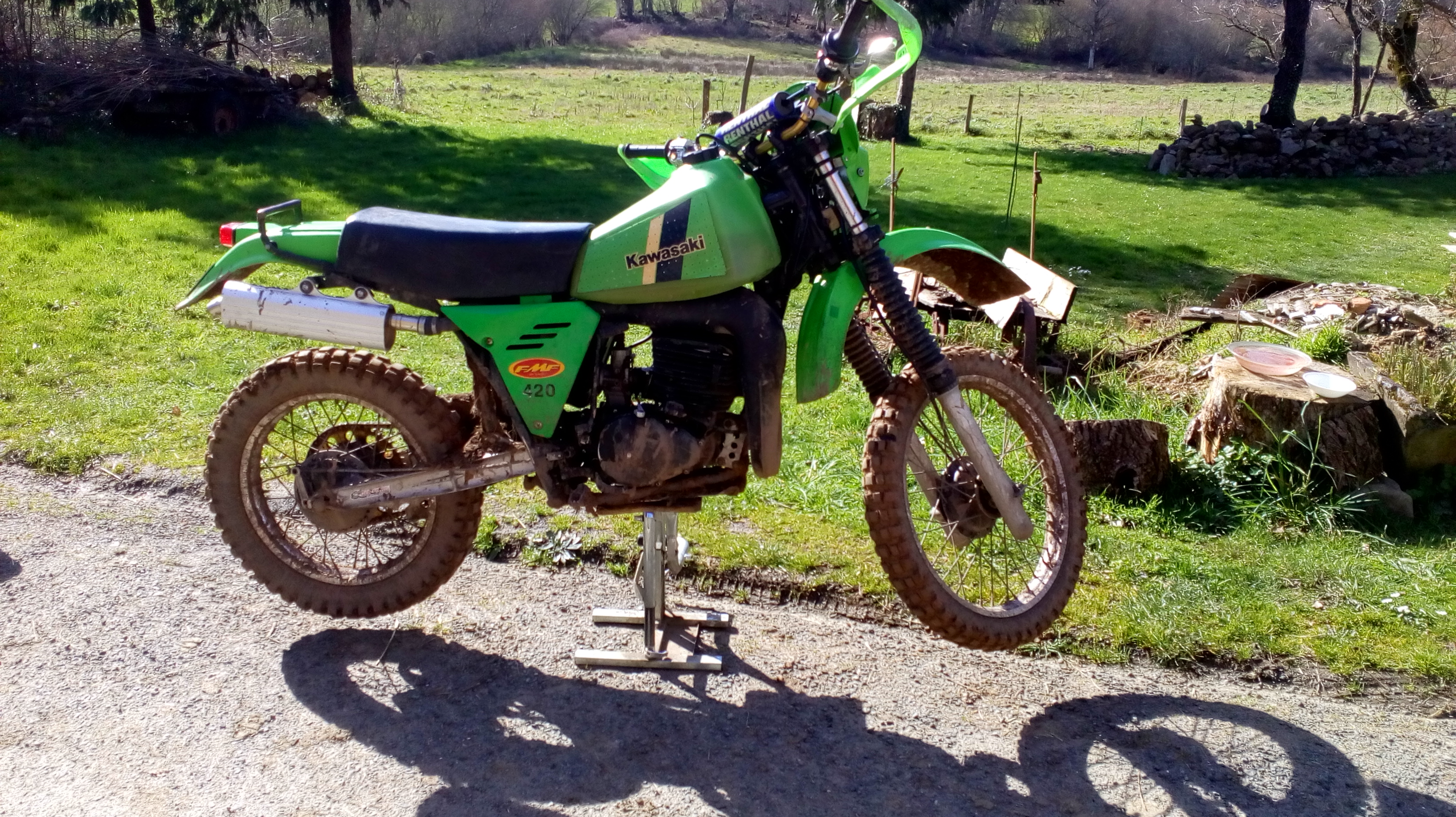

Hi
I need to replace or restore my rear shock. Have seen one for a 450 and it has a remote reservoir otherwise it looks identical to the 420 one. Does anyone know if there are other differences ?.
Thanks in advance
Ian
