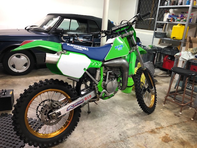

Almost period correct, give or take a year. C2 motor in a 1989 G1 KX125 chassis. The frame was modded to single down tube by using the down tube and lower cradle of an 86 KX125. It all lines up nicely.
Ti shock spring and pegs from a YZ
RMX 45mm Showas
Hand made ally tank
Now I'm fettling and trying to get it ready for it's first sandblasting on the trails :grin:
Re: 89 framed Hybrid, air cooled motor
Posted: 10:58 am Jun 13 2020
MAN! GREAT JOB! That really looks nice.
Posted: 03:02 pm Jun 13 2020
by rungrandpa
Lot's of hard work in that bike. Looks great.
Posted: 03:38 pm Jun 13 2020
by ss109
Now that's a really cool hybrid!
Posted: 05:52 pm Jun 13 2020
by kdxsully
Super nice. I see you went with silver on the motor instead of the original black.

Thanks for the feedback guys. I'll post some pics of the engine soon when it's fully assembled. I've converted it to KDX H series flywheel, ignition and CDI - so I'll let you know how that goes.
Posted: 02:02 am Jun 14 2020
by arjay200
kdxsully wrote: 05:52 pm Jun 13 2020 Super nice. I see you went with silver on the motor instead of the original black.
Yep took it back to bare metal. I'm going to get plenty of riding time on it, mainly sand, so I went for the hardest wearing/easiest to maintain finish. More the C3 look, with the seat and graphics. Also the generator cover is off an E series because of the extra flywheel depth, so silver was the only option on that part.

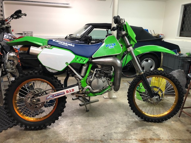

Here's some more pics. First ride was interesting. The timing was out - far too retarded, so the motor ran weakly. Weak bottom and mid, no top end. The carb was not too far off, but it was hard to tell. I've talked to a 2 stroke tuner and have got the timing in the ballpark now. I'm getting it dyno tuned next week so hopefully will get it running sweet. The suspension was great, firm but plush enough when needed. The handling was a bit funky. Stable and turned well, but too high at the back. riding downhill over drop offs (under the roots) was trying to throw me off the front :) I couldn't get myself fsar enough back not to worry. So I'll increase the sag (from 98mm to 110mm). I think the problem is that the forks are 5mm shorter from the top to the axle than the originals. Hopefully the sag will level things out.
Posted: 02:27 am Jun 26 2020
by arjay200
The other side.

Cool, let us know how the dyno tuning goes - very curious to see how the power output looks with a Lectron. There's a sales brochure on Ebay that shows the stock power graph - a bit too expensive for me to buy it, but I saved a screenshot somewhere for reference.
How do you like the Yamaha pegs? Do you know if they'll fit the 88 KDX frame too? If so, what year are they from?
Very nice looking bike. I like that your custom tank blends in and matches the rest of the bike - they often look clunky and out of place, but you nailed it! What led to you building the tank instead of using a stock one? Fitment issues?
Posted: 07:29 pm Jun 26 2020
by arjay200
Pressingonward wrote: 08:32 am Jun 26 2020 Cool, let us know how the dyno tuning goes - very curious to see how the power output looks with a Lectron. There's a sales brochure on Ebay that shows the stock power graph - a bit too expensive for me to buy it, but I saved a screenshot somewhere for reference.
The Lectron was one I had left from another bike (Husky 144). It's a 36mm. Lectron build a carb for the KDX which uses the 34mm body. I'm sure the 36 will make a good carb for the bike too.
The pegs seem fine. I had them ground flat and drilled to take the left over inserts I had for some Fastway pegs. This gave an offset and I run them in the lower position. I'm sure you could get them to fit a C frame (but it's years since I've had one of those for reference). The pegs were from an 04 YZ450F I think. I also found a cheap titanium shock spring (04 YZ125) that fits straight onto the KX/KDX shock body.
The ally tank was because nothing else would fit. I didn't want to have a rad cowl on one side like the '89 KX, and the air cooled KDX tank wouldn't fit at the back. Also it had to specifically work with the seat and side panels. If I keep this bike long term I might look into designing something a bit less like a box :shock:
