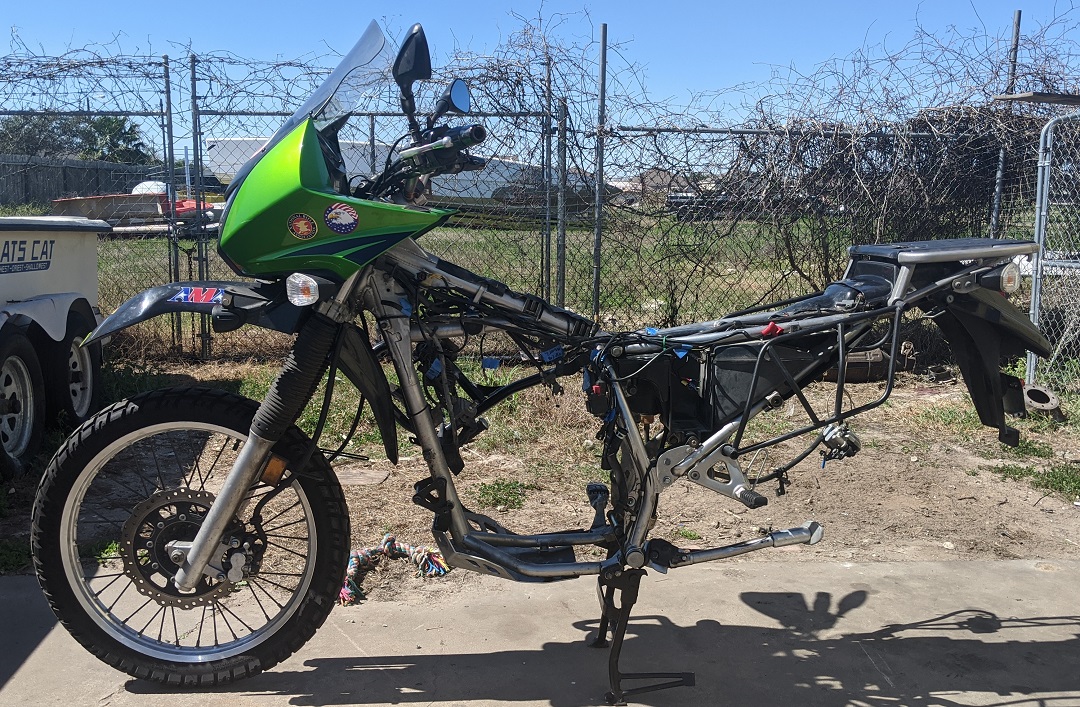

Yep, the rear suspension linkage bearings is one of the bottom of the list jobs. I just did the all the linkage bearings on my KLR. Had it all taken apart, so it seemed like a good time to do it.
KLR650
KLR650
KLR apart - Copy.jpg (499.93 KiB) Viewed 5058 times

MAN! That's a lot of air on that bike!

KDXGarage wrote: 09:09 am May 14 2020 MAN! That's a lot of air on that bike!
Ha! My friend who let me work on my bike at his shop said it reminded him of the insurance commercial where the guy is half man - half motorcycle.
I'm glad that job is over and the bike is back together.
