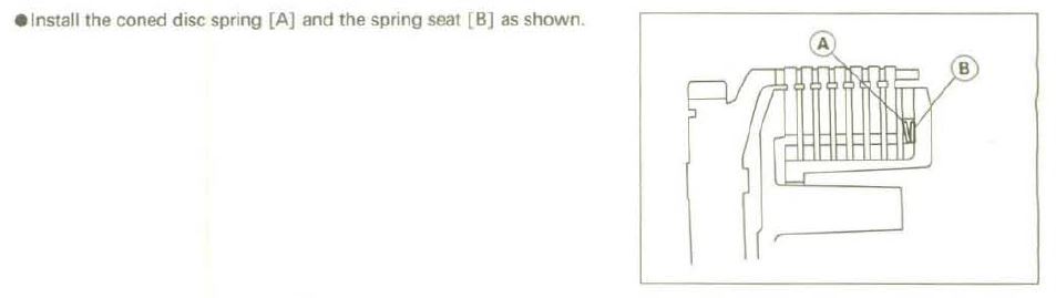

I think you're talking about what's called the "coned disc spring" in the manual. It's installed with the ID higher than the OD.
coned disk spring.JPG (24.35 KiB) Viewed 13225 times

Yep i think that is it but it still doesn't make sense to me.
(a) does the spring and spring seat go into the basket before the plates?
(b) from your explanation, the cone would if on a flat table would be pointing up?
sorry if these are dumb questions it just isnt clean to me from manual
Posts: 6256
Been thanked: 56 times
Re: clutch "jutter spring"
The judder spring should go at the very top of the clutch pack with the "cone" of it facing outward (towards the pressure plate) and the second flat spring goes on top of it.

Thanks - "top" of the clutch pack being closest to the pressure plate (so last to go on?)
ericr
Posts: 246
Joined: 06:57 pm Nov 06 2017
Location: Gig Harbor, WA
Post by ericr »
tucker wrote: 08:28 pm Apr 14 2020 Thanks - "top" of the clutch pack being closest to the pressure plate (so last to go on?)
That's correct, last to go on, pointed up, then the flat washer. BTW, there's no such thing as dumb questions here. We all started from the same point with these bikes. Good luck!

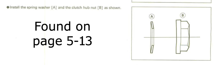

I know this is an older post but I have a question about something in the video in this post, @ 9 min mark the guy is talking about the spring washer and the nut, he says it goes on with the higher outside facing the nut, my book on 5-13 it shows it the opposite of that, which is right, I'm guessing the book because the guy didn't change the top fiction plate like the book says either. I'm currently about to get to this on my rebuild and just want confirm, thanks
03 220 w/fmf rev, RB head mod
The clutch hub nut washer goes on with the convex side facing out.

Hmm, I've always installed the washer with the convex side in IIRC. That's what the service manual shows is the correct way. Here is a screen shot of it...
conical washer.jpg (37.44 KiB) Viewed 11456 times

Thanks for confirming, to me the manual shows convex towards the nut "out" like bufftester says, interesting that people see it different ways. Looking at the clutch hub where that washer would sit if it was convex in it would rub on the inside by the shaft splines because the clutch hub has a slight concave there. Sorry I should have started a new topic with this.

DonnyV wrote: 04:43 pm Feb 04 2022 Thanks for confirming, to me the manual shows convex towards the nut "out" like bufftester says, interesting that people see it different ways. Looking at the clutch hub where that washer would sit if it was convex in it would rub on the inside by the shaft splines because the clutch hub has a slight concave there. Sorry I should have started a new topic with this.
Ugh. Yeah, I messed up my terminology. Convex vs concave. :kick:
