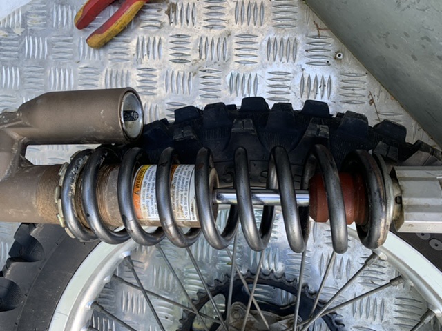

Can you post a picture?
Re: Shock spring
Posted: 09:27 pm Apr 10 2020
by tucker
Re: Shock spring
Posted: 10:33 pm Apr 10 2020
2006 KDX200? Looks stock. 5.0 Kg / mm rate in USA models.
