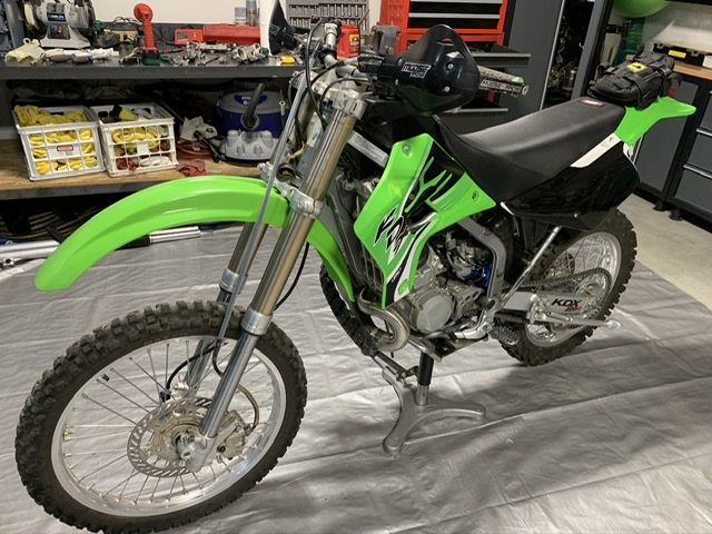

I installed 2003 KLX forks on my 2003 KDX. Everything fits except.. I bought a 1991 KX250 upper clamp, at least that is how it’s advertised (kx500 is stamped underneath)
The offset is wrong. The best I can measure, my KLX offset is 22mm (+-) The upper clamp I received is about 26mm (+-) All other dimensions are spot on. (I know for sure it’s a kx500 clamp, 43mm)
My question is, did they send the wrong part, or does the 1991 KX250 have more offset than the KLX? And if so, is there a top clamp that bolts right up?
Thanks in advance!

The Answer clamp is the one I bought, marked kx500, the hard mount is the stock klx
Re: KLX forks and KX Upper Clamp?
Posted: 08:45 pm Jan 02 2020
by Owyhee1

No worries kdxgarage, I think it’s the 91 KDX250 upper mount
