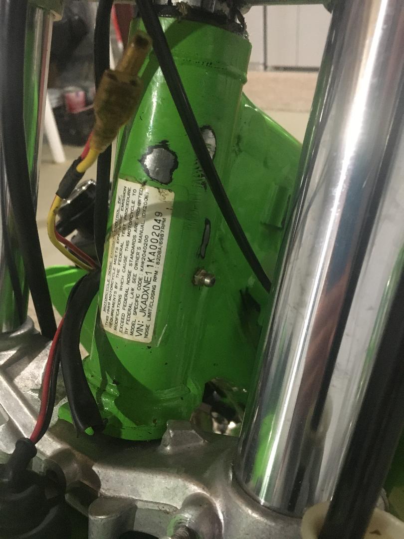

How did you put a grease fitting on the steering bearings?? I can't see that as possible.

Grease fitting is drilled into the left side of the steering head about halfway between the upper and lower bearings. Now you would think all the grease would ooze out of the lower bearing and not reach the top (I know I did), but that's not the case. My best guess is the lower bearing creates a better seal since it's pressed onto the stem and that only a little grease gets by the bearing and oil seal. Anytime grease is pumped into the stem I have to wipe off more from around the locknut under the upper triple clamp than the lower clamp. It defies the laws of physics!!

OK. Well, that's different!

There must be a whole tube of grease packed in there. I hear it’s difficult to get those steering head bearings packed really good
