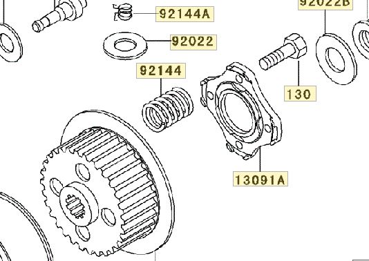

1) I got the new clutch / springs installed and have yet to torque the clutch hub nut to 65 LBS. Does anyone have a do it yourself hack to hold the flywheel? Service manual part # for that tool is nearly $300. I tried a large rubber belt type oil filter wrench and it wont hold it.

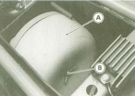

2) The attached pic: I stuck the red plug on the open nipple for now. Nothing was attached and I cant seem to find a diagram that says what it is. I am assuming its the trans case breather? What should go there? A hose dumping to the ground?

2. p/n 92190-1007 tube, about 30$, or any rubber hose the correct diameter to fit, run it up to the airbox, theres a hole near the top it passes through

1. There's a couple ways to tighten the clutch nut. I remove the clutch spring holder (pn 13091A in the image) and then put fender washers on the clutch spring bolts. Just snug them down on the springs and you'll lock up the clutch. I then put a penny between the clutch gear and the crank gear and torque away. Another way is to use a piston lock up tool that threads into the spark plug hole. I use this when working with the flywheel.

2. The transmission breather has a rubber hose leading to a hole in the airbox. In the photo below, you can see the location of the hose above the air filter.

For holding the flywheel, a Vice Grip #20R chain pliers / clamp is my go to tool. This is very useful for holding large diameter or odd shaped parts.
Using a holder like this avoids putting all the load on just one gear tooth.

Hose definitely goes up into the airbox on 1986 and newer.

You don't need to buy or use a piston lock up tool.
Just feed a length of nylon rope through the spark plug hole and use that. Just be sure the piston is high enough up in the stroke first so all the ports are covered. You don't want that rope to get pinched by the piston in a port.
That said, I still prefer a flywheel holding tool like a Vice Grip chain pliers.
