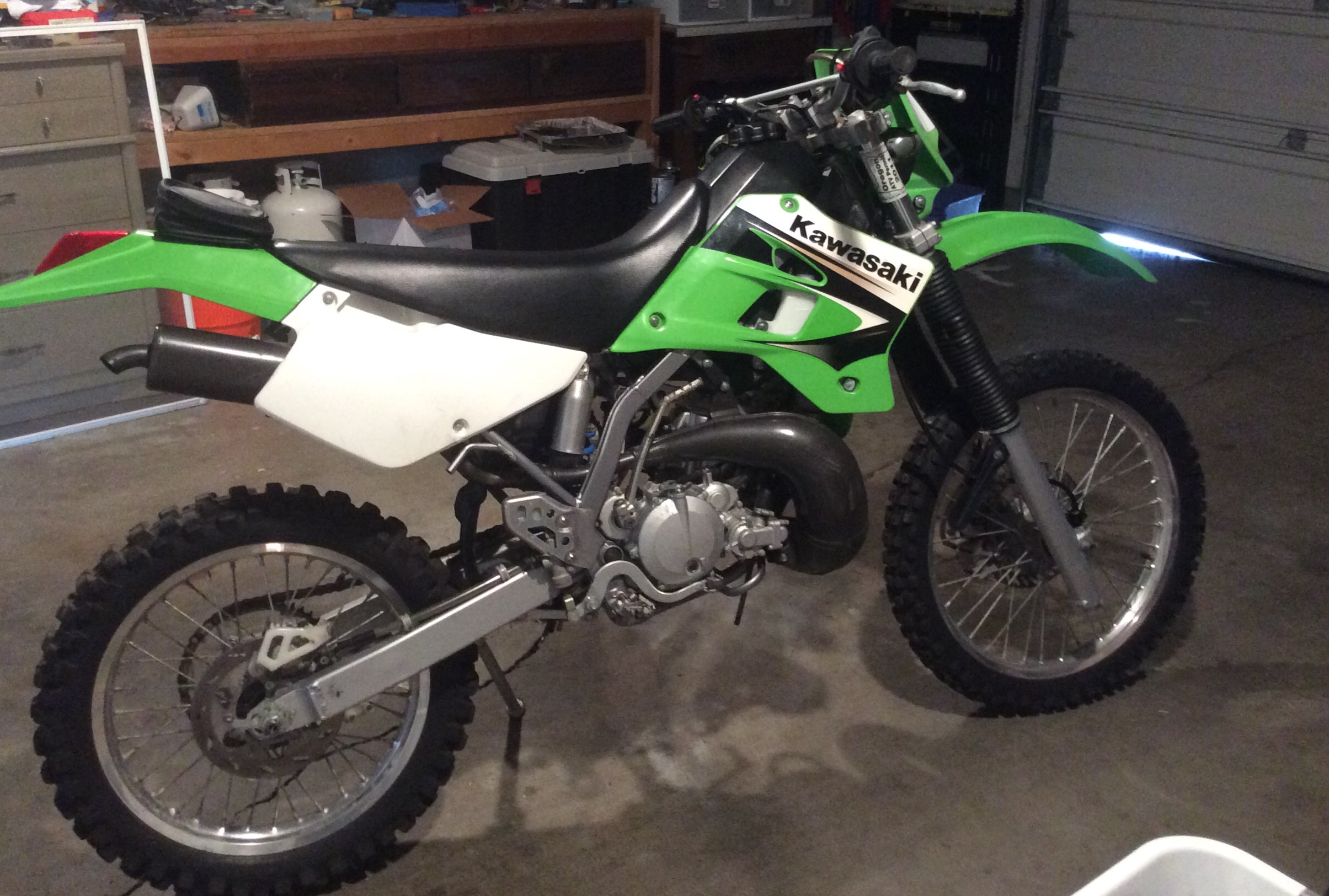

In true mid life crisis style I just bought a dirt bike. 2003 KDX 200. I’m 49 and haven’t owned a dirt bike in over 30 years. My last bike was a 84 CR250. I rode trails mainly and raced a few seasons at the Woodland Wa track. Someone had to place 16th! :grin:
The bike seems pretty clean and doesn’t seem to be modified from stock in any way. Even the grips appear original. Tires are in great shape but suited for hard terrain. Dunlop D739 front and rear.
After searching the forum a while I answered most of my questions, but I couldn’t figure out of the KDX came stock with a spark arrestor.
I plan on adding handguards and maybe buying tires along with riding gear. Bars seem bent and sweep back too much for my taste. I just want to get it ready to ride and then figure out what I need/want. No reason to spend $800 on aftermarket parts to just find out I’m not into it.
Any advice will be appreciated. About the spark arrestor, tire choices for the NW and handlebar options.
Oh and I won’t be riding for a few months. I just had my hip replaced. “Midlife crisis time.
So I have plenty of time to get it ready.

I just answered my spark arrestor question. My detective skills led me to actually look at it. Shocker.. it says right on it that’s it a spark arrestor. IM THE GREATEST DETECTIVE IN THE WORLD.
as for tires. I hear good things about the Shinko 216 fatty front and 525 cheater for the rear. I might ride it a bit and just see how the Dunlop’s 739s act.
As for the bars. It looks like the clamp on the left is bent back a bit. It’s not the bars. Hopefully I can live with it and won’t need to replace a clamp. Or worse.

Welcome to kdxrider.net to both of you! Congratulations on the KDX.
Apparently, it is Klean KDX Week here at kdxrider.net. I think that is the third one in a row on introductions that looks really nice!
HA HA! Yes. It is the stock pipe and spark arrestor. Nice and quiet!
Search for threads on handlebar clamps twisting (or handlebars twisted in clamps). It may not be damaged, just out of alignment.
Good luck on healing up most of all, then on getting the KDX to your liking. A KDX is a whole lot cheaper than a Corvette!

That's a great find! Amazing how many nice KDX's are still around.

Dude your not kidding!!! Wth is going on? Everyone in the US decide to sell their closet-kept KDX's in August?
Thats a great looking bike! You are super lucky to have found one in pristine condition. A keeper for sure.

Beautiful bike! Looks like it was barely ridden.
The KDX will be a great bike for you to hop on and just ride. Upgrade the bars to 1-1/8" (you'll need universal adaptors), new grips, tires, hand guards, and new tires and you are good to go! I am still running the stock tires on mine haha, but I am going to try the Kenda Trackmasters II's next or the Shinko's as you stated. I like Golden Tyres but they are expensive. You'll have to jet for your area, but other than that the bike is plug and play right out of the box. It is the bike part of the KDX, you can just kick it over and ride. Good luck and enjoy!

Could be the bars, but more likely the clamps are just twisted in the rubber mounts. Loosen or remove both nuts holding the bar clamps (bottom of the TOP triple tree clamp) and see if you can simply "wiggle" them straight again. Then retighten the nuts that hold the clamps to the top triple tree. I had to do this nearly every time I fell (which was a lot). I replaced the old rubber cones with new red rubber "hard" cones. First fall they were twisted again and I was running around the gas stop at an enduro trying to find someone with the right size socket wrench. Now I've replaced them with aluminum cones. Haven't ridden with those yet.

Look into a solid top piece for the handlebar clamps. KX's had them YEARS ago. FRP used to make a beautiful top clamp.
