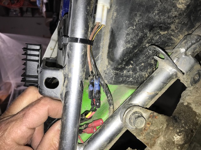

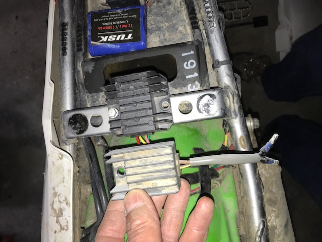

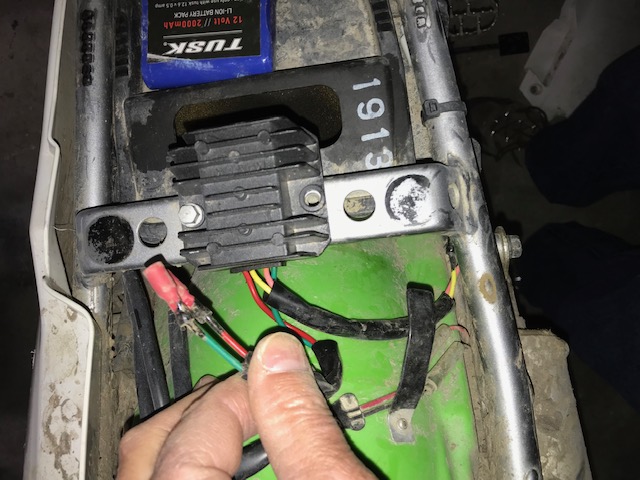

I finally got a chance to pull the bike out of the garage and look at what I did for the rectifier. Sorry for the delay... Per your suggestion that I add some detail to help others in the future, here goes:
So pic number one shows the stock rectifier that I pulled out next to the one I noted in a previous post. Note that the new one has two bolt holes instead of the original's one bolt hole. Interestingly, the extra bolt hole lines up perfectly with an existing bolt hole that the KDX already had. Makes me curious as to why that hole was on the frame and why this rectifier would bolt up to it. Maybe there is a "rectifier standard" out there where they are all dimensionally the same...
The next pic shows the wires I used and the ones that I capped off as the rectifier comes with 4 wires and the KDX only uses 2.
The last pic shows the rectifier connected to the KDX wires. Yellow rectifier wire to brown KDX wire, and pink rectifier wire to black with yellow stripe KDX wire. (Sorry the pic is sideways, anyone know a fix?)
That is it although it took a while to figure it all out as the instruction that came with the rectifier kinda sucked. I have not had more than maybe 16 hours on the bike since I installed the dualsport Tusk light kit and this separate LED headlight set up. I did run the headlight through the Tusk headlight controller (which does not tie in with the rest of the dualsport Tusk kit which runs off a battery-driven-only circuit) and now I have hi/low beams when the engine is running. So far the only issue was when the headlight bulb popped out during a ride but that just screwed right back in to the housing. As I mentioned previously, the light is incredibly bright and the low draw of the LED headlight means I did not have to rewind the stator. The only other issue has been the battery won't hold a charge now and I purchased it last July and only really used it for the 16 hours I mentioned. It wasn't actually in use for any of those 16 hours either as I did not need the tail light, brake light, horn or turn signals that the battery is used for. So not impressed with the Tusk battery. I have another on order with RMATV and it cost around $30.
So that's it. Let me know if anyone has any questions or needs any clarifications on how I did any of this.

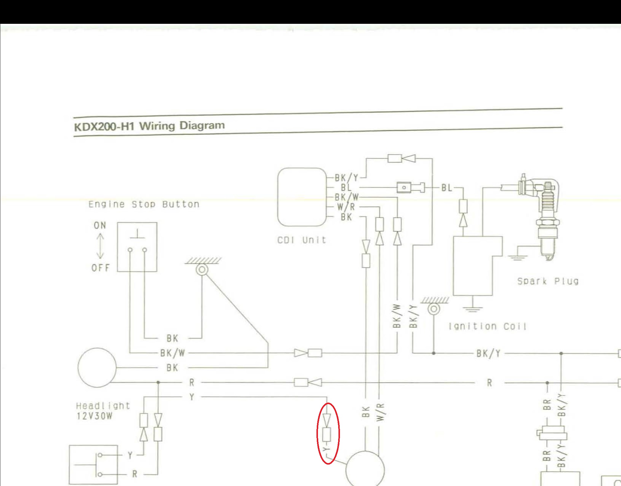

I'm interested in doing this too, but don't know how it can work based upon how you have it wired. This rectifier has 4 wires - 2 for AC power and ground from the stator, and 2 for DC out and ground. You removed the stock voltage regulator and replaced it with the rectifier and capped off the DC out.
The proper way to wire this is to disconnect the yellow stator wire and connect it to the yellow wire on the rectifier. Since the stator is internally grounded, you can connect the pink to ground. Connect red to the lighting circuit and green to ground. The Amazon listing says that this rectifier must be used with a battery to regulate voltage. I would wire a capacitor instead.
Here's the wiring diagram that shows the yellow stator wire that would connect to a rectifier. Edit: Or even easier, if all you want is the headlight, just cut the black and red wires right at the headlight and splice the rectifier in. Splice in a capacitor on the DC wires to replace a battery.
