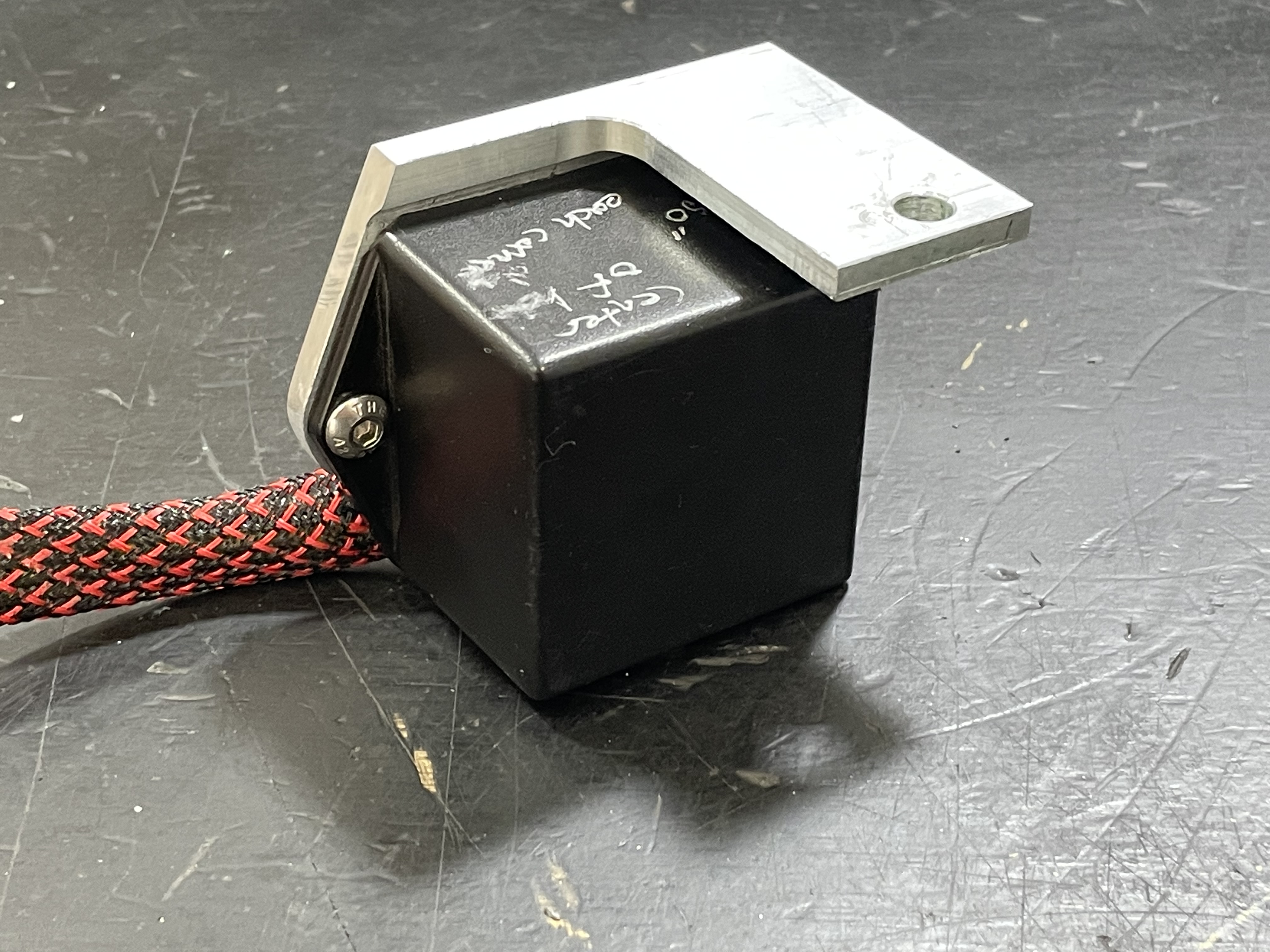

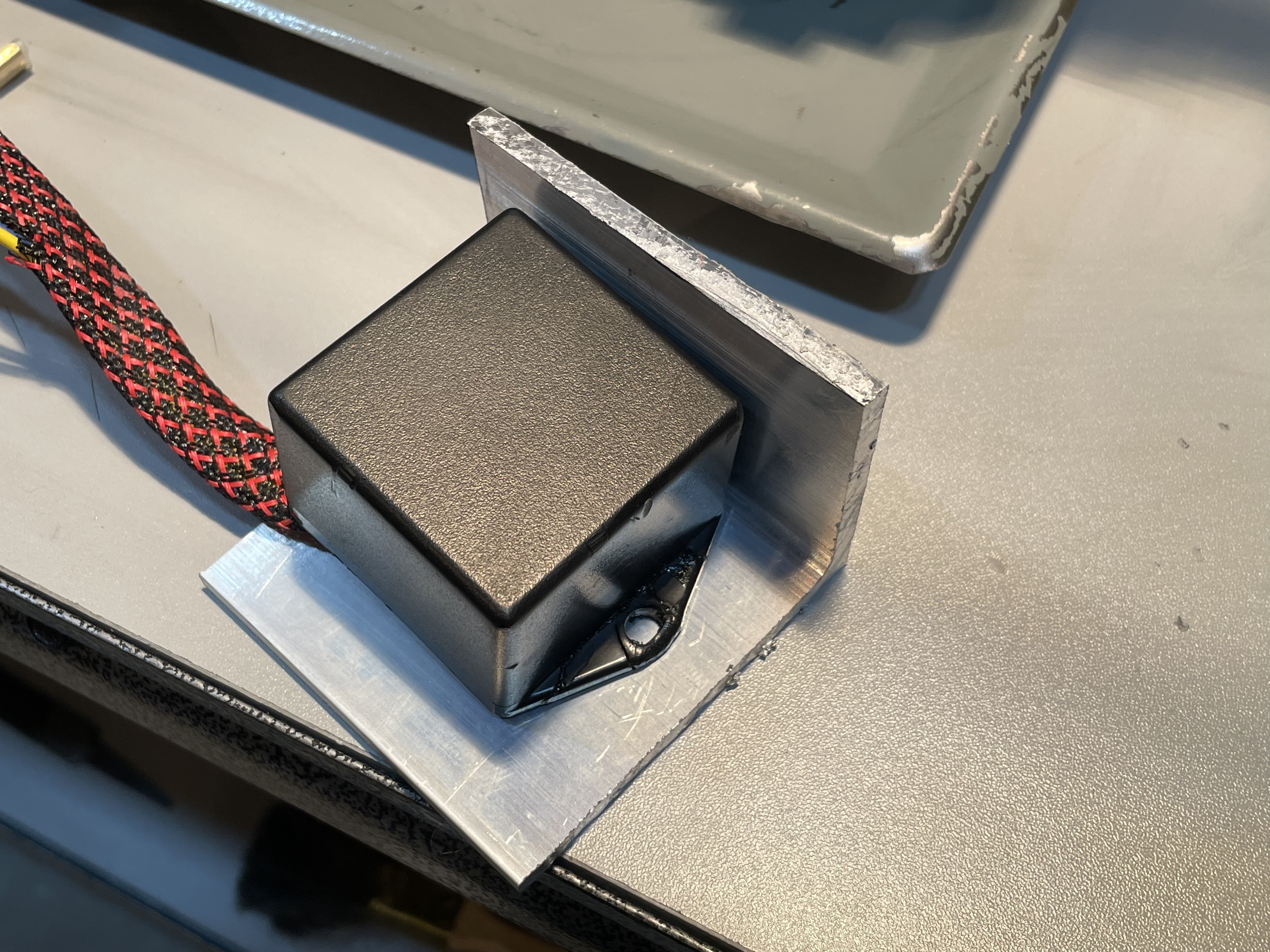

Decided to finally get after making a proper mount for this thing! I thought long about where to mount it, since I run my air box lidless, the stock CDI was located on the front of the box by the shock. There is a good chunk of space up there. I didn’t want to mount it there for a couple reasons, namely I wanted it hidden away for that OEM look. I decided to mount it at the rear of the airbox, near the voltage regulator. There is already a spare bolt hole on the frame that can be used. This required clearancing the airbox, so I removed it, trimmed along the casting line, and reinstalled. Yes, I know the air filter is dirty. This adjustable unit is quite a bit larger than stock, not a knock on it at all, I know the components are skookum, just need to be creative on where to mount it.
Now to fab up a bracket. Had some 3” aluminum L, looks like it’ll work.

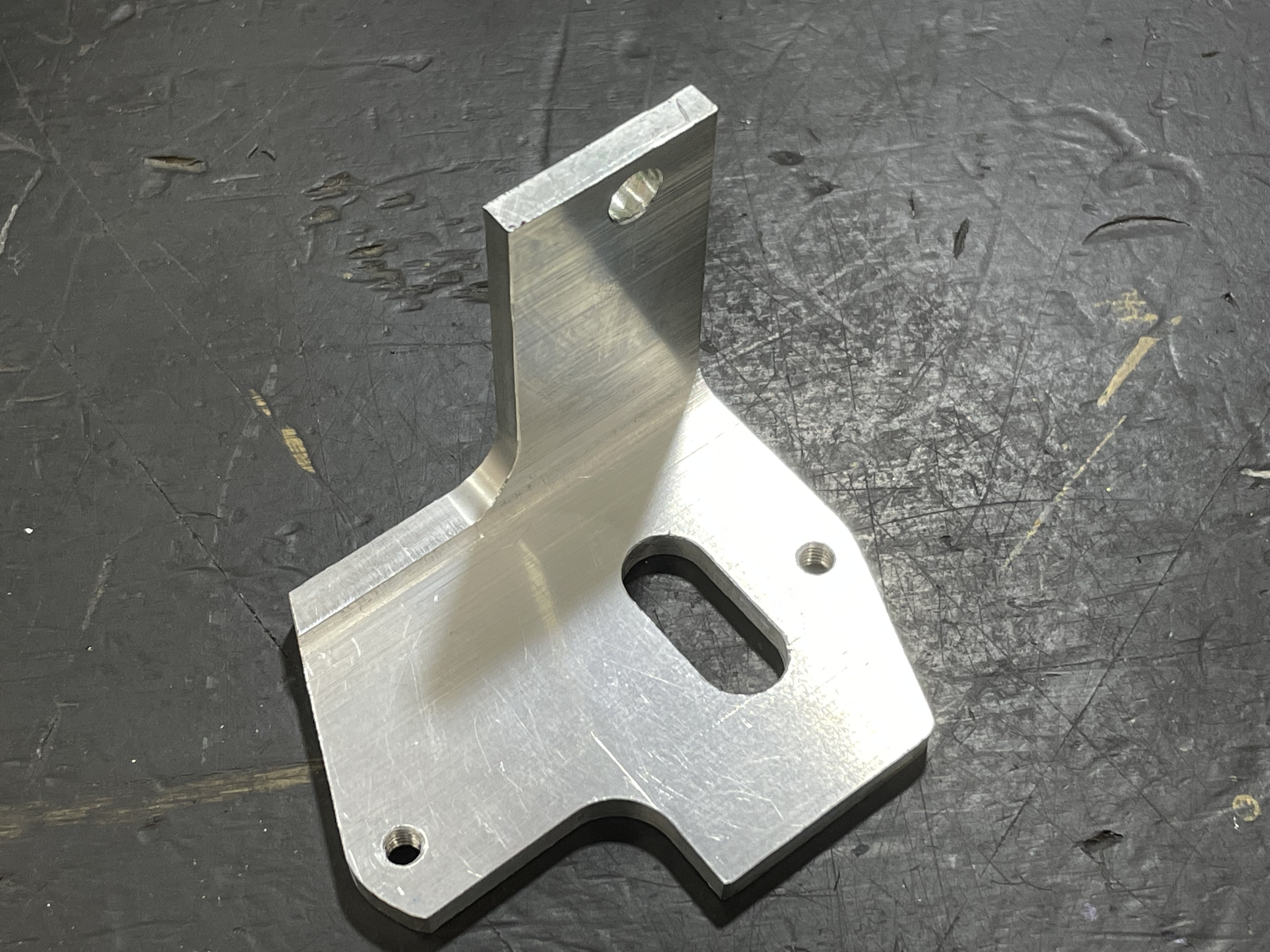

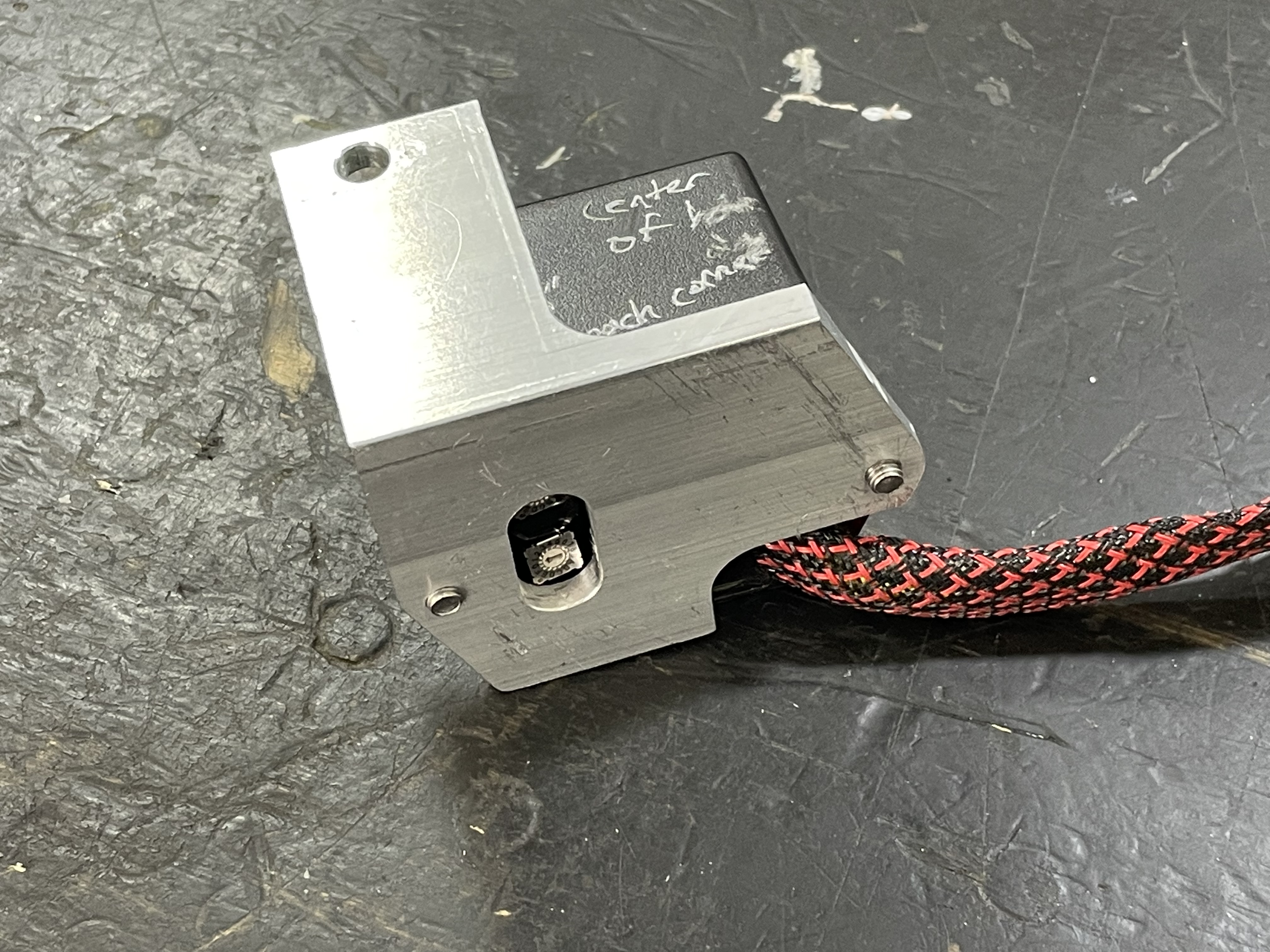

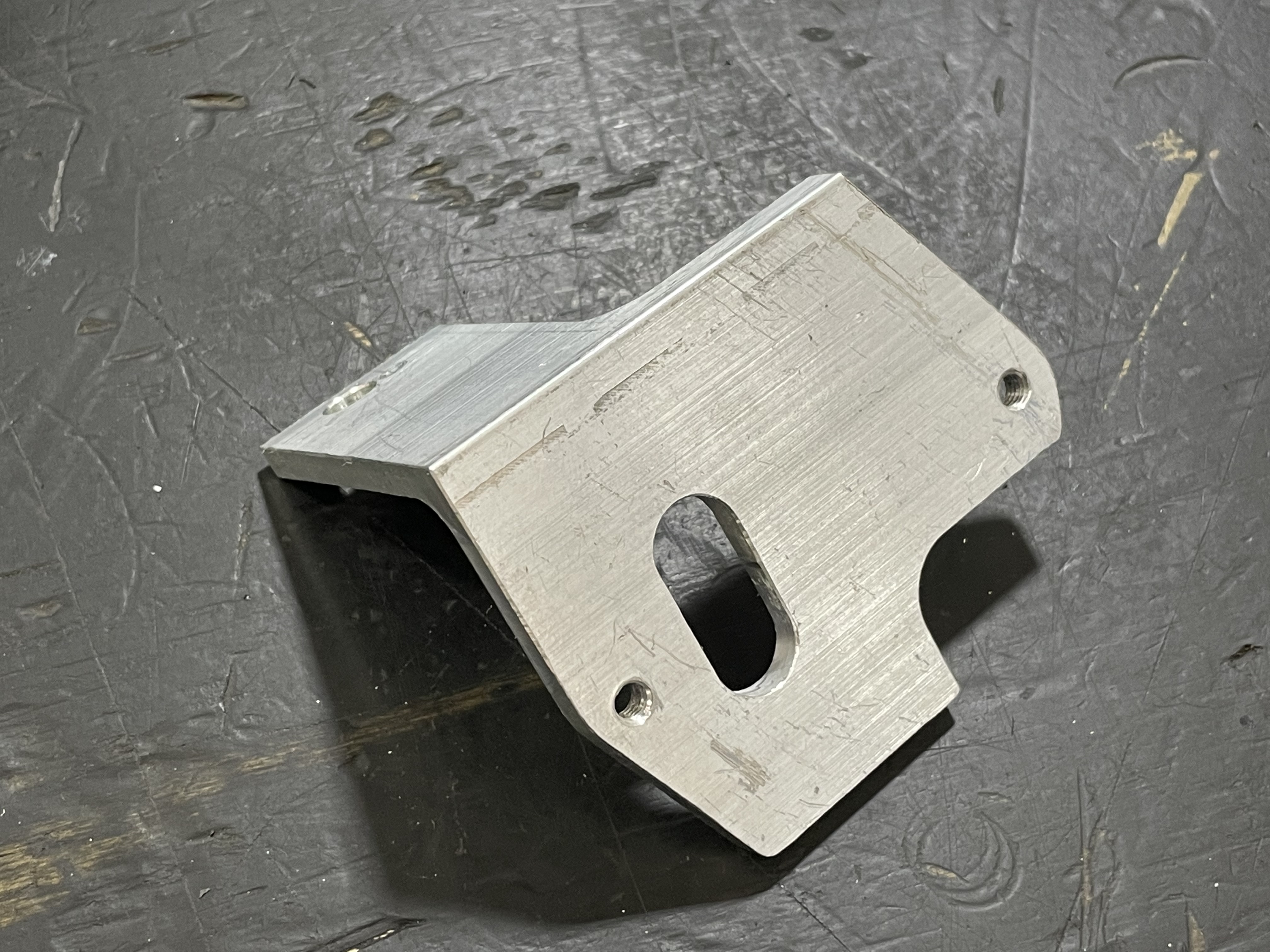

Spent some time on the mill, drilled and tapped some mounting holes, and about two hours later, voila!
Posted: 10:39 pm Oct 14 2022
by Slick_Nick
I can’t just leave it bare aluminum like that, so decided to prep and anodize it black. I used some letter punches to mark which adjustment dial is high or low, then hit it on the scotchbrite wheel. Turned out alright, I didn’t spend too much time on it, it’s just a bracket that’s hidden away anyways. Stainless mounting hardware, with lock washers because of the vibration.
