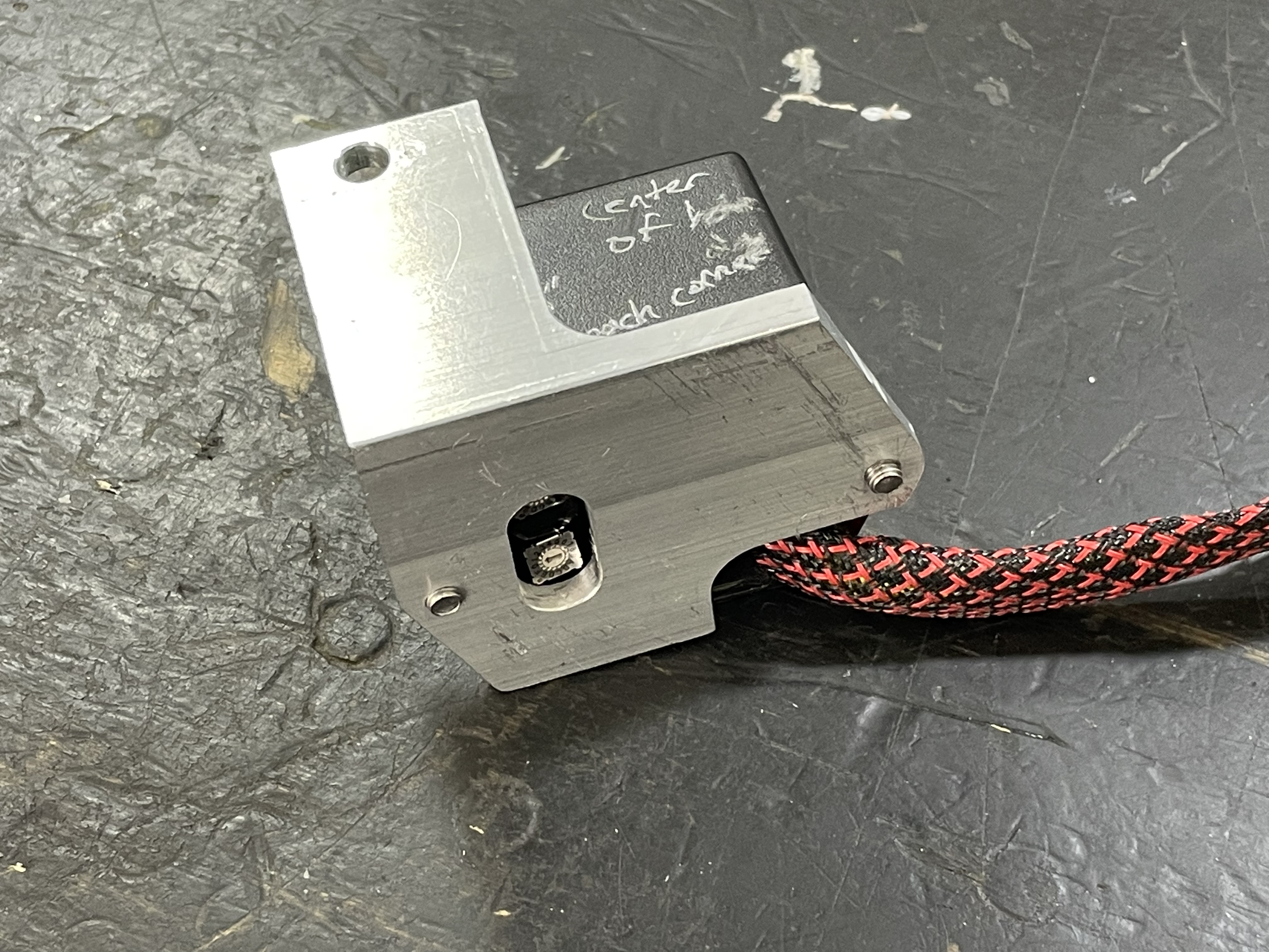

I had it temporarily mounted to just above the airbox, while I left the stock CDI in place, so I could ride both back to back. Unfortunately, the force of the jump landings caused the one side mounting tab to break off, so I'm going to mill an aluminum mounting bracket for a more permanent solution now that I can remove the stock CDI permanently.

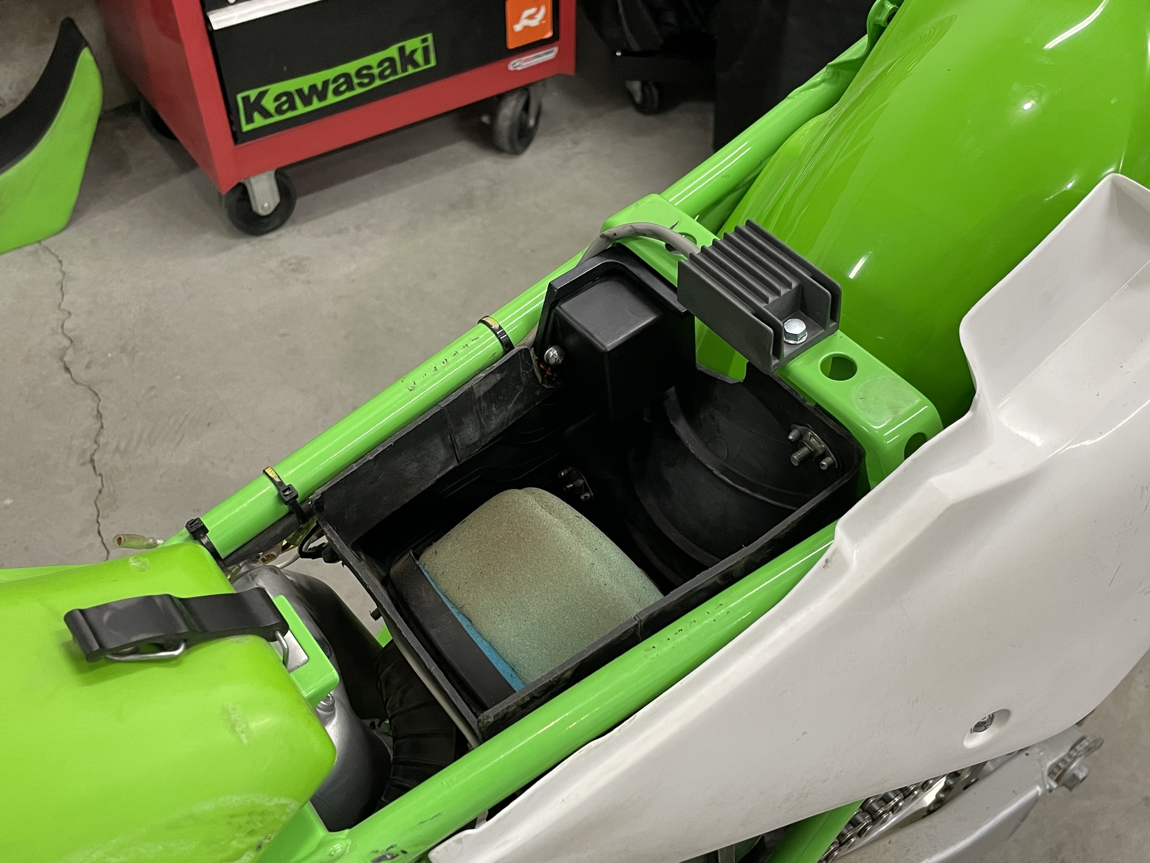

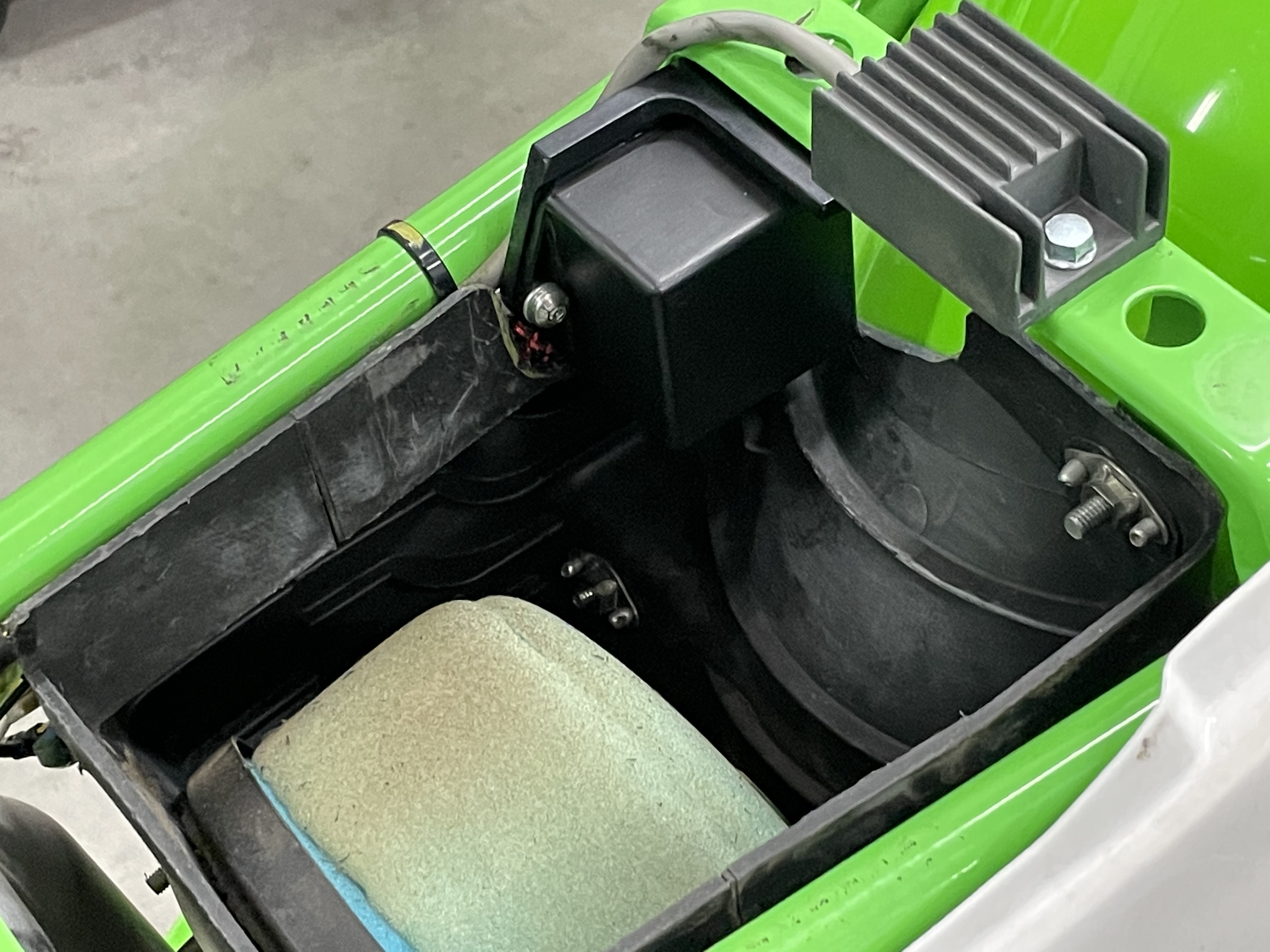

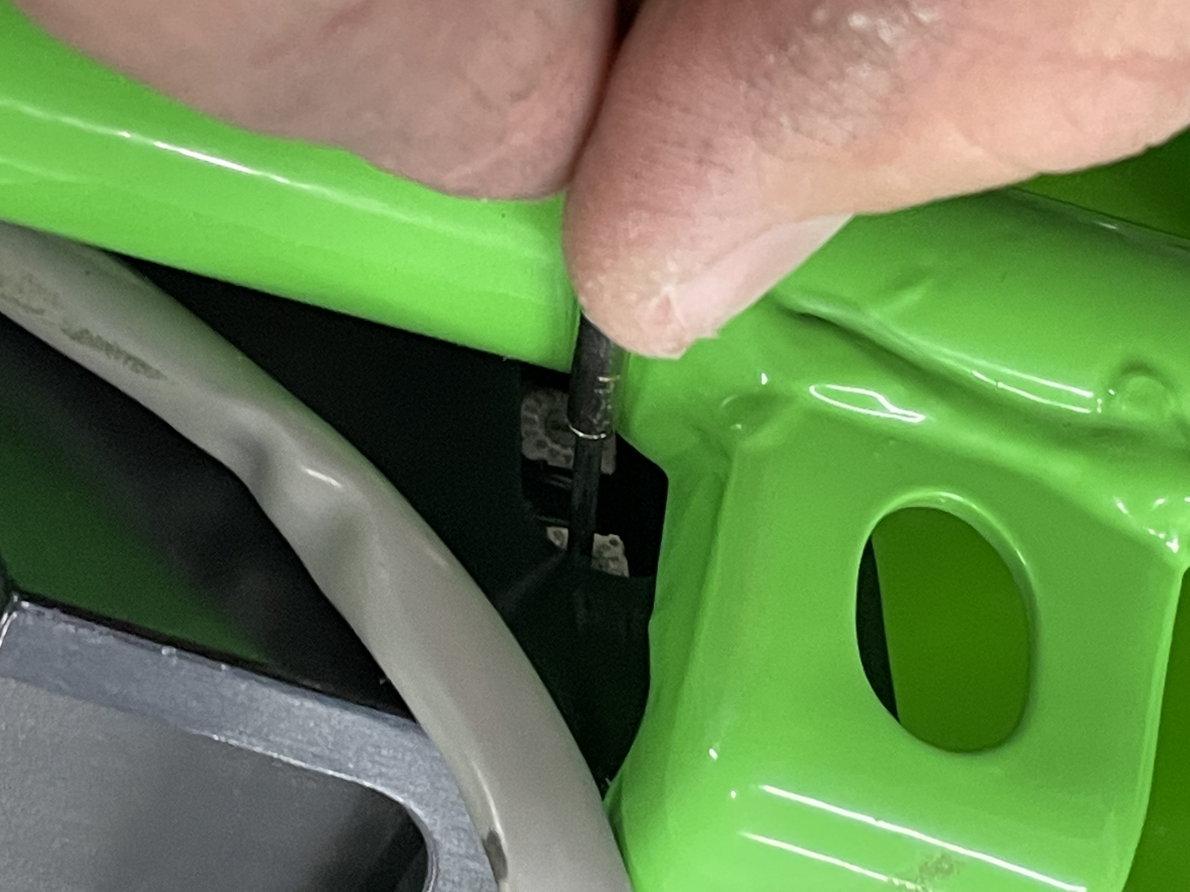

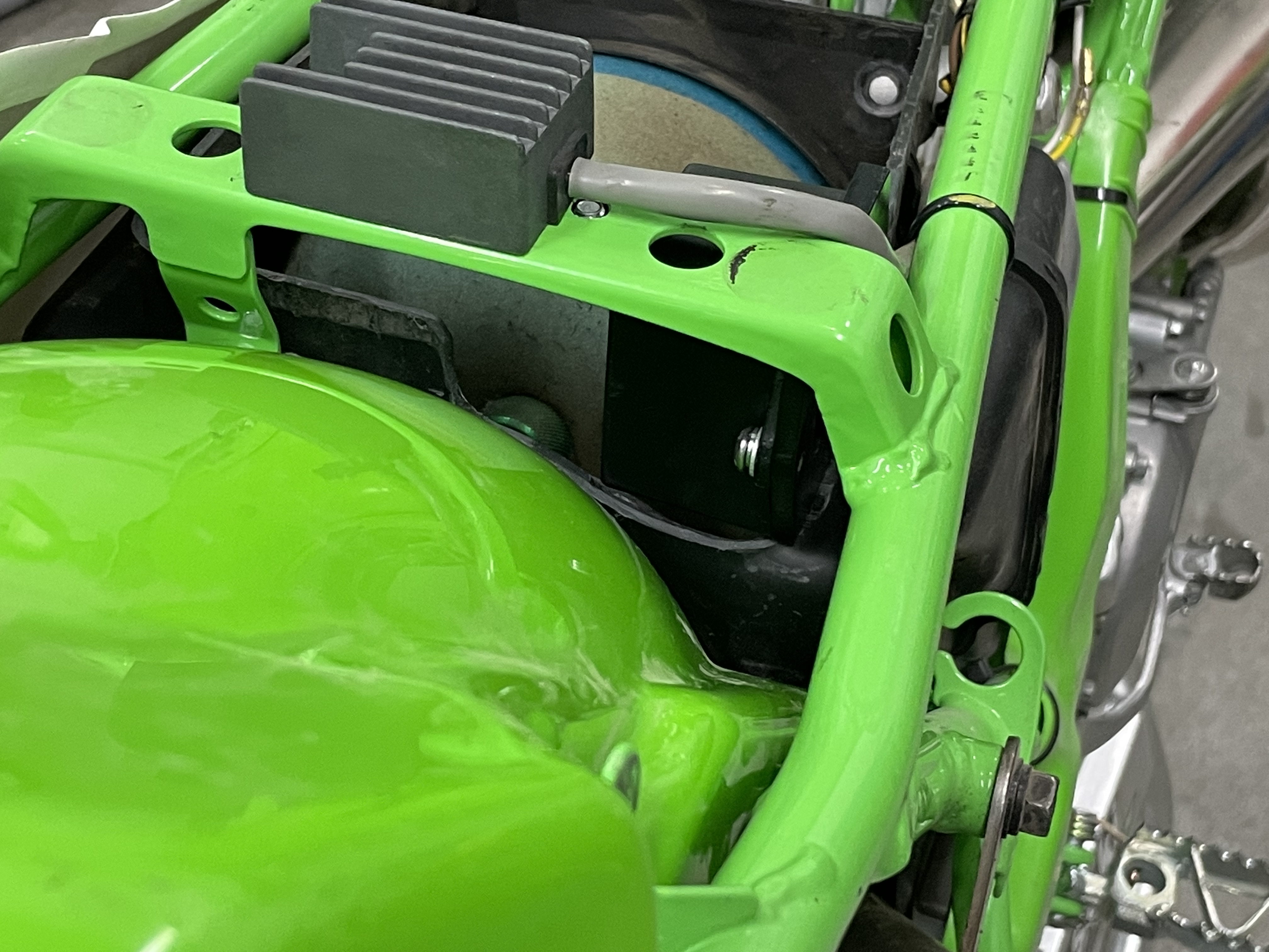

Decided to finally get after making a proper mount for this thing! I thought long about where to mount it, since I run my air box lidless, the stock CDI was located on the front of the box by the shock. There is a good chunk of space up there. I didn’t want to mount it there for a couple reasons, namely I wanted it hidden away for that OEM look. I decided to mount it at the rear of the airbox, near the voltage regulator. There is already a spare bolt hole on the frame that can be used. This required clearancing the airbox, so I removed it, trimmed along the casting line, and reinstalled. Yes, I know the air filter is dirty. This adjustable unit is quite a bit larger than stock, not a knock on it at all, I know the components are skookum, just need to be creative on where to mount it.

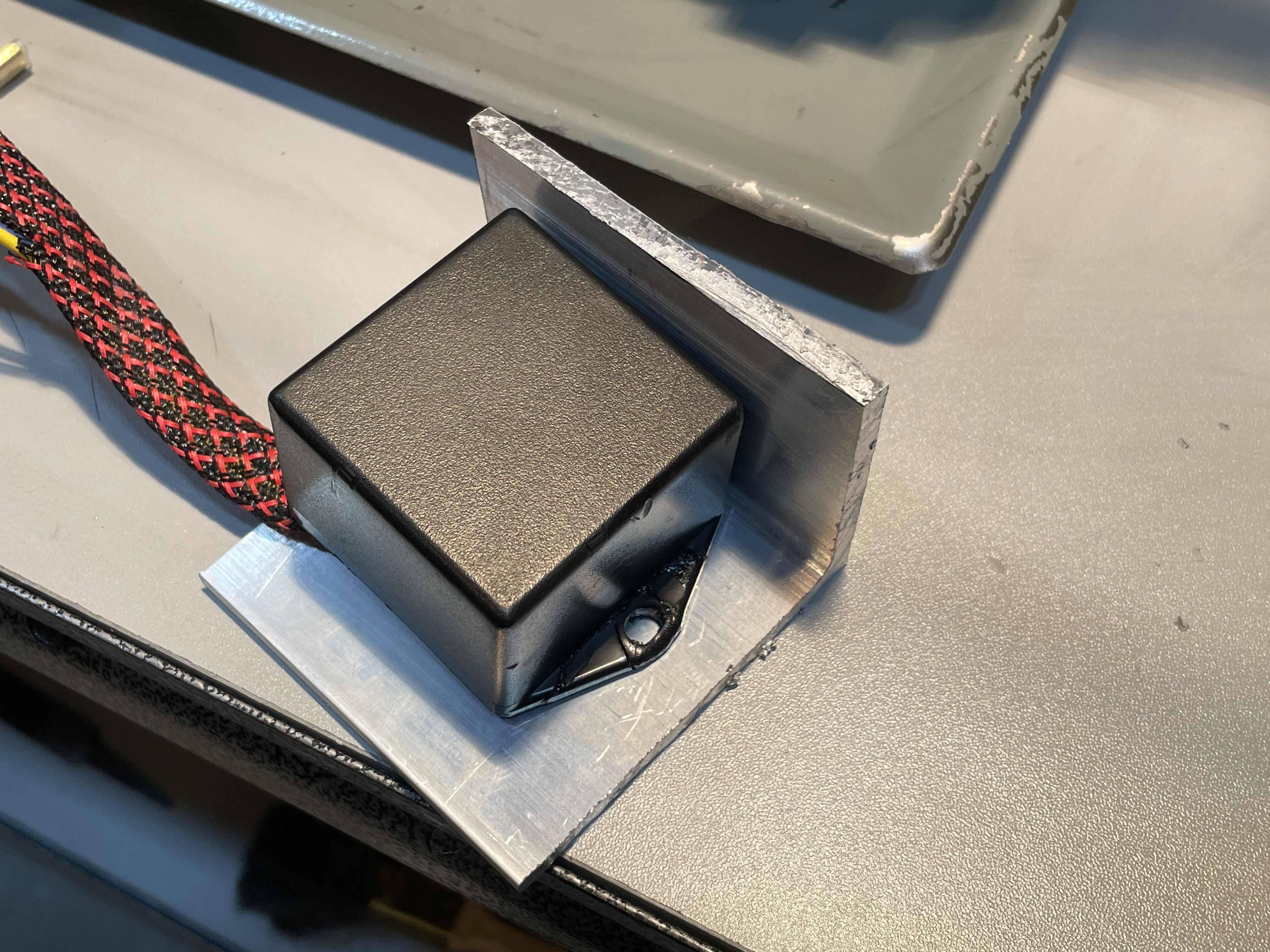

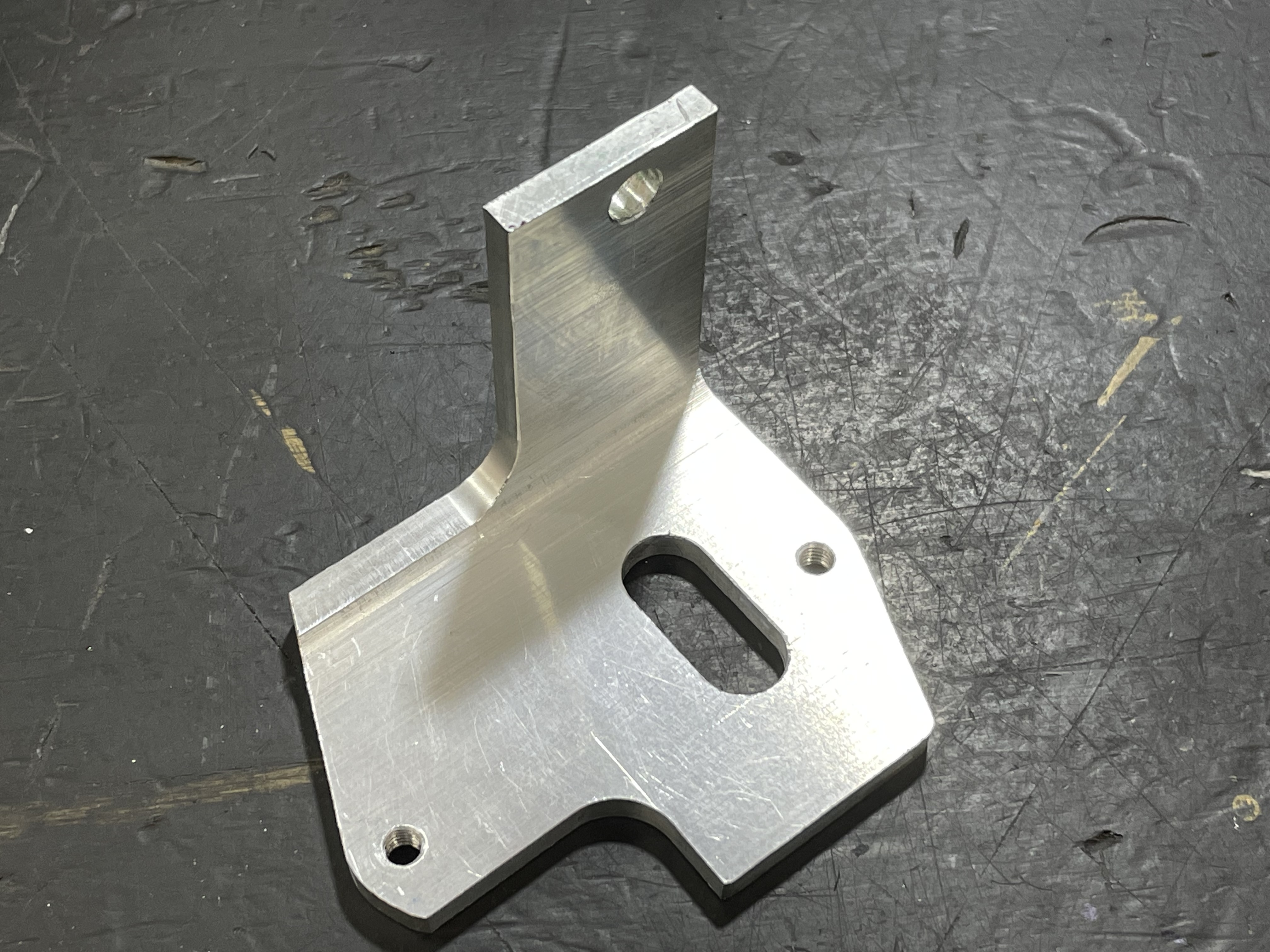

Now to fab up a bracket. Had some 3” aluminum L, looks like it’ll work.

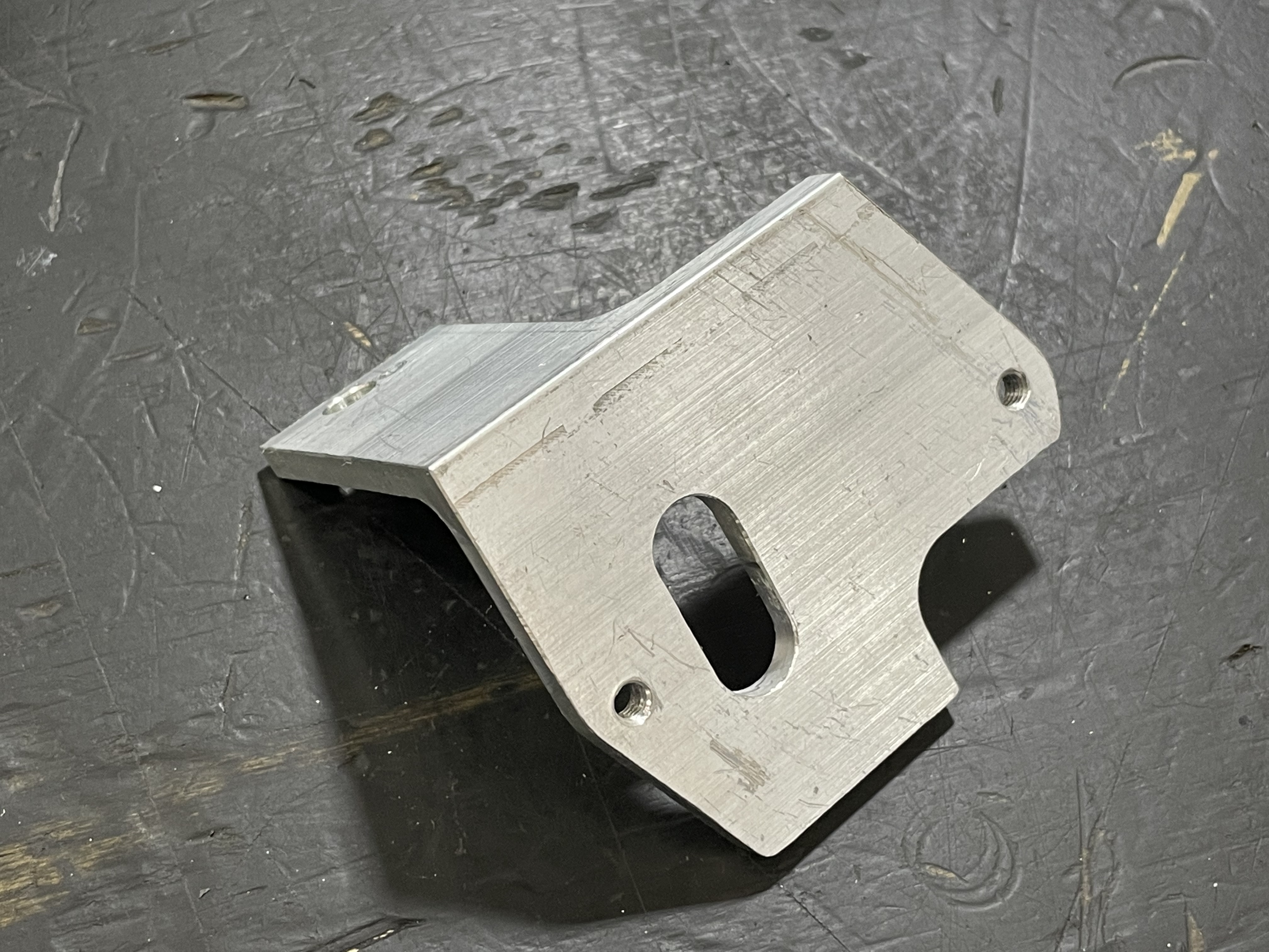

Spent some time on the mill, drilled and tapped some mounting holes, and about two hours later, voila!

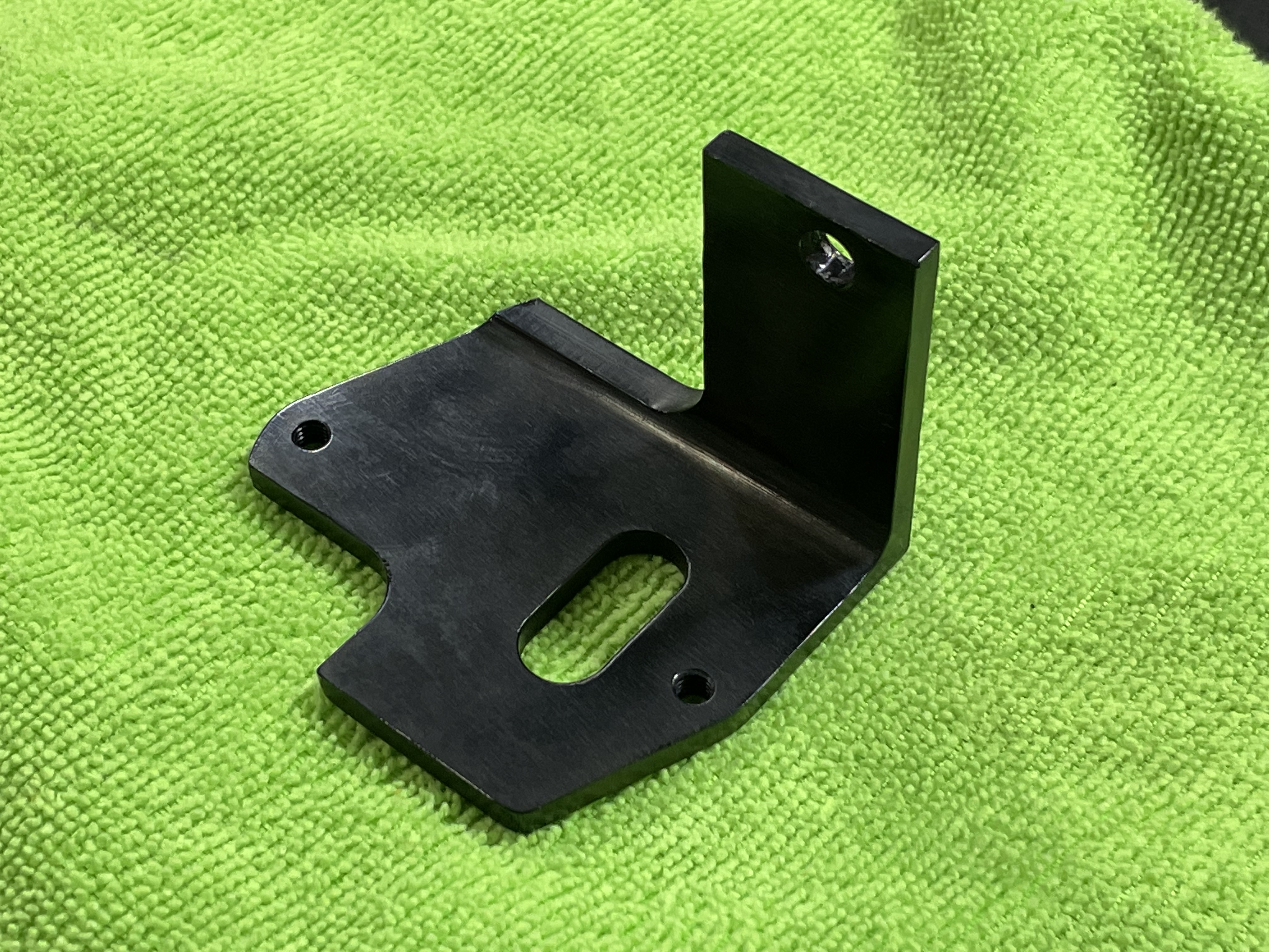

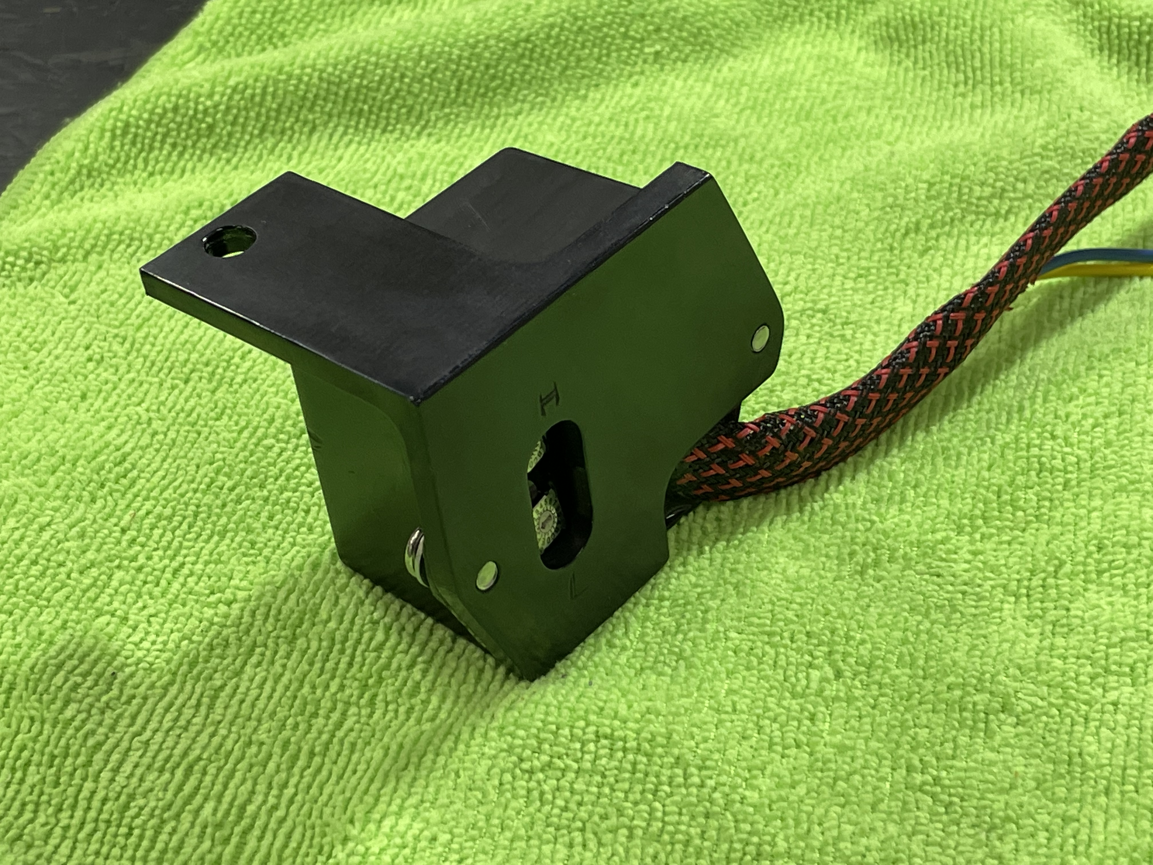

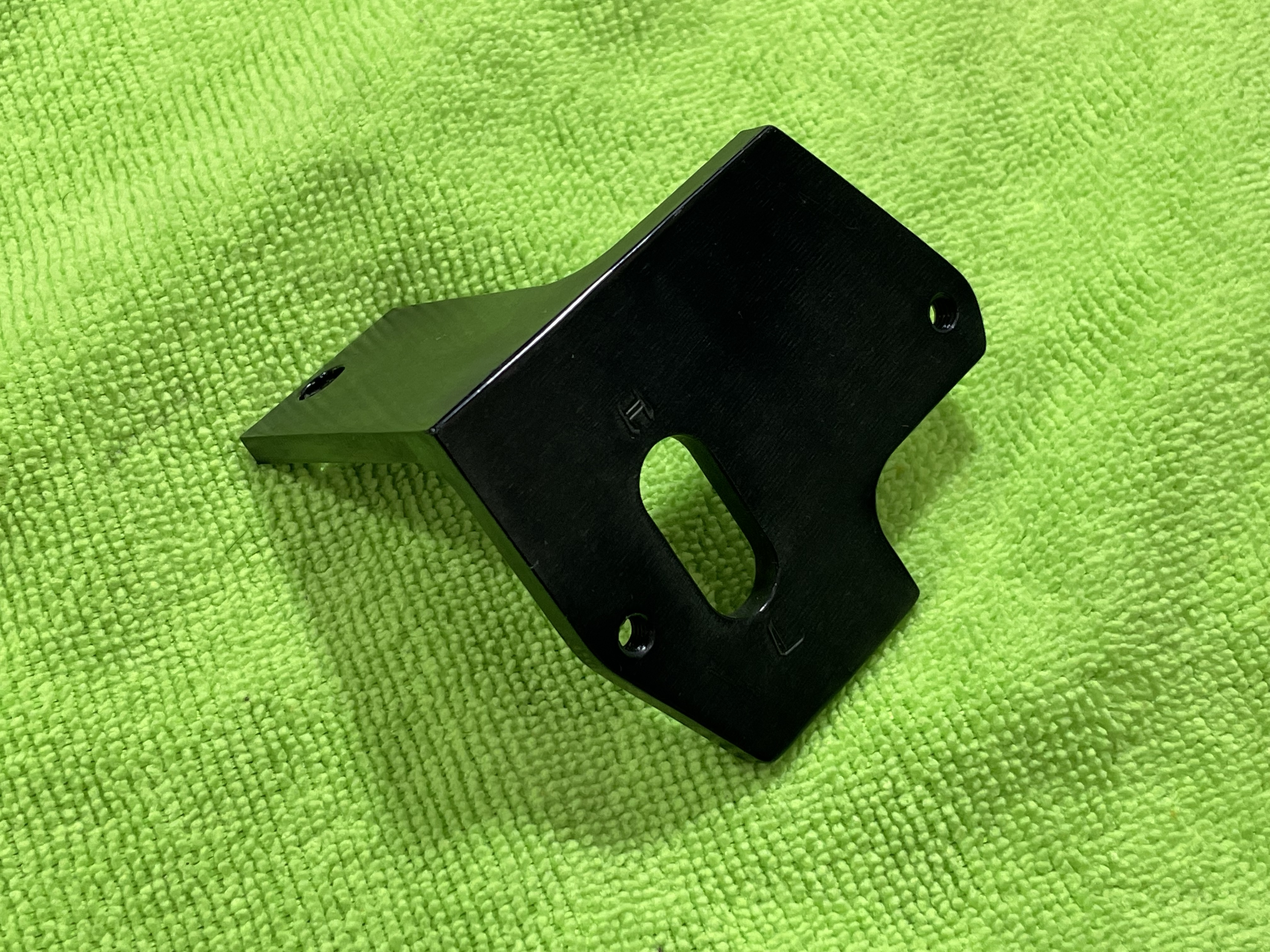

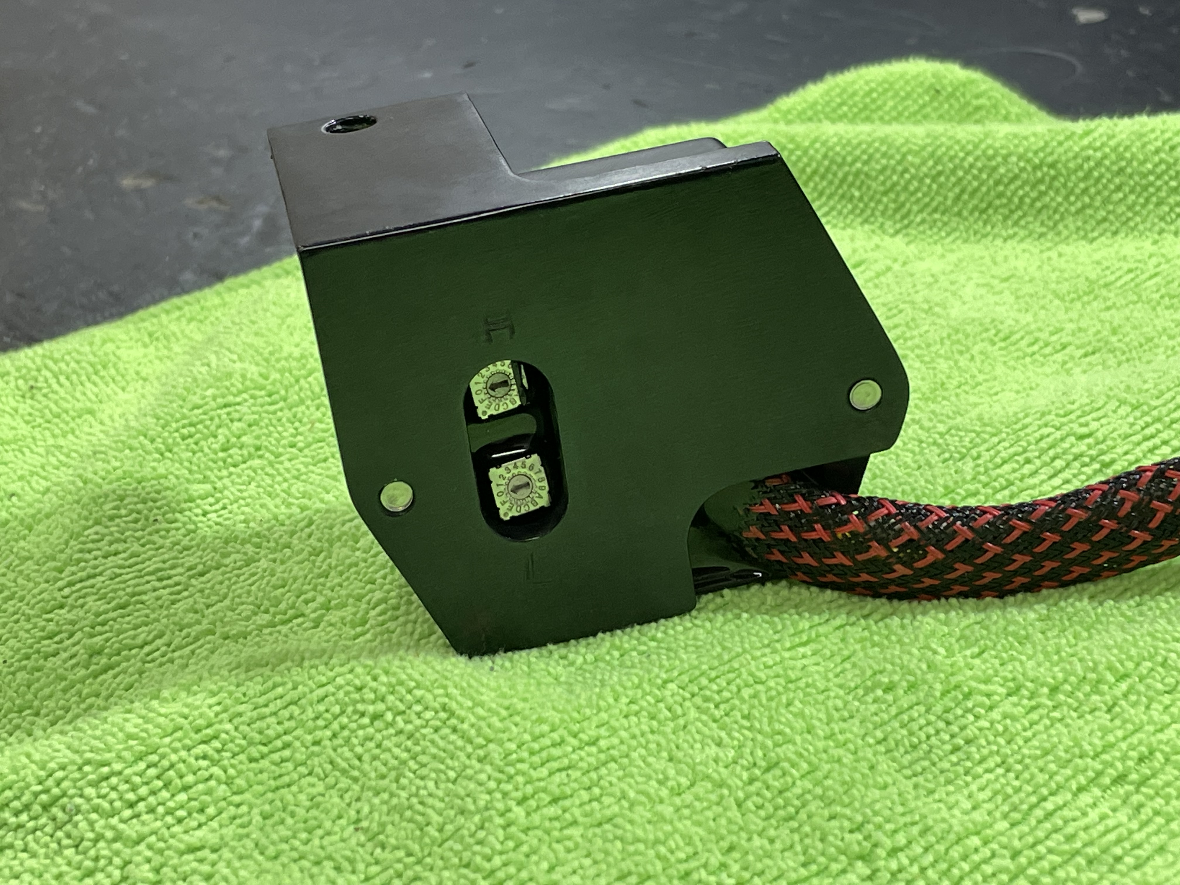

I can’t just leave it bare aluminum like that, so decided to prep and anodize it black. I used some letter punches to mark which adjustment dial is high or low, then hit it on the scotchbrite wheel. Turned out alright, I didn’t spend too much time on it, it’s just a bracket that’s hidden away anyways. Stainless mounting hardware, with lock washers because of the vibration.

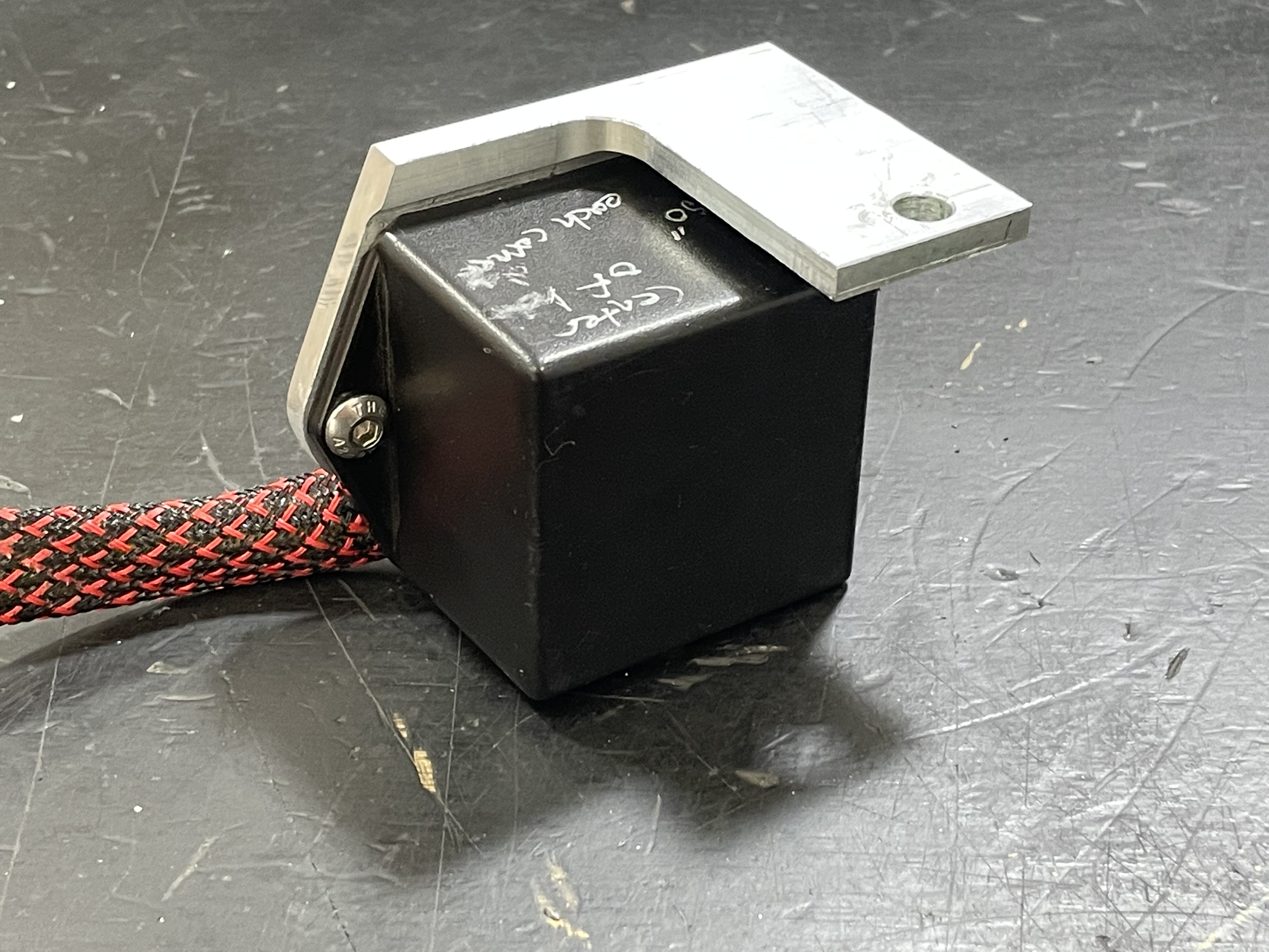

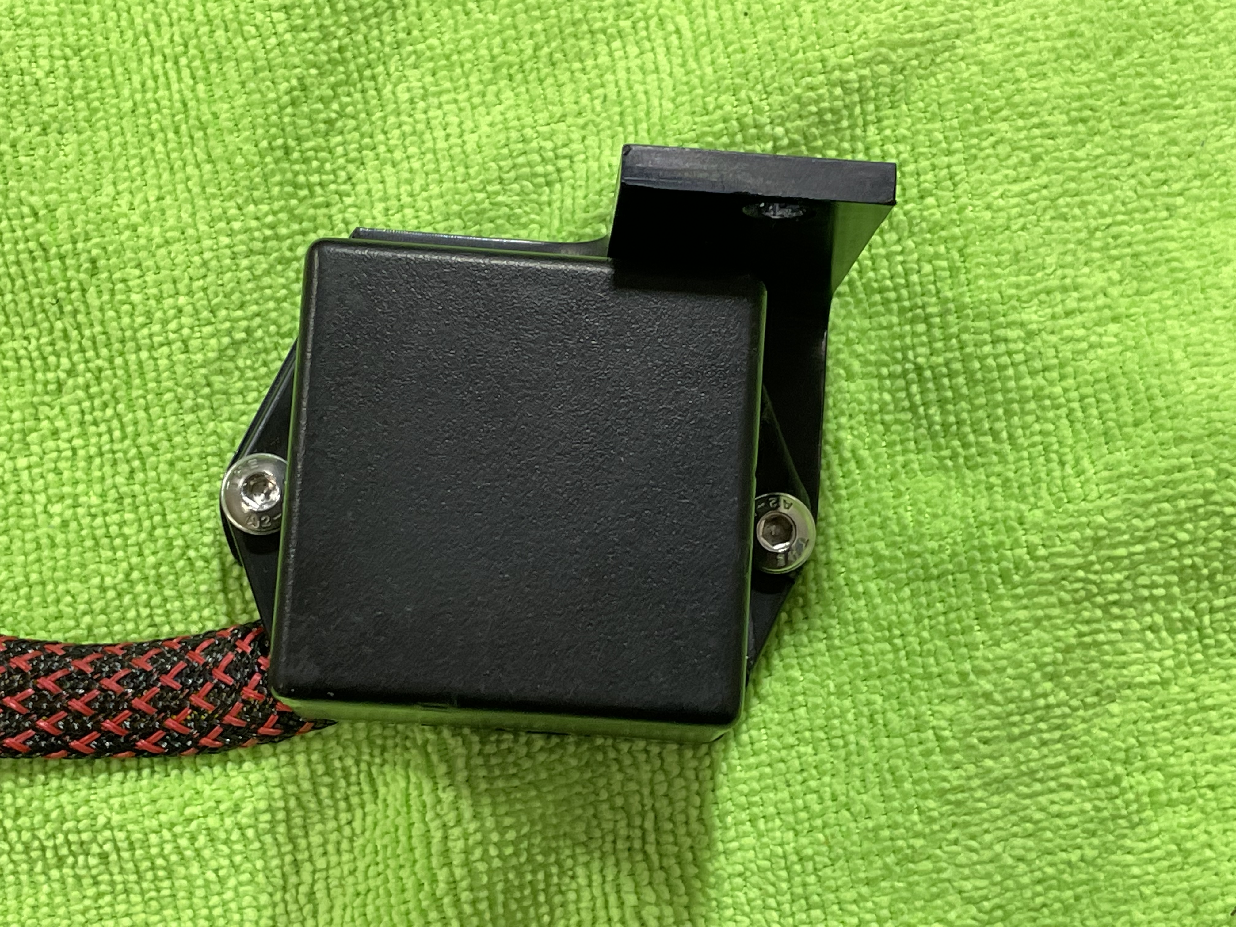

All mounted up! Plenty of room for me to get that dirty filter in and out, and the adjustment dials are accessible from the outside, I’ll just need to remove the side number plate. I didn’t originally intend to leave the dials accessible, I don’t see a need to tune them once I’ve found a setting I like, but the option is there and it was a simple slot cut with the mill.
