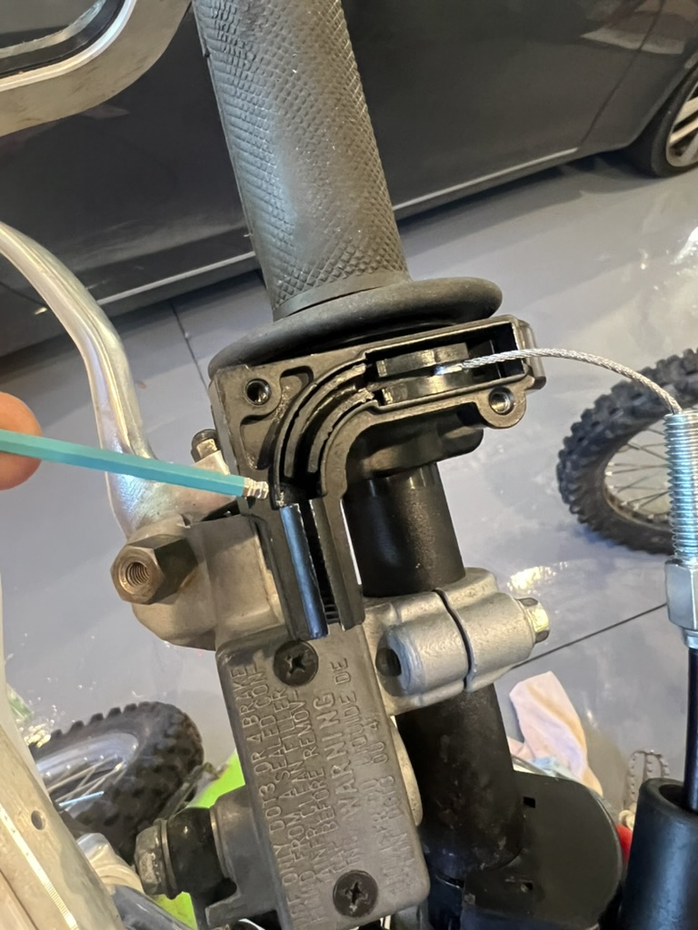

Hunter at Lectron recommended that I use the Motion Pro OEM replacement cable with their 90 degree bend adapter that is supplied w the unit.
I installed everything but there was not any free play in the cable which was preventing the slide from fully closing. I had the same issue w the Kawasaki OEM cable.

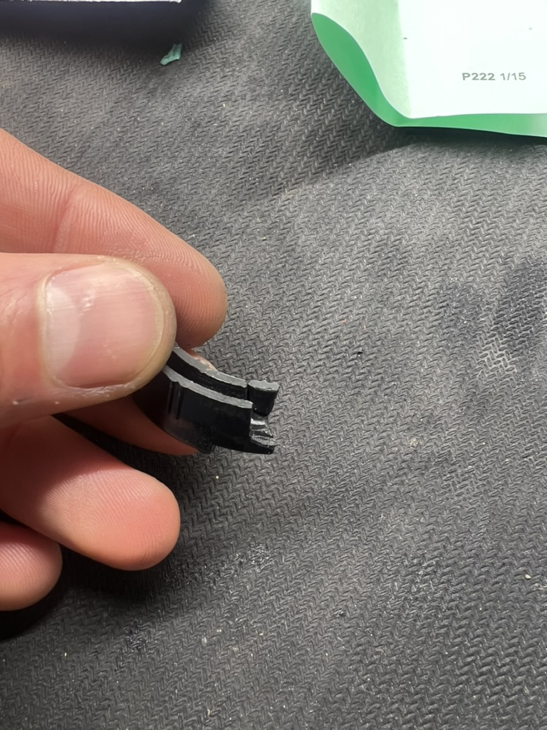

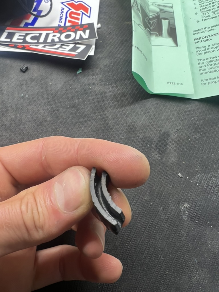

The solution was to remove both lock nuts on the 90 degree elbow supplied by Lectron AND cut off the lock nut on the throttle side where it screws into the throttle housing. The adjuster nut bottomed out into the housing but I still needed a little more slack so I removed the plastic slider piece that drops into the throttle housing and cut off part of the end so the adjuster could seat further into the housing.
Everything is perfectly adjusted now. Hope this helps!
