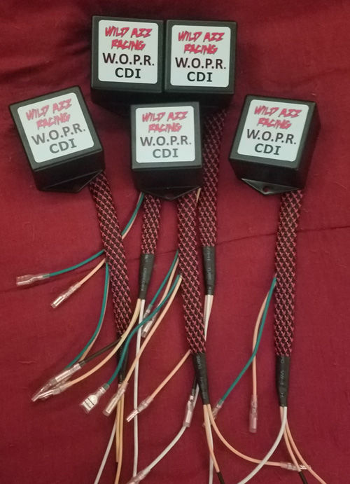

Ok, Moonstomper's CDI went out today. He should hopefully have it by Saturday.
- MoonStomper
- Posts: 609
- Has thanked: 5 times
- Been thanked: 14 times
MoonStomper is probably a little too excited about it too!

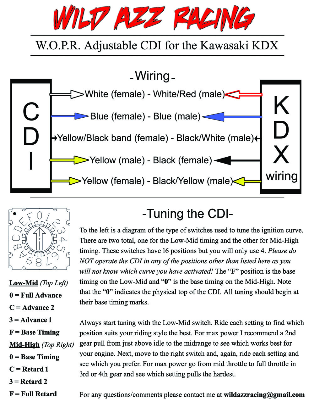

Just an update, testing is ongoing. I have over 150 miles of riding on mine so far with no hiccups. Only issue has been too much advance because I designed this off the E-series CDI so it has an extra 4 degrees of advance built in. On an H-series bike that would mean up to 8 degrees total which is excessive. It won't hurt the bike with proper octane and jetting but the problem becomes it wants to kickback when starting which both MoonStomper and I have both experienced. Moonstomper is trying something today that should give us some more much needed info and hopefully this will provide the last piece of the puzzle.
spencerdiesel
- Posts: 30
- Joined: 07:34 pm Jun 18 2019
Is that 8 degrees over the whole curve or just base/ idle? Glad to hear y’all being able to do some testing!
Newbie to riding, currently have a ‘95 KDX200 and an ‘03 RM125
- ss109
- Posts: 6256
- Has thanked: 33 times
- Been thanked: 55 times
It would +4 degrees advance over stock on just the base setting. Or at least that is what I think is going on. Trying to find the equipment I need to really see what is happening timing wise. Hopefully I'll have all the answers I need soon.

Yes, it would work on the E-series bike as that's the CDI I based it off off. Yes, more advance down low for more low end grunt but retarding the timing up high for more over rev.MarcE wrote: 03:48 am Apr 18 2022 Hi, this sounds really interesting, particularly as I think my CDI might be shot. I have a KDX 200E. Would your CDI work with a 200E? It looks as though you have been using it on H models. Also, I'm not very good with electrics so not too sure what this mod would do. Would it effectively let me advance the ignition at low revs to give more mid-low while at the same time retarding it at higher revs giving me more top-end/over rev? Thanks

They are interchangeable as in they are plug and play. However, base timing is different between the two bikes. I'm still working it out right now before I will sell them. If I get it sorted I have no problem selling anywhere in the world.

Here is my second bit of instructions, warnings, and info on the CDI along with my original wiring and tuning sheet. You need to follow both when using this CDI. Please right click and Save As... if you plan on purchasing one. However, if you like, I can email them to you as well! Thanks!
