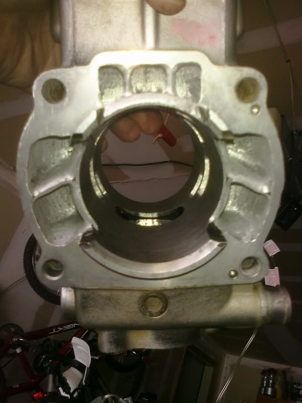

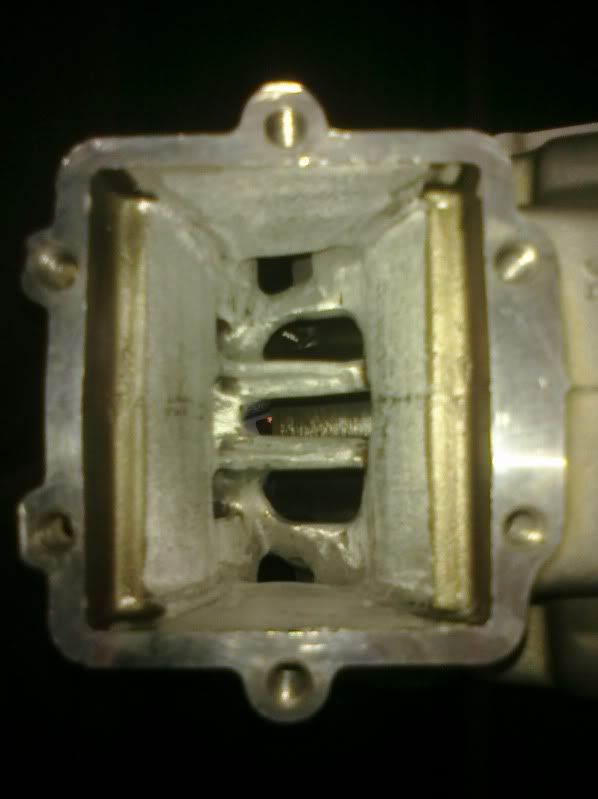

Also regarding your "PORTING" It appears Fredette did that Port Job...

I don't think anyone successfully mated RB mod and porting from FRP. You might wanna do a search and mention it to Ron...

Canadian Dave did the RB & FRP Porting years ago & worked for him. My bike seems to run fine. Definately more UMPF. Also mine looks NOTHING LIKE CARVERS PORT JOB. The porting on mine was slight, not a BIG GAPPING GAP like Carvers.
