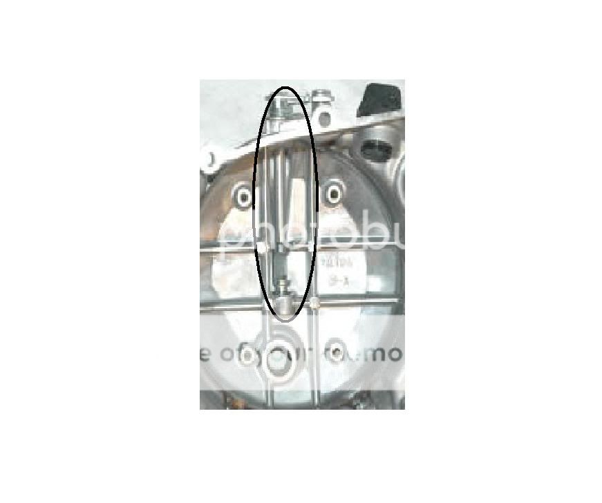

But, I do not know how to reinstall that rod that is vertical and sits inside behind the clutch cover. This rod has flat in the middle to accommodate the clutch push rod.
I can fit the vertical rod (don't know it's correct name) OK but then when the clutch cover is on this vertical rod does not rotate.
It should rotate as it is linked up with the clutch wire.
Help?

It's very very hard to rotate it by hand. You can put some vice grips or something on it to rotate it enough to get the clutch cable on. Make sure when you're putting the cover on that the flat spot is facing towards the clutch.

and, once cover is screwed back on, how do i connect the wire spring back onto top of this rod?
Byte

Just put it back together. It will all become clear then. It's only a return spring.... .

Re: 'once cover is screwed back on, how do i connect the wire spring back onto top of this rod?'
It is already ON the rod..right? And hopefully right side up? I think it's directional anyway. The end tangs are bent differently?
You could probably 'screw' it onto the rod if you happened to leave it off.
The top tab fits against the lever putting pressure on it as if to pull on the clutch cable. The bottom tab fits against the case.
PUT it where it's supposed to go with a needlenose plier, mechanics scribe, spring puller, or something similar.
Re: 'It should rotate as it is linked up with the clutch wire.'
You're saying you cannot pull the clutch lever to rotate that lever? Or is it as juliend said, you were trying to move it by hand?
Re: 'clutch cable remains connected. do i need to disconnect it?'
Huh? You would 'need' to disconnect it...why?
The lever will rotate by hand (with a tool) when the clutch cable is connected. You can OVERrotate it by hand that way, past the flat of the shaft to the round of the shaft. Then the shaft will just sit there. Clutch spring tension will not act on a round shaft to move it back to its 'start' position.
Oh, you DO rotate the lever by hand to DIS/RE-connect the cable..whenever that is necessary for whatever reason. I use a 10" adjustable wrench.

"It is already ON the rod..right?" - yes
"....Or is it as juliend said, you were trying to move it by hand?" - yes

by "by hand" I meant with your hands and no tool. Like Carvr mentioned, a 10" adjustable or some other sort of cheater bar may be needed to rotate the lever "by hand".
