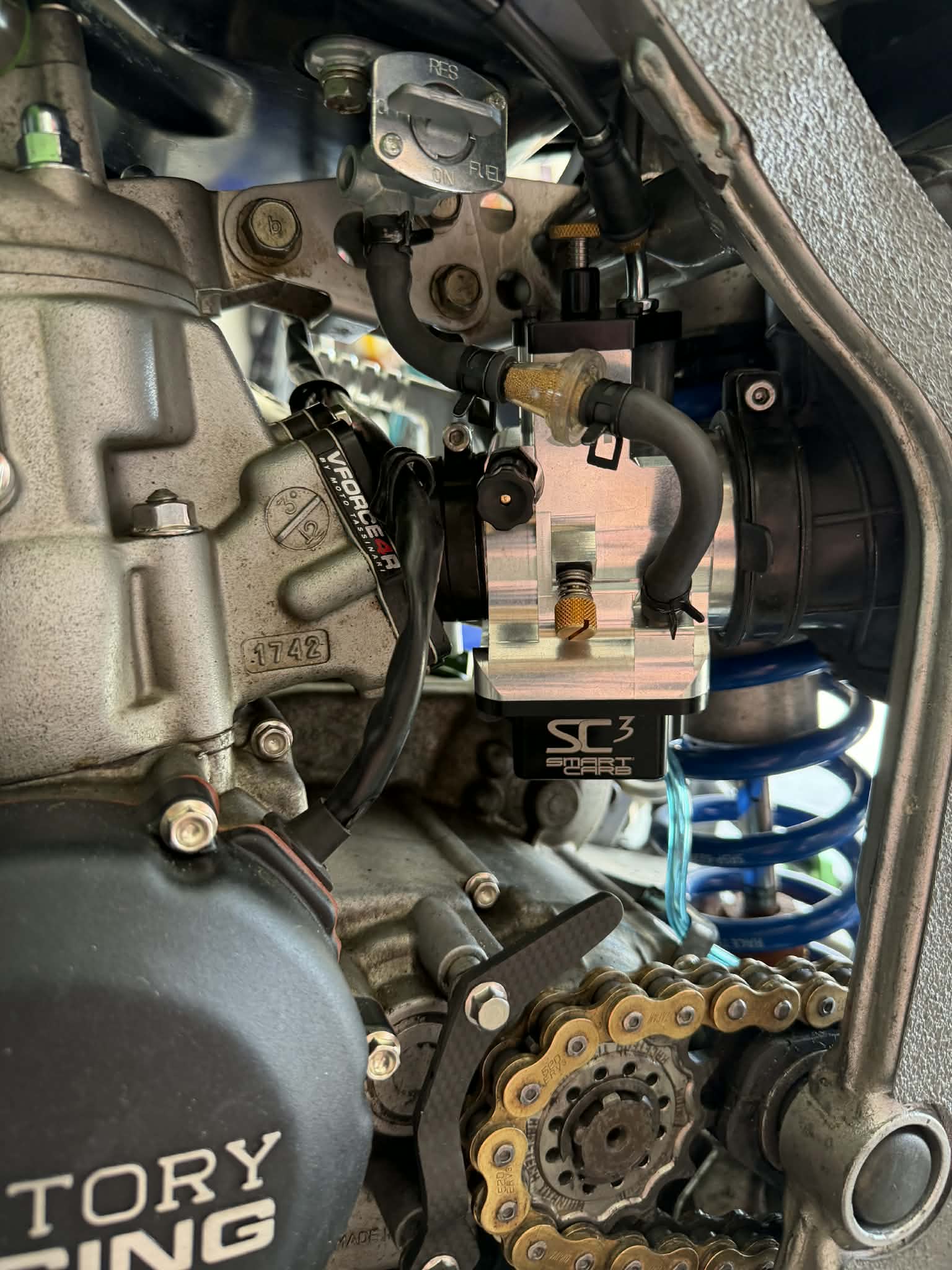

Well, I somewhat got my Smartcarb in today. It really doesn't fit my E series, not without moving the cable guide on the carb to face the right side of the bike and rerouting the cable on the bike. Even then, the throttle return is dangerous in how slow (if it even comes back) because of how the cable is pinching on the frame. Also, to even get it in I had to remove the brass adjuster from the cable completely. And the carburetor had to be tilted quite a bit to fit.
I took it for a quick rip anyways and it was running very lean, no bog, but absolutely no low end and the plug was turning very white and blistery from riding for less than 2 minutes. I started out with a dark chocolateish brown plug that my Keihin was running with, not a new plug. Hopefully this can be tuned out, as I didn't mess with the tuning whatsoever.
I also noted that the idle screw took a lot of adjustment to turn up. It started first kick with a very low idle and stayed idling there pretty well, very smoothly, but it was to low to ride properly, likely less than 1000 RPM. It seemed really rich when I first started it (lots of smoke on a smokeless oil and a very low idle) and had it on the stand, but when I started riding it was definitely lean.
I've contacted support so hopefully we can get these fitment issues sorted out. I believe if the throttle guide on the carburetor was shorter it would likely clear the frame, but not entirely sure yet.

Oh my... I'd never looked at E-Series fitment for anything but a stock-ish PWK, but it sounds like you'll need closer to a 90 degree elbow same as what I'd used to fit the Lectron Billetron Pro Series to the '95-'06 KDX. Anything less had the cable tight up against the tank. The Malossi M6 Mikuni/Keihin/DelOrto elbow was the best one as I recall, but the external metering rod adjuster may be able to be worked around with a slightly taller 90° cable guide elbow than the Malossi version if it'd permit the 90 going over top of the adjuster. The installed H-Series photos I've seen show the 45°-ish cable guide angled to aim the cable around to the side of the external metering rod adjuster.
I'll relay that to Nathan about the E-Series cable guide, but I'm sure they have sources for similar guides.
The tuning you'll definitely want to work through with Nathan/Corey @ SmartCarb.
The 200H has a much more pronounced high RPM porting configuration, albeit perhaps transfer ports that are a bit too high (typical of mid-1990's Kawasaki 2-strokes), whereas the 200E is ported to give more satisfactory torque in the lower mids and more mid-range power. Perhaps the 200E metering rod spec may be closer to the 220R settings, splitting the difference between the 200H & 220R? That's how I like to describe the power characteristics of the 3 in comparison to one another.
Keep us posted, Nathan at SmartCarb will surely get this 100% resolved for you.

Nathan sent out a modified cable receiver last week, I believe it'll be here tomorrow or Wednesday. I will have results this weekend if all goes accordingly. It certainly looks like the angle should do the job.

I'm still working closely with Nathan. The modified cable receiver just about did the job. He had to make a smaller thumbwheel for up top as the cable receiver was hitting it. He sent it out today, should be here tomorrow or Friday. He's been absolutely great to me, this is probably the best customer service one can receive if you want my honest opinion.
This is for an E Series, as far as I know it has been working great for those with H Series bikes. Once I get it fitted properly I'll go into detail on how it runs.
