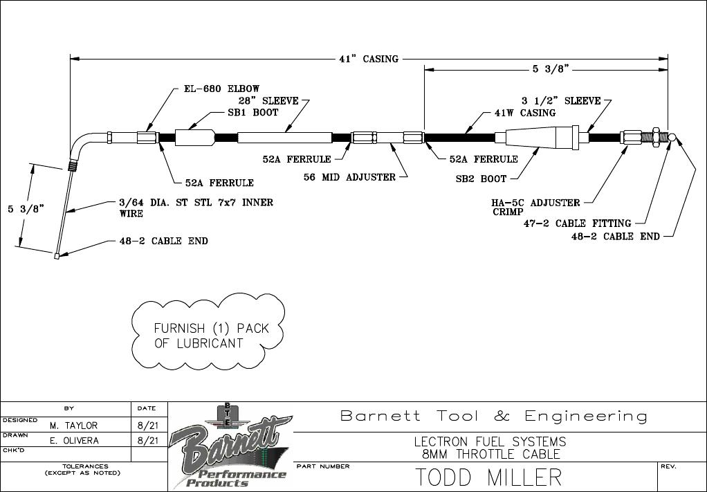

The cable elbow that Lectron supplies still isn't really what's best. That custom order Barnett cable based on the drawing with the part number "Todd Miller" is really what Lectron should be selling for a multitude of bikes, not just 95 and up KDX. My stock universal Lectron cable broke right where it makes the sharp bend between the carb and the gas tank. It's also a high quality Barnett cable, but the only flaw is that it didn't have a 90° or 70° elbow with a Teflon liner sleeve in it.

I have an OEM cable that I've had new in the package as a spare for quite some time and this is what I tested mine on, although I won't be running that as I want an aftermarket throttle anyways. They are slightly quicker turn and much smoother as they have a pulley on a bearing instead of an arcing cable guide path.
The OEM cable and the Malossi brand 90° elbow with all adjusters completely bottomed out was just barely enough on a brand new non-stretched cable to give me a very slight bit of free play enough to call it acceptable. One person was complaining that they could not get free play out of this setup. Another said Lectron provided elbow was a bit too long I believe. I tested this setup for Lectron, but they never sent me one of their threaded 90° elbows, I sourced those on my own to figure out what would work without hassling them about sending me more free stuff.
Ultimately, the custom order Barnett cable will be the absolute best thing as it has a Teflon sleeve lined 70° elbow built into the cable, and their cables are top quality. I snapped the standard Lectron cable with 8 mm thread for KX etc throttles, and it snapped right above the carburetor where it makes the 90° bend below the gas tank to run horizontal up front. I think the custom Barnett cable will last significantly longer and pull smoother. The standard Lectron cable lasted me three seasons of heavy use. Not enough by my standards.
I should note that I believe Barnett makes the Lectron standard universal cables as well, and they should offer one with the 70° or 90° elbows built into them, as this would make them last longer, but this is what electron provides. That's why I went with the custom order $64 Barnett cable. I'm not a broke 20-something kid anymore, and I love my KDX220's tremendously, so I'm not afraid to pour money into it. It's still cheaper than buying a new bike to abuse and destroy in a few seasons and rebuild & repeat.
The KX OEM cables correct amount of extra cable versus housing length to run the aftermarket throttles, unlike the stock KDX cable.
One of the Motion Pro universal cables that has a 90 elbow on the end of it actually might still work, but it doesn't have a threaded end on the metal 90-ish degree elbow. You can get a straight threaded M6 cable adapter for the Lectron carb (also fits Mikuni/Keihin and others), but this might put the metal adapter pretty close to the bottom of the fuel tank. I actually bought a thread die in that M6 fine thread pitch size with the intent of seeing if I could thread the end of the non-threaded motion probe universal cable elbow.
