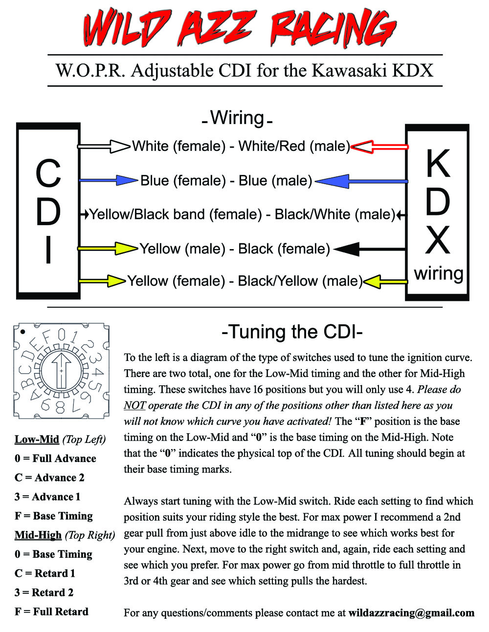

BTW, everyone, here is a pic of the instructions I drafted up tonight for my CDI. Is it easy enough to follow? Does it make sense?
ATTENTION: If you downloaded the previous instruction sheet please delete it and replace with the one located later in this thread. The original had errors on which switch positions affected which area of the Low-Mid curve! The doubly incorrect version has been removed and the corrected version has been added in a post below.

Very well done. It even makes sense!

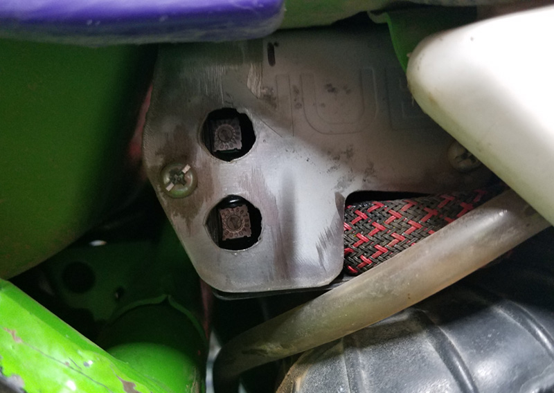

BTW, for those talking about where to mount the CDI, here is what I did and a quick and dirty bracket. As you can see I can access the switches without removing anything and the only tool needed is the tiny screwdriver for adjusting the switches. I plan to remove it later, and either paint it or plastidip it. I made the bracket out of a Tubliss tire install helper tool since I have a few of them around. It is mounted on the left side of the bike just behind the fuel tank and in front of the side plate. When I get my latest vid up you should be able to see it easier.

I just wanted to note the instruction sheet says "0" is the base timing on both switches but the picture says "0" is full advance, maybe a typo.

DonnyV wrote: 02:58 pm Feb 21 2022 I just wanted to note the instruction sheet says "0" is the base timing on both switches but the picture says "0" is full advance, maybe a typo.
Good catch. I forgot to update the wording as well. I'll correct that today.

Ok, I hope I got everything correct now. If you spot any errors please let me know! Thanks Donny for catching the one I missed!
CDI instructions Corrected4.jpg (546.51 KiB) Viewed 26099 times
