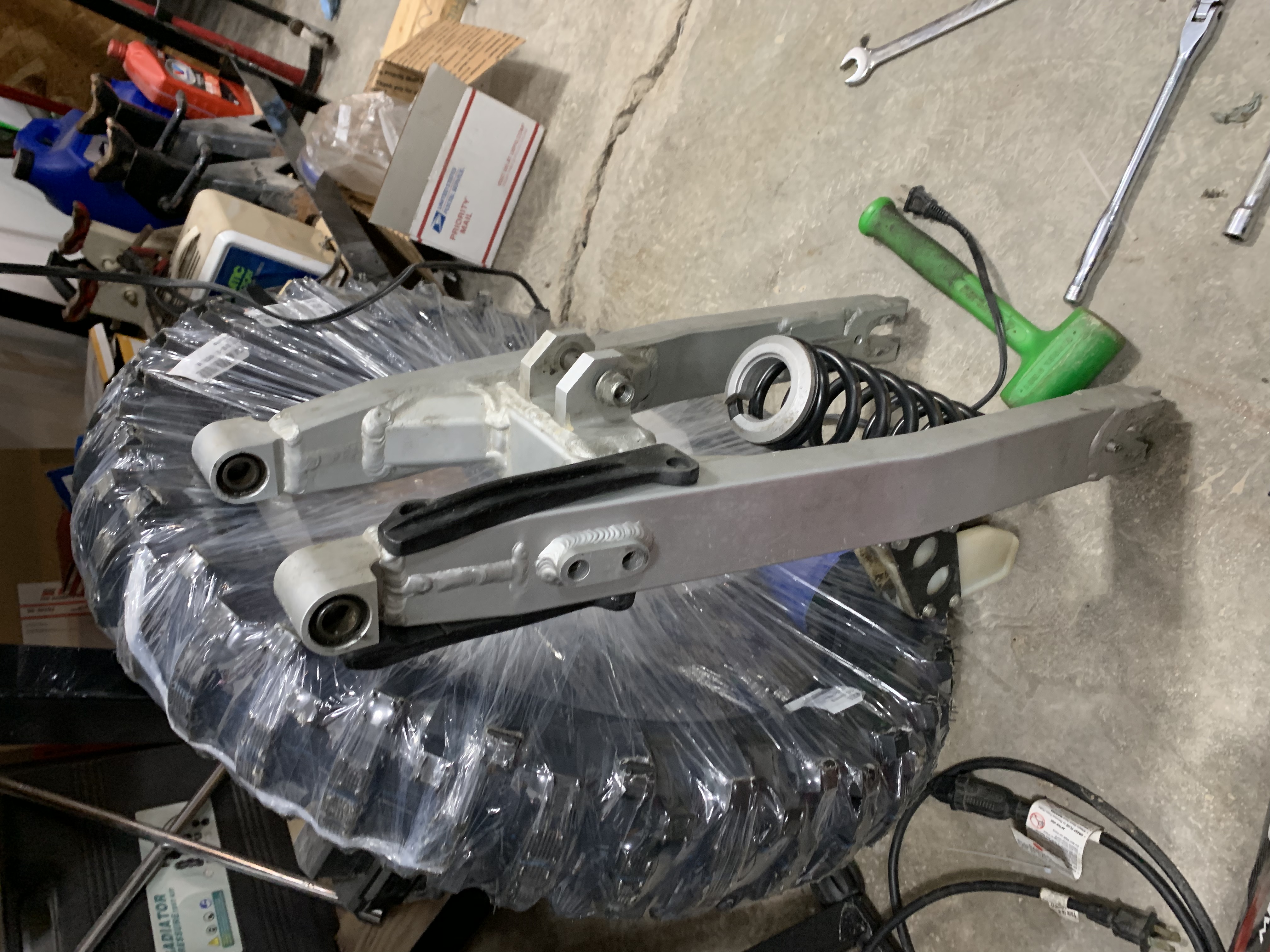

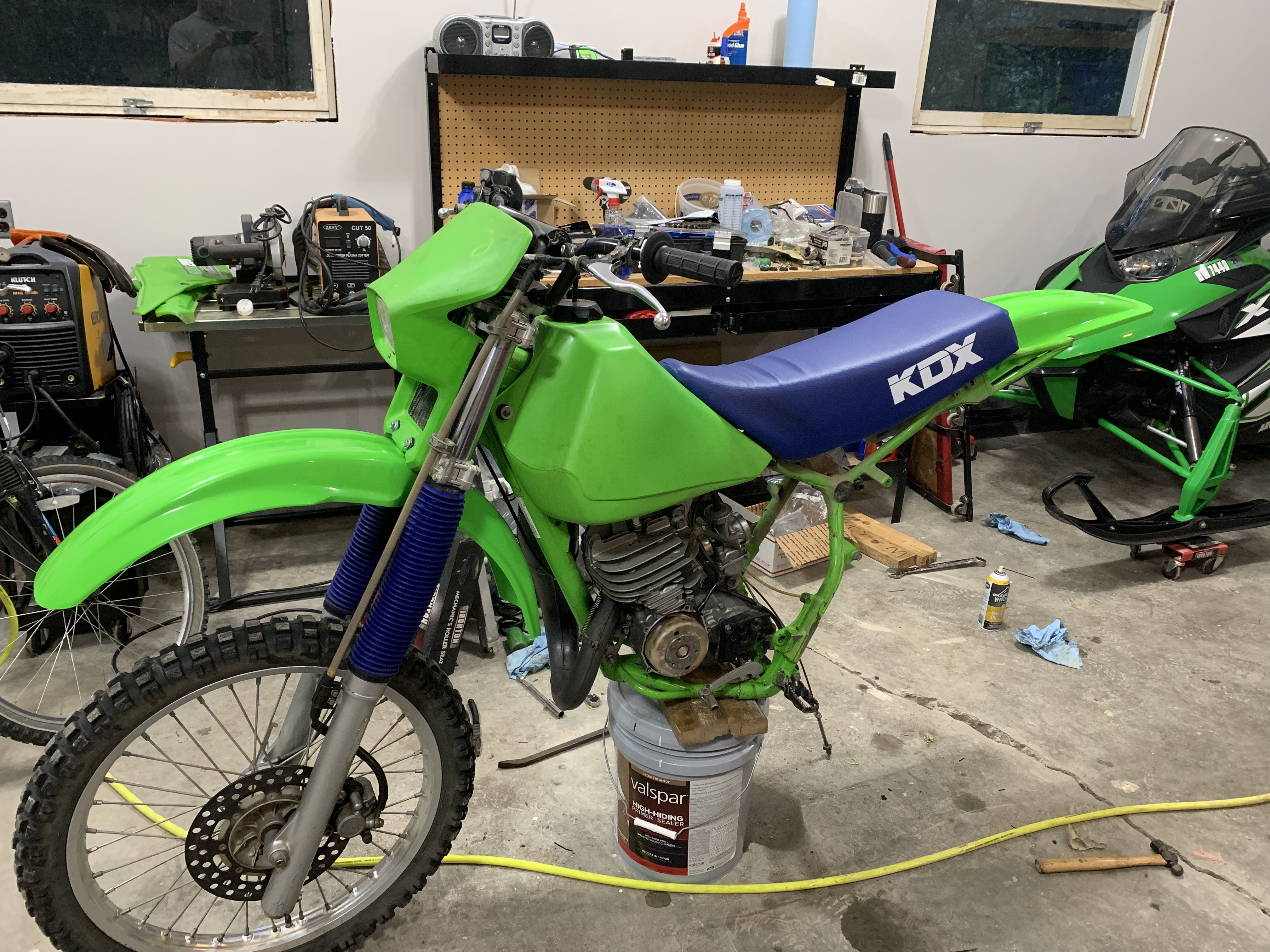

Finally found a power valve cover. On its way. Seat cover and new foam is installed and looks good (in my opinion). Levers and grips installed, toggle has been replaced with a proper kill switch. Chain sliders installed. Pulled the suspension & shock. A buddy is going to go through the shock. All of the bearings seem good so cleaning and greasing. Thought the carb boot was ok, but it’s dry rotted on the back side. Need to pick up a carb boot and exhaust seal yet, but I think that’s it. Install the shock and tire and hopefully give it a try. New seat foam seems firmer than stock. Hopefully just right. Seat cover is of good quality. Actually pretty pleased. It’s from an 87, but not a big deal to me. Making progress.

Aw, man. Getting close! The seat cover looks great.

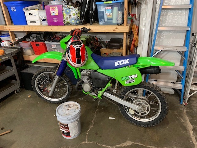

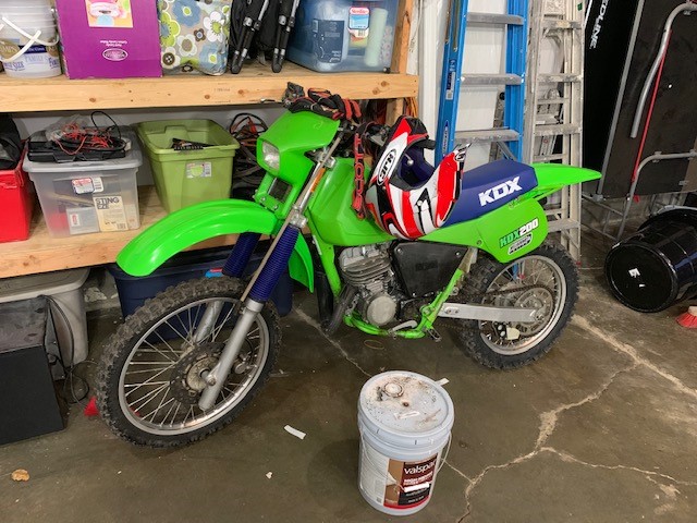

so, got the bike done... well as done as I can get it for the summer. I attached a couple pics. Runs good, has decent power. Suspension feels much better now that all of the bearings and clean and greased. Didn't get the shock done, but it damps ok. will work for now.

Re: Parts recommendations for 88 KDX 200
You have got it looking good!Wesalauzen wrote: 10:10 am Jul 06 2020 so, got the bike done... well as done as I can get it for the summer. I attached a couple pics. Runs good, has decent power. Suspension feels much better now that all of the bearings and clean and greased. Didn't get the shock done, but it damps ok. will work for now.
