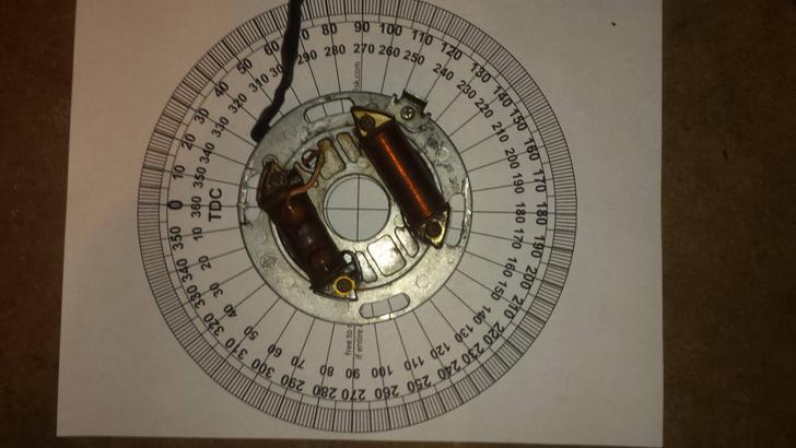

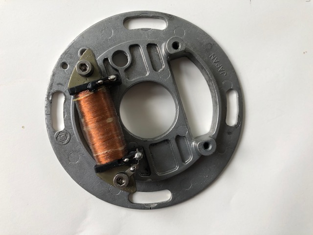

Inspiring build, very nice. Could I pick your brains on the H flywheel conversion - and the FRP modded stator pic you posted a few years back?
I have an 87 which I'm converting to H coil, flywheel and CDI. I've re-slotted the 87 stator at exactly 90 degrees to the standard holes. Looking at other pics (like the FRP one) the holes are not 90 degrees, more like 75 deg offset. I've included a pic of mine, and a pic from a forum member who I can't get hold of. Do you think I need to start cutting new slots? Thanks for any advice.
Also (I'm not sure if you did this mod) but do you need the generator cover off the H?

Hi,
Forum member Hail Seizure did the mod, and reported that it worked with a 90 degree rotation. I never did the mod as I had good original flywheels.
