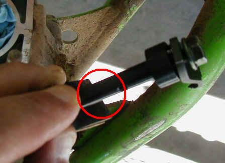

From your pic it looks like you have the jug off? Might as well remove the kips and clean everything really well. It needs to be done every year or two at least, and you already have it torn down.
JHNguyen89
Posts: 24
Joined: 02:36 am Dec 15 2009
Post by JHNguyen89 »
Unfortunately, that's not a photo of my bike.
