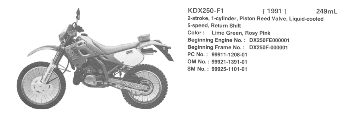

KDXGarage wrote: 05:33 am Jul 16 2024 F series seems to have PWK. Look on Impe Japan parts diagrams. If you can post the VIN or frame number and maybe an engine number, I can look it up. Thanks.
2 noteworthy identifiers here... DX250F-001408 and DXFE-001411 maybe that helps

Dang. Impex. My "X" key gets stuck.
OK, 1991 KDX250-F1
https://en.impex-jp.com/catalogs/moto/k ... -1609.html
1991 KDX250-F1.png (186.19 KiB) Viewed 89358 times

this is quite challenging for me...are there any sites that just sell repair kits for that carb? or I would consider buying a new carb but have no idea what would be appropriate.

Yes. It is an SR version. It is a 1991 KDX250-F1
