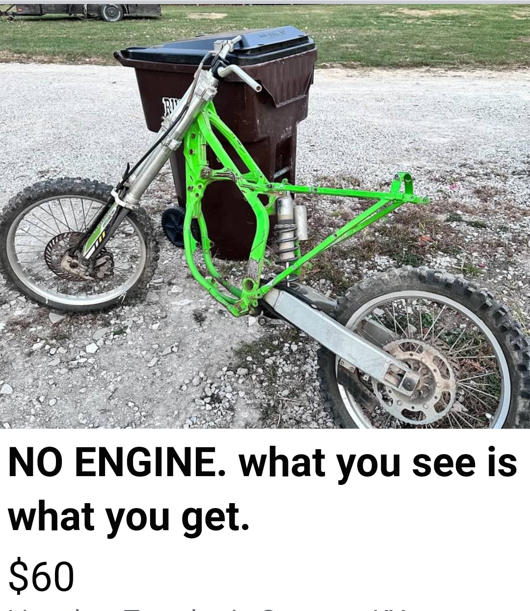

Hmmm..... 2000 KX125 bare rolling chassis, $60 + fuel/time! I need to try and sneak this one in somewhere somehow, so the wife doesn't kill me!!!!
2 hours from home, or 1 hour off the 1.5 hour route to get to the furthest riding area that we hit once or twice a year in southern ohio...
Having an airbox & seat would be nice, but it's tough to beat for basically $100 & a half day!
I revisited this last night after thinking about the potential weight differences between an aluminum seat subframe and steel. I was looking KX frame subframe mounting points by the top shock mount, and thought that drafting a 99-02 KX aluminum seat subframe and probably airbox and rear fender onto a KDX frame, the beneficial to have a strap KX frame to cut points off of, and this would also give us smart carb, as shock mount frame crossmember area is an arched front half back half press formed piece, instead of a straight round tube with a slight dimple pressed into the bottom for carburetor clearance, that the 95-06 KDX has.
If this frame or not able to be titled, I could at least use it as a donor for that.
The KX front upper perimeter frame sections do appear to mount about a half inch lower than the KDX, very slightly reducing the center of gravity for the fuel tank weight, but the bigger difference is the KX's standard 2.2 gallon capacity versus 3 gallon capacity of the KDX. Both are perimeter frames, and I feel that using all the race spec steel bolts from a KX with dished out heads, and the lower fuel capacity, say using 2.2 gallons in the KDX instead of 3 gallons filled to the brim, would get rid of most of the difference in the top heavy feel KX hybrid vs KDX. KDX seat is really not as thick as it appears, and didn't seem alarmingly heavy to me, and also that is one area I would like a little more comfort in all day rides the point of exhaustion. You can't stand up for 7 hours out of a 9 hour riding day (w/ 2 hrs of breaks total).
My 98 RM125 4.6kg purple shock spring weighs in at 2lb 15 oz, & my 98 RM250 4.8kg purple spring @ 3lbs 1 oz, Diverse Spring's Chrome-Silicon lightweight steel 4.8kg spring is 2.5lbs iirc, 1174 grams they said, and the RCS / Renton Coil Spring 4.8kg Titanium spring is 2.1lbs iirc, so this is another area of substantial potential weight savings to compensate for the KDX seat and extra fuel capacity.
I'll be looking into long case cover bolts as well if Partzilla lists the dimensions of all. Mettec & Titan Classics have some really good prices on Ti bolts, although unless on clearance for $175, the Mettec axles cost an astronomical amount at $300-$500! No thanks...

Those are some cool finds!
People are still wanting Covid price for blown up bikes that have sat for a decade.
Posts: 1562
Has thanked: 309 times
Been thanked: 144 times
Re: KX125/220 hybrid vs upgraded suspension on 95-06 KDX
KDXGarage wrote: 12:54 pm Nov 17 2025 Those are some cool finds!
While the gold Excel Takasago rims on the complete/needing-fully-rebuilt $900 '97 KX125 were appealing (but still 19" rear I believe), & knowing I'd not find myself missing some bracket or odd fastener here or there in build, I found enough of the major parts on eBay to put together a hybrid build for about $530-ish, shipped to my doorstep, including a couple of $100 frames and several around $195-$250...
If I hold out for a little while going into winter, I bet some of those eBay sellers may start sending out even lower reduced price offers if I re-add the parts to my watch list at a later date! Adding parts to your watch list is a great way to sit on things to wait for deals, as sellers often will send lower priced offers to people who have done such, or sometimes even to people who simply viewed the auction listing.
I'm unable to do any bike work for the remainder of this calendar year due to day job + renovation efforts to get my old house sold, but will get back to these fun projects late January as well as some car/truck projects... I'm ecstatic to find the buy-in for the pieced together hybrid build to be reasonable for me, but I do have engine, spare laced up KX 18/21 wheels (my KDX spares), a KX450X fork and triples, extra 98-04 RM125 Showa shock, etc... and these other very cool and scarce aftermarket parts pictured above... It'll be quite a bike for sure! After it's done and I've had a chance to compare it to a heavily modified KDX with titanium fasteners throughout, I'll then have to start watching out for the sales from Race Tech Titanium, Mettec, Ti64, etc, and start decking out the hybrid with some titanium hardware as well!
