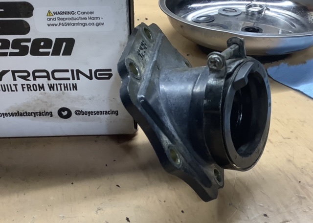

Thanks for the suggestion on this other petcock. I really do like my routing like it is, but that might be even stealthier yet. I see other bikes out there with fuel filters and wires and stuff hanging out around that area ready to be snagged and just wonder how they get away with it.
Here’s the stock reed boot that came off mine - it’s at least a half inch, probably closer to 3/4” narrower than the Boyesen on there now, no wonder the carb is so far back, but OH MAN SHE RIPS!
