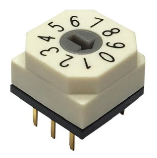

This must be close to the type of switch you mean? It would be nice to be able to mount it where you can reach it with your screwdriver without removing the seat. Maybe a longish pigtail could facilitate this?

That pic is the style of switch I will be using. Yes, it will allow you to dial it in depending on the mods you have, from bone stock to a fully ported, squished, bored out beast. However, it wont get as many curves as there are positions on the switches as that would create a very complex and crowded circuit board. Plus, the way those rotary switches are wired internally are a little different than a standard SPST on-off switch. Depending on the position it can connect up to four points simultaneously or none at all. Each switch will give you four different timing curve plots. Switch #1 will affect the bottom to mid-range predominately but will affect the top as well. Switch #2 will only affect the mid to top end timing.

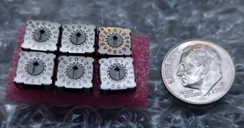

UPDATE: My switches finally made it just a few minutes ago. I only bought six as I wanted to make sure they work before I order the full lot. They are quite a bit more expensive than I was hoping for but it's worth it if they do the job. I will say, they are tiny!

Are you going to ‘pot’ them in a small case? They really are tiny!

MoonStomper wrote: 07:31 pm Feb 10 2022 Are you going to ‘pot’ them in a small case? They really are tiny!
Yes, in the smallest case I could find that would fit everything inside without going to custom made ($$$) housings. 2x2x1.5"

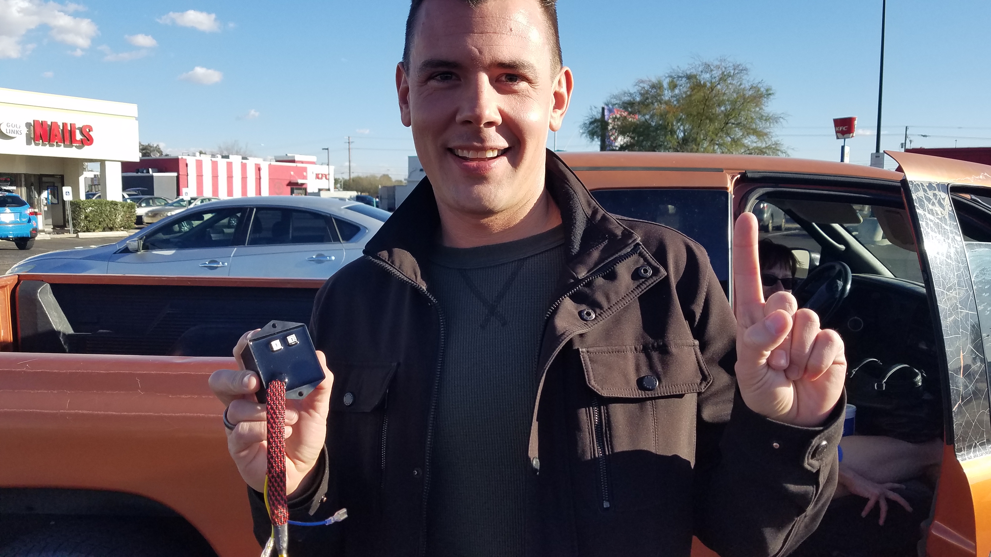

Reason I'm posting this here is because Nick is the recipient of my very first adjustable CDI I was willing to send out. The potting hasn't even fully cured on it yet! Still not happy I couldn't find the wiring in the color/stripe configuration I wanted but it is a complete and working unit. Hopefully this encourages him to get out and ride his KDX some more. Besides, Nick, you gotta get your lady back out on the trails as well so go ride! :mrgreen:

It was an absolute pleasure to chat with you today my man! I could sit and talk KDX for hours upon hours! I’m honoured to be the recipient of the genuine, bonified, serial number 001 adjustable CDI! I promise I will put it through its paces, including some cold weather testing. Can’t wait to get this thing back to the north and see how far we can push it!
The CDI unit looks amazing. It feels well built, you can tell that it’s made from quality components. The switches are potted in nicely, I can’t wait to get it mounted and start tinkering with the various settings!

That’s a stoutly built unit, a KDX-worthy looking piece for sure! Neat that you guys could get together, I know Slick Nick enjoyed seeing the sun again!

Yep, that CDI so new that I haven't even gotten the label for them printed up nor completed the installation/tuning instructions yet! I wanted for him to just transport it to Canada instead of shipping it. This way I know he got it and didn't pay any crazy fees on top of it. BTW, working on the installation and tuning sheet right now. I'll make the electronic version available here online and I also plan to ship out a sheet with every CDI going forward. In the near future I also probably do a video covering both the installation and tuning.
It is very cool that you guys got to meet up. I do have some bad news, though. Neither of you is close to being as pretty as that CDI. :razz: It looks terrific! Thanks for making it. :bravo:
