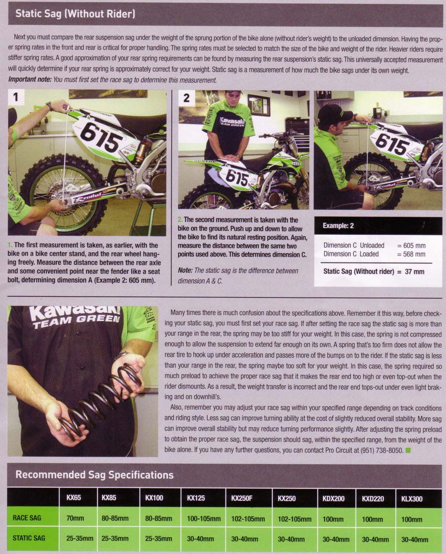

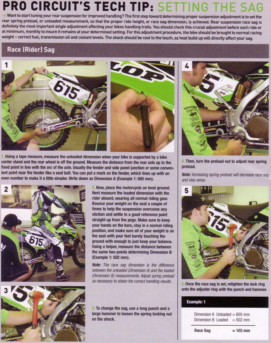

90mm race sag seems way off to me. It's recommended to be close to 100mm race sag with 30-40mm static sag. 10mm is a huge swing. I think I'm running 103mm on a 4.8 at 140lbs no gear.
Setting sag.jpg (247.5 KiB) Viewed 43766 times
Setting sag 2.jpg (233.41 KiB) Viewed 43766 times

SS109, yes, I am shooting for 100mm race with 30-40mm static.
Last night I had no gear on, so I worked the other way around. I set the static sag first to 35mm.
Out of curiosity I then measured the race sag, without wearing any gear.
Don't worry, before riding I'll adjust it properly with gear on but I think the weight of the full boots, protectors, helmet backpack etc should cover the missing 10mm

With the 4.8 spring I'm at 100mm race sag, with 37mm static sag. I kept my usual tire pressures (on step at a time!)
