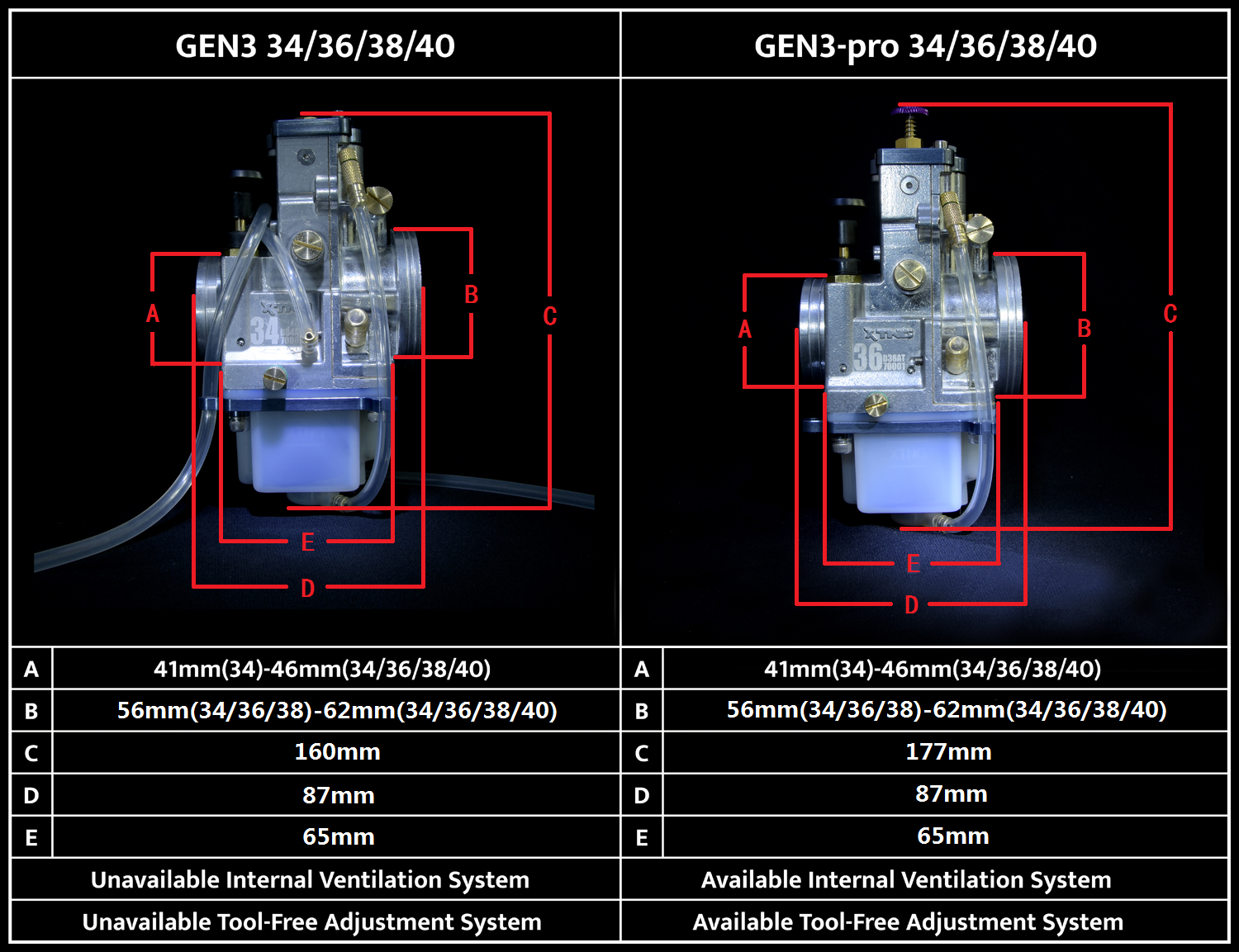

Another thing to look into perhaps would be the new Gen3 XTNG carbs. They're a hybrid of the best features of the Lectron and SmartCarb combined. They're Chinese, but allegedly a rider-owned company, & one that seems pretty serious about R&D. I doubt you'll get one thats so close to perfect fuel metering for a KDX out of the box like the Lectron fuel metering, but we won't know until we try!
I'm pretty seriously considering one for my vintage woods racer 1977 Suzuki PE250B build... Probably put my KDX's stock PWK33 into the '83 PE175 then, or sell it for another XTNG!

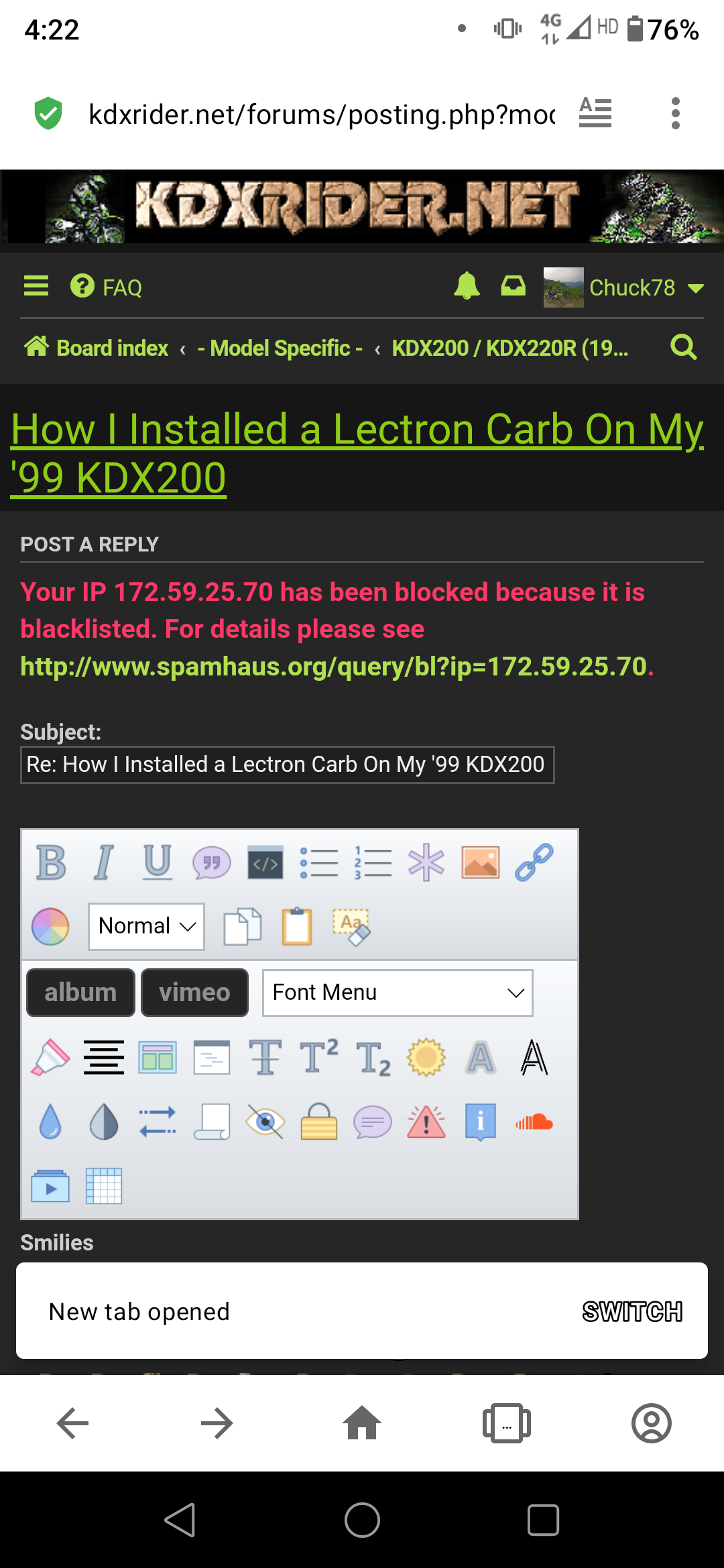

Darnit it won't let me remotely display .png or .jpg images from the XTNG carbs website!
I think it just flagged me as a spammer for trying... I get an errir/warning message on my kdxrider.net posting editor screen saying that my IP address has been blacklisted for spam by SpamHaus... What gives? It's clearly working in conjunction with this forum. I found 2 other posts with mention of this Spamhaus/IP Blacklisting, kdxgarage thought that spamhaus had nothing to do with our forum site. Clearly it's written into the forum software.
Here, I've uploaded it to our KDXRider.net server instead of remotely linking:
XTNG Gen3 carb dimensions
