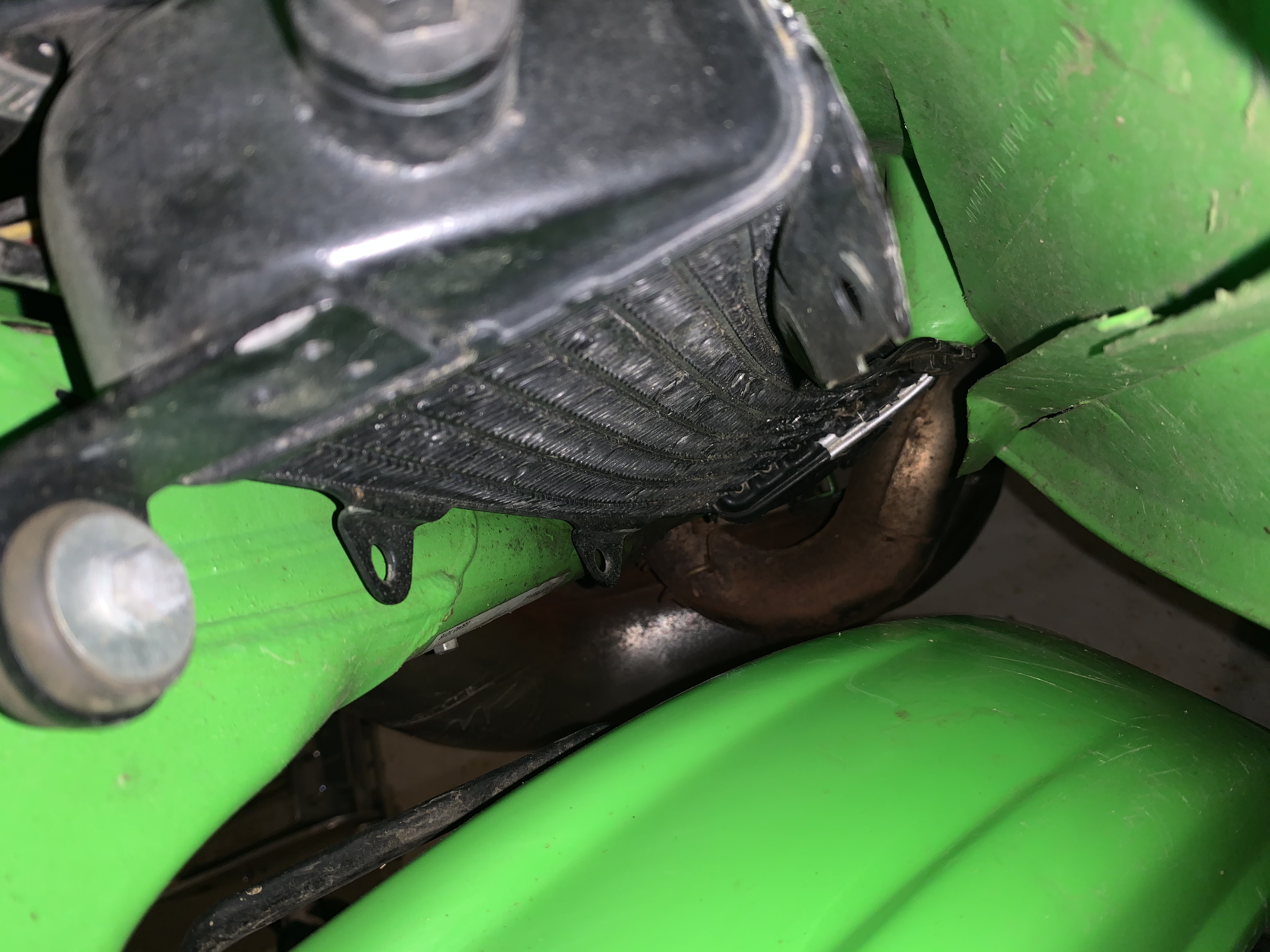

Yep. It looked cracked. It also looks like the bottom of the radiator has been bent backwards and the side bashed inward. I’m surprised it doesn’t leak but it could definitely be restricting the coolant flow.
Posted: 02:40 pm May 30 2021
by emmett
Goofaroo wrote: 02:32 pm May 30 2021 Yep. It looked cracked. It also looks like the bottom of the radiator has been bent backwards and the side bashed inward. I’m surprised it doesn’t leak but it could definitely be restricting the coolant flow.
Heres a photo from above to show the kink better. Seems like a direct side hit, as its only bowed from the side.
Im not contradicting you, just trying to show everything I can, and I appreciate your help very much!

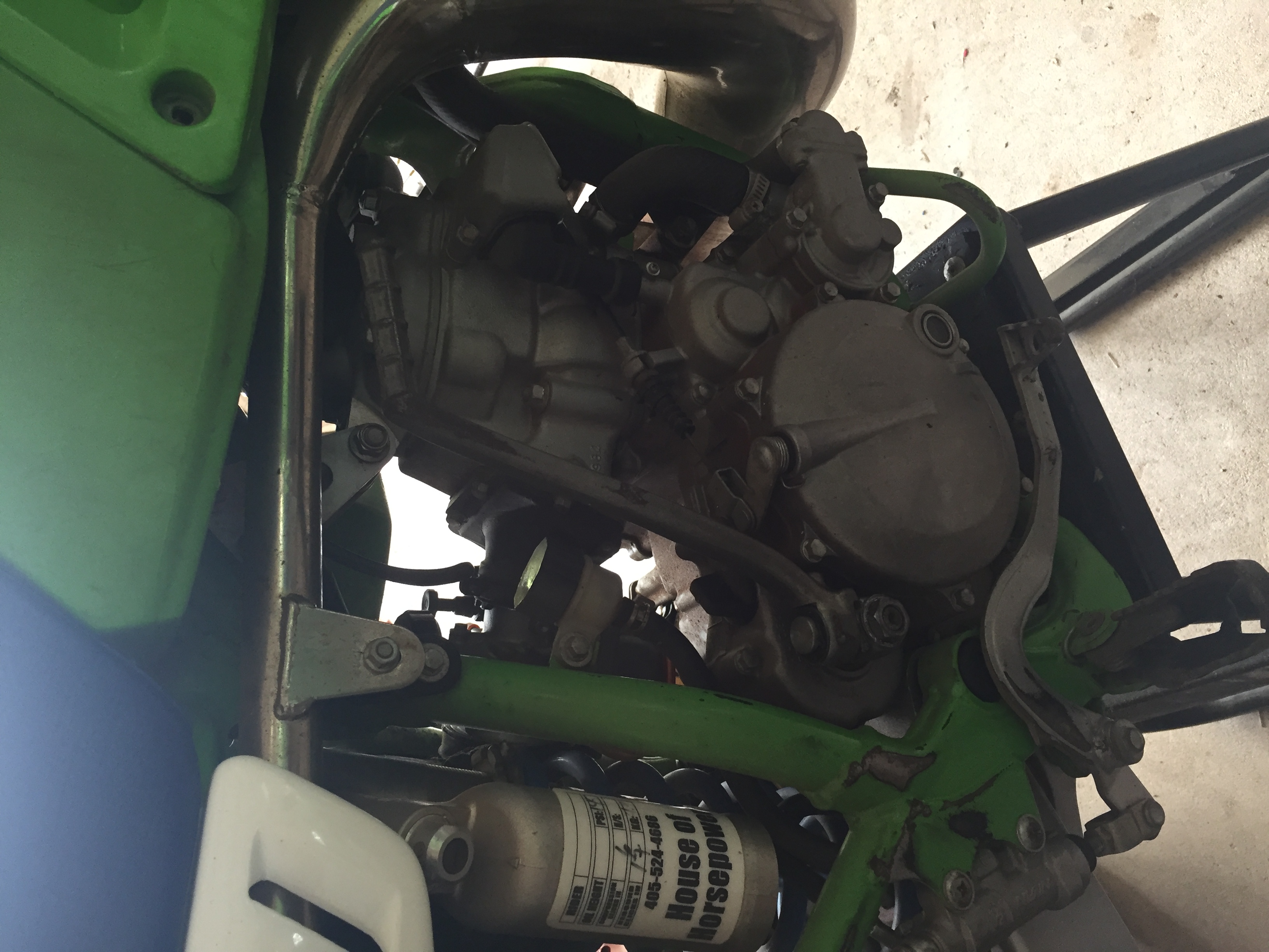

In the video your kickstarter looks like it needs to be moved forward a tooth or two. It appears to be contacting the frame. Is that the rattle you’re hearing?
Posted: 04:00 pm May 30 2021
by Goofaroo
Crappy pic but it should be here:
Posted: 04:04 pm May 30 2021
by emmett
Goofaroo wrote: 04:00 pm May 30 2021 Crappy pic but it should be here:
I definitely see that now. It has been slipping occasionally so I believe I need a new spring and gear. Not sure where to find those except ebay...
Thanks for that, nice catch!
Posted: 04:05 pm May 30 2021
by Goofaroo
It’s probably slapping against the pipe.
Posted: 04:08 pm May 30 2021
by Goofaroo
Are splines shot? Can you not rotate it forward? What “gear and spring” are you referring to?
Posted: 04:26 pm May 30 2021
by Goofaroo
The bike doesn’t appear to have many hours on it. Take off the kickstarter and disassemble the hinge. Remove the set screw, the spring, and ball. Clean everything very thoroughly. Grease everything while assembling and then adjust the spring tension on the ball by turning the set screw. When it feels right and gives a satisfying click when folded in put it back on the shaft in the orientation shown in my pic. Most likely your problem will be solved and your starter will operate as new.

Goofaroo wrote: 04:05 pm May 30 2021 It’s probably slapping against the pipe.
no its not touching the pipe. the rattle/pinging im hearing seemed to be consistent with the firing of the motor, but im not ruling out chain yet, as that is a consistent noise (not with motor, but still consistent).
Posted: 04:40 pm May 30 2021
by emmett
Goofaroo wrote: 04:08 pm May 30 2021 Are splines shot? Can you not rotate it forward? What “gear and spring” are you referring to?
I cannot rotate it forward. I was referring to the kickstart gear and the spring that gives it tension. I have heard that the gear will tend to wear and slip, or that the spring will not hold enough tension. I havent dug into it yet so my understanding of how it works is minimal...

Pulled the screw, spring, and ball out. lever wont slide off. It slides up but gets stuck on something.
I decided to try and remove the bolt holding it on, which is also proving to be stubborn. tried some heat but afraid of what ill fry around there.
Wish me luck, and hope i dont make this worse...
Posted: 06:04 pm May 30 2021
by Goofaroo
I assume you removed the spring clip and the washer that holds the arm on? It should just pull off but I’m guessing yours has never been serviced. Work it off of there and clean it thoroughly. Put the assembly back together but in the correct orientation. Then let’s see if that fixes everything as far as your starter is concerned.
Posted: 06:11 pm May 30 2021
by emmett
Goofaroo wrote: 06:04 pm May 30 2021 I assume you removed the spring clip and the washer that holds the arm on? It should just pull off but I’m guessing yours has never been serviced. Work it off of there and clean it thoroughly. Put the assembly back together but in the correct orientation. Then let’s see if that fixes everything as far as your starter is concerned.
Yes i pulled the clip and washer off, but that did not help. I really need to get the bolt that holds the kickstarter on out, but cant seem to do that while its slipping all over the place.
After fumbling with it for some time, its clear that the slipping issue is with the gear inside of the case. I'm not going to tackle that tonight, so ive buttoned that back up for now. That will require a little deeper digging and draining that fresh oil i just put in there... :doh:
