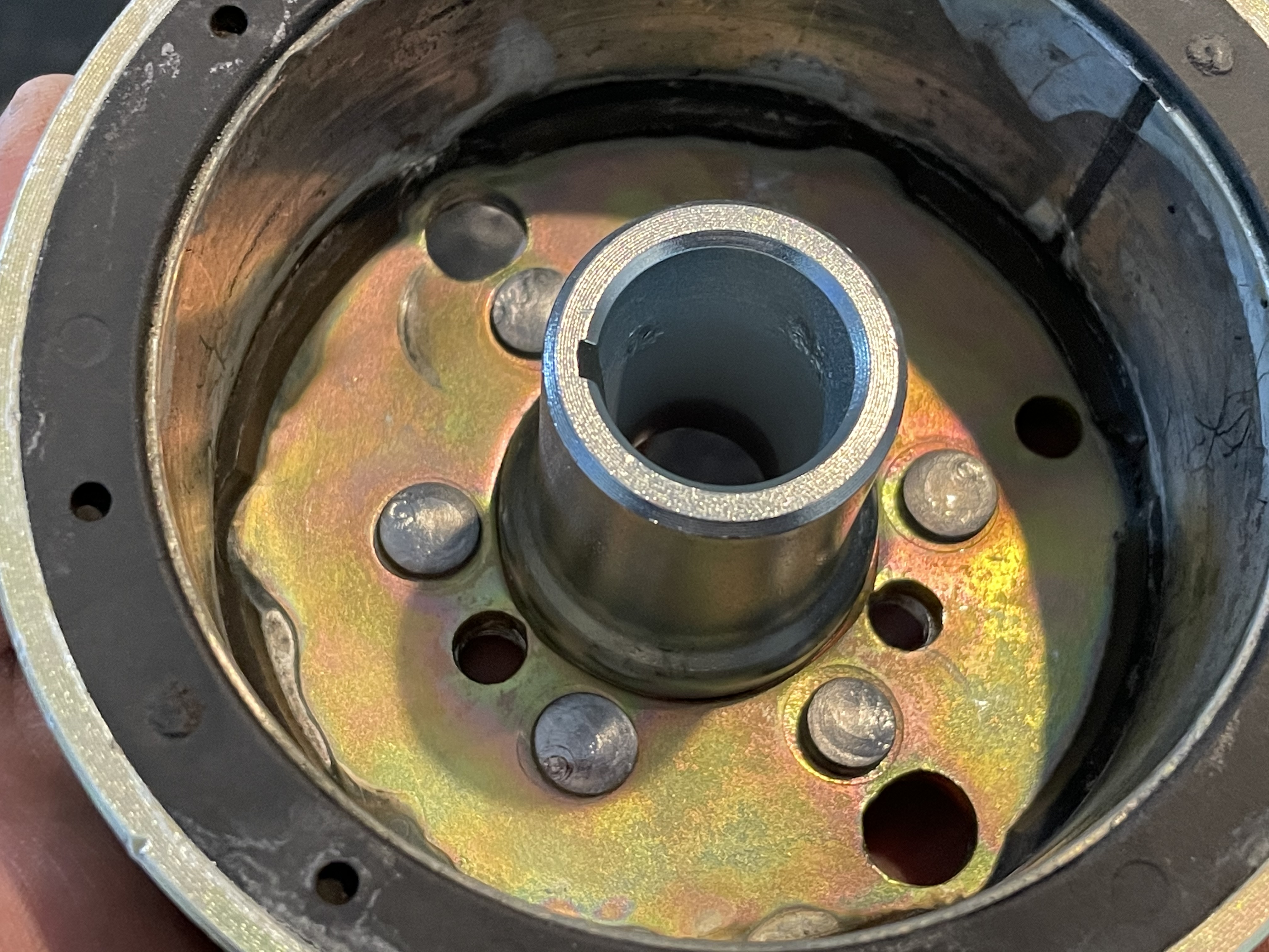

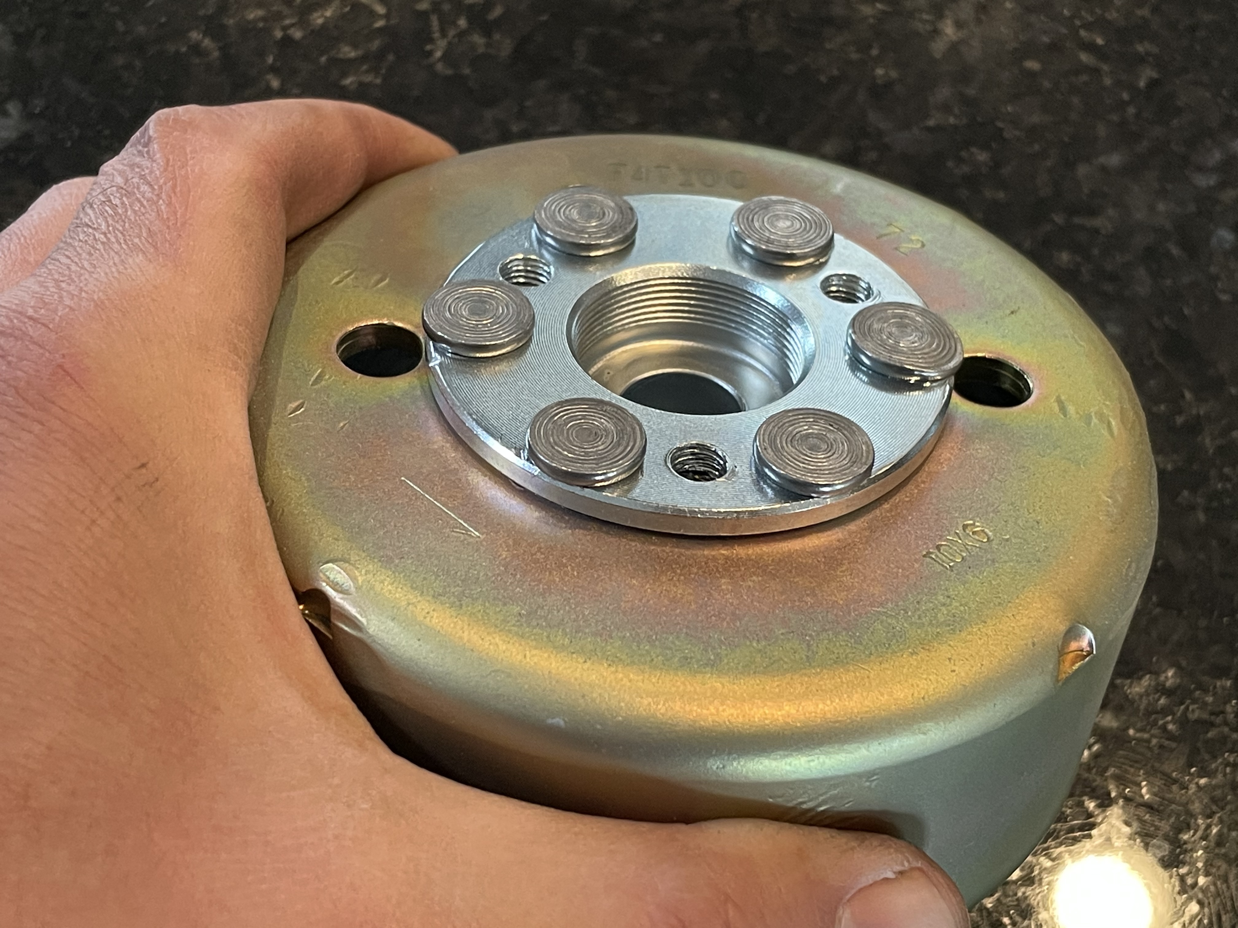

Got the rivets pressed in. Didn’t use heat, didn’t really need to. Only took about 10 tons to get a good “smoosh” on the rivets.
Fit like a glove, test run was amazing. I put WAY too much effort into a frighten flywheel haha

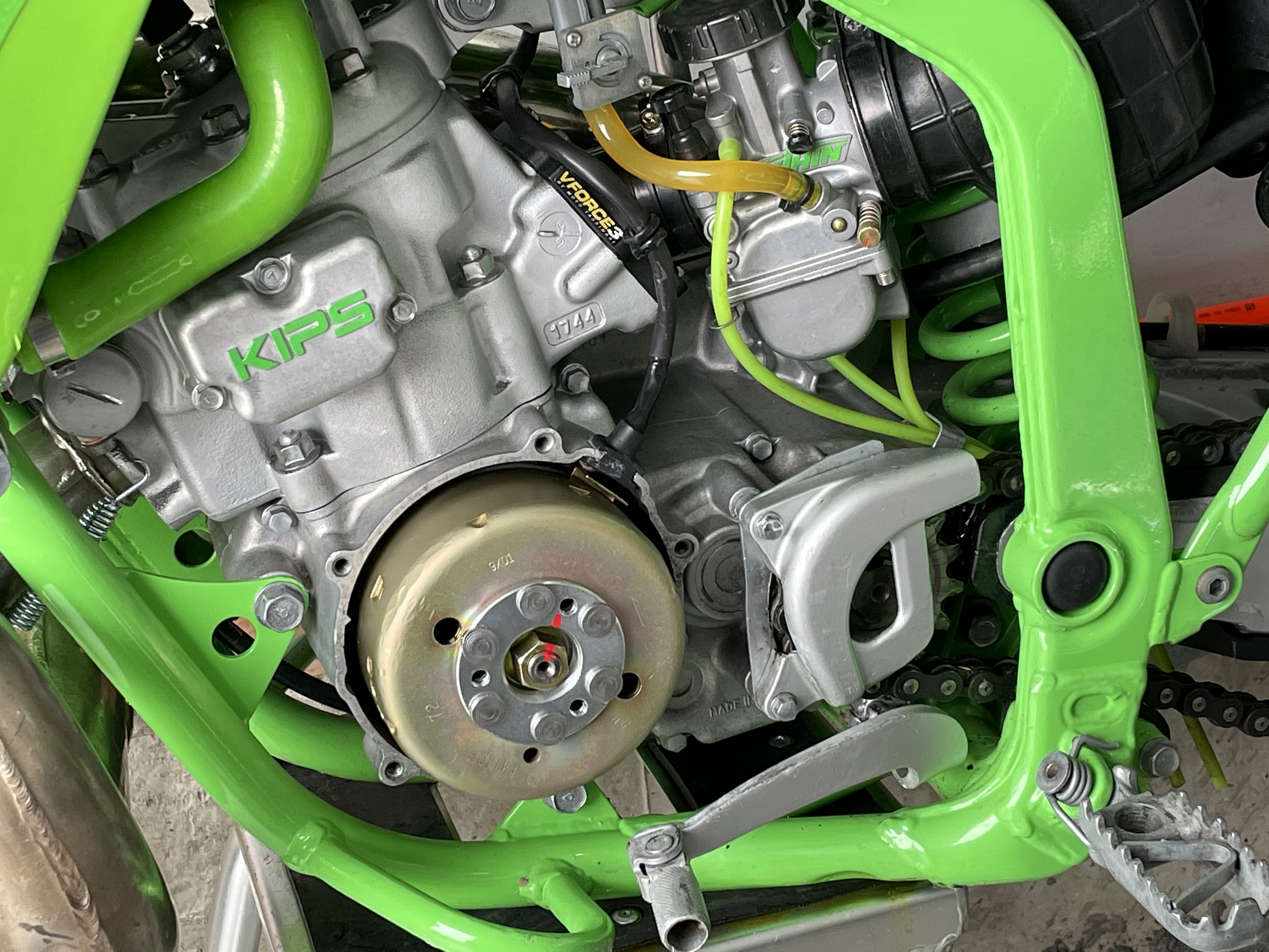

Decided to also tackle my slipping Kickstarter. Diamond filed the teeth, and of course installed a new spring. Haven’t refilled the transmission yet, but on initial reassembly the ratchet action is VERY affirmative. I run a KX125 kicker (see my how-to) and it feels brand new now. Also, have a whopping 2.7 hours on the Wiseco (ProX?) basket and it’s mint.

Man! Nice work. Those teeth are good to go.

Thanks everyone for the comments! As for failure analysis is concerned, I'm guessing somehow the flywheel rivets coming loose must have caused the flywheel to vibrate enough to shear the woodruff key, and then it spun the nut off. I'm lucky I caught it in time! I wonder if the increased "load" on the flywheel from my beefy lighting stator had something to do with it? Although I don't imagine it could be that much... It's a 21 year old bike after all, I guess things are bound to wear out. Hopefully my rivet trick helps someone else who may have the same issue, as the flywheel has long since been discontinued, and used ones are harder and harder to find.
I guess I need to add "flywheel rivet tightness" to the list of annual things to check for failure now!

Age is likely the culprit. Your rewound stator doesn't put any physical load on the flywheel. Curious about electroplating the flywheel, did you cover the magnets somehow or just plate over them? Shouldn't really mater with the thickness that is added, just curious. Great, clean work on everything!

bufftester wrote: 03:43 pm Apr 10 2021 Age is likely the culprit. Your rewound stator doesn't put any physical load on the flywheel. Curious about electroplating the flywheel, did you cover the magnets somehow or just plate over them? Shouldn't really mater with the thickness that is added, just curious. Great, clean work on everything!
I covered them with high temp masking tape it stays sticky when wet. You can see in one of the pics where it lifted and tried to plate a bit.

Posted: 11:22 am Sep 30 2021
by pumpguy
NICE WORK, really NICE WORK.
What's the story on the CS sprocket cover? Never saw one like that before.
