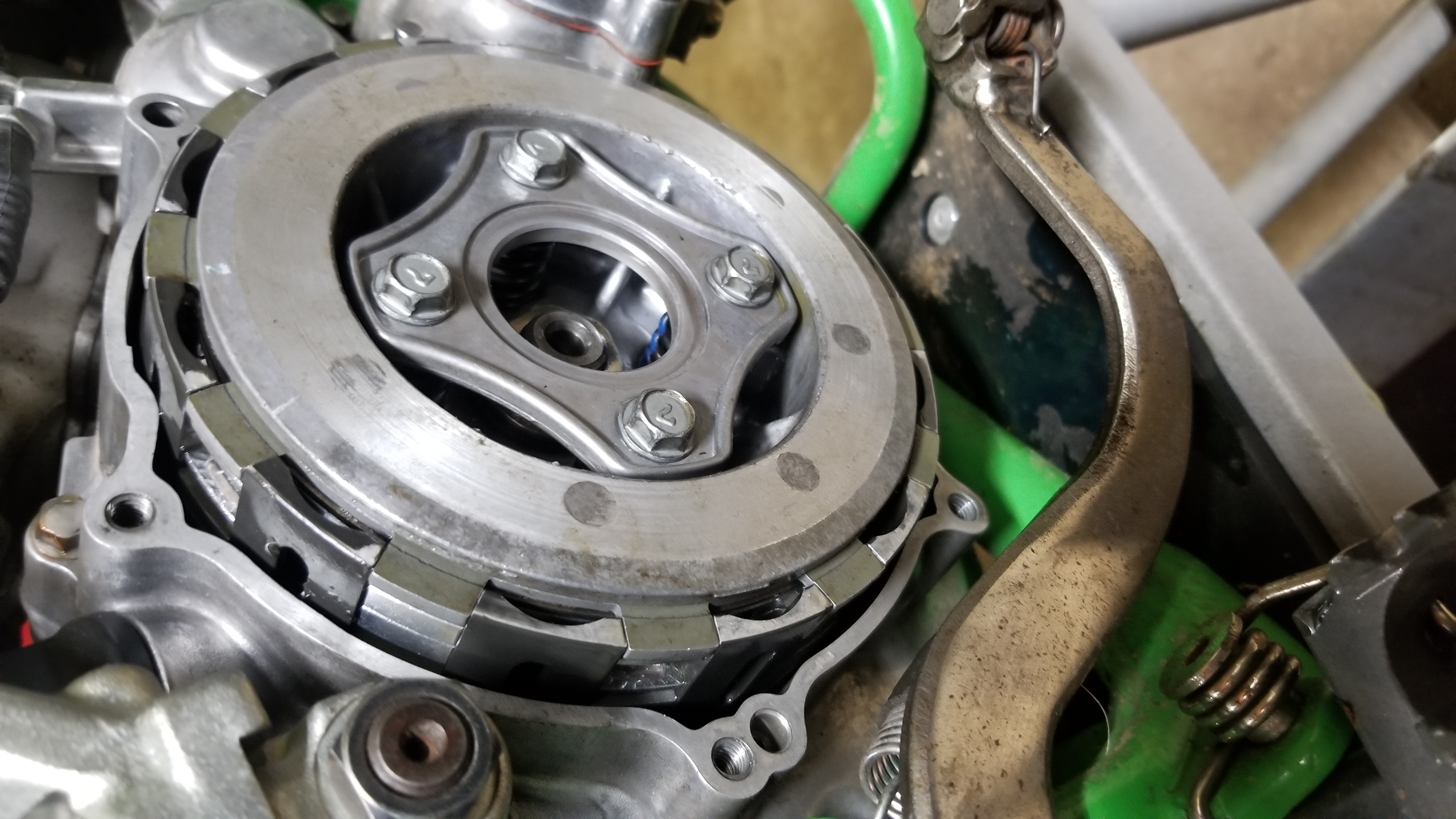

Well I got the clutch plunger spaced out the other evening and got a first attempt at adjustment in today. I'm fighting clutch slip at high RPM in 3rd gear and higher. 1st and 2nd also aren't as snappy as they were before. I'm sure I can correct most of this through dialing in the adjustment. I don't think stiffer clutch springs will help as stock ones held the power fine on my standard clutch.
That being said the setup does function fundamentally as it is supposed to. Nice easy starts from a dead stop on inclines and perfect power application for low speed technical maneuvering. Clutch lever still fully functional. I know all these things can be accomplished with a standard clutch but it's never been possible with the hands attached to my brain.

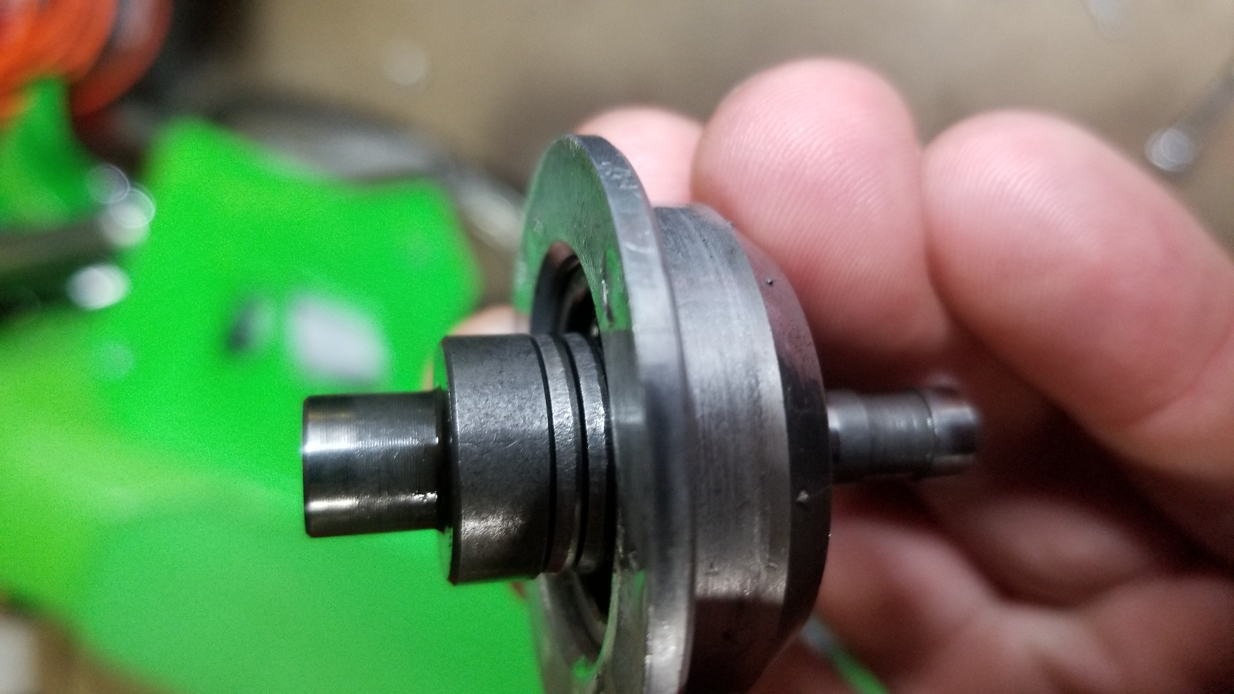

Depth correction. I took measurements so that I can machine a single piece solution for the pushrod.
Fitted up
Fitted up

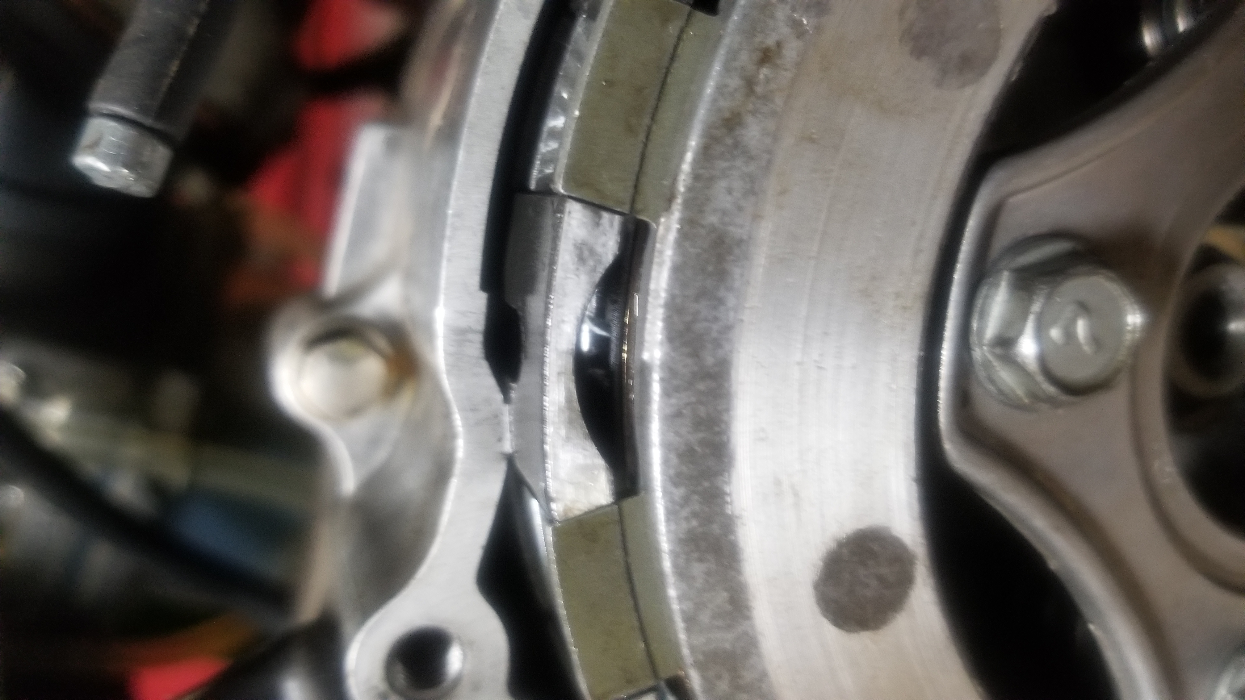

That's nerve wracking. But it wasn't marking the basket after several rotations.

It is very close tolerances. I run mine for several years with no problems other than usual wear and tear. The adjustment[free-play] is very sensitive. On mine, I only had to move the cable adjustment 1/8th of a turn to get the high speed and low speed to work properly. You can also mix the colored springs in the rekluse pack to narrow down your preference. I believe the instructions show this. Again, it is semi-hard to get the adjustment correct, but when you do it is worth it. Good luck!!!

I got this tuned in as best I could tonight. Little grabby at idle but manageable by applying clutch during prolonged stops. It chuged along right up some steep loose bank gravel no problem. I may try some of the lighter weights to see if it corrects the idle grab. It holds the power in higher gears without slipping and it's back to lifting the wheel right through 3rd like before. Difference was about 1/2 turn in on the perch adjustment to get where I'm at.
I'll ride it for a while to see how I adjust my riding. If I don't like it I can always put the original back in as it is fully intact.
