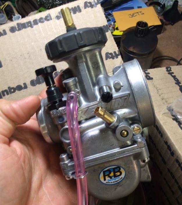

Happy to report that Ron Black is still in business. He's been out of PWK carbs for a while but got very few recently with a "first come first serve" basis. Glad the timing was right for me :)

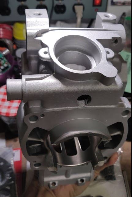

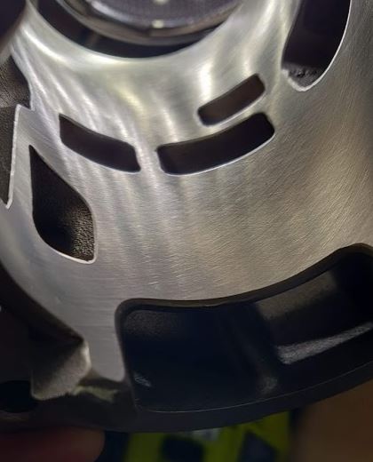

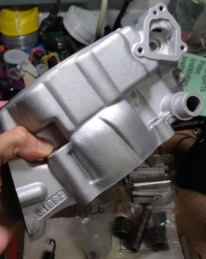

The cylinder came back from Millenium Technologies, they're really doing a great job!

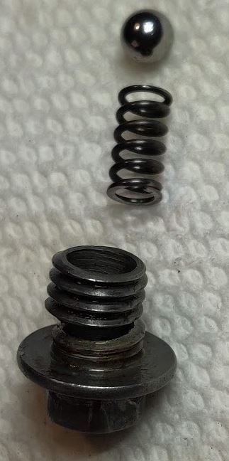

KIPS was deeply cleaned and reinstalled, all adjusted with an apparent normal functioning, we'll see when the engine is running if I messed up or not ;-)
Only thing is the holder screw snapped so I'm waiting for a new one. $17 with shipping, ouch...

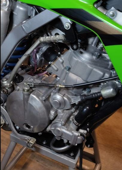

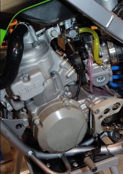

While I'm waiting for it, I started reassembling everything

- Posts: 14747
- Has thanked: 191 times
Re: New owner of nice 04 KDX200
Man! That cylinder is a thing of beauty!
- GATOROC
- Posts: 250
I did the same thing with that bolt and it broke in the exact same place. I'm not sure if it was the previous owner that made it weaker or just me, but that damn thing broke with very little pressure! Where did you order yours from? I just checked on RMATV and it was $12.16 w/ shipping, which is still expensive though.TexasTom wrote: 04:29 pm Sep 09 2020
Millenium sure did some nice work, and glad to see that you picked up an RB carburetor! Let us know how it runs after getting everything together.

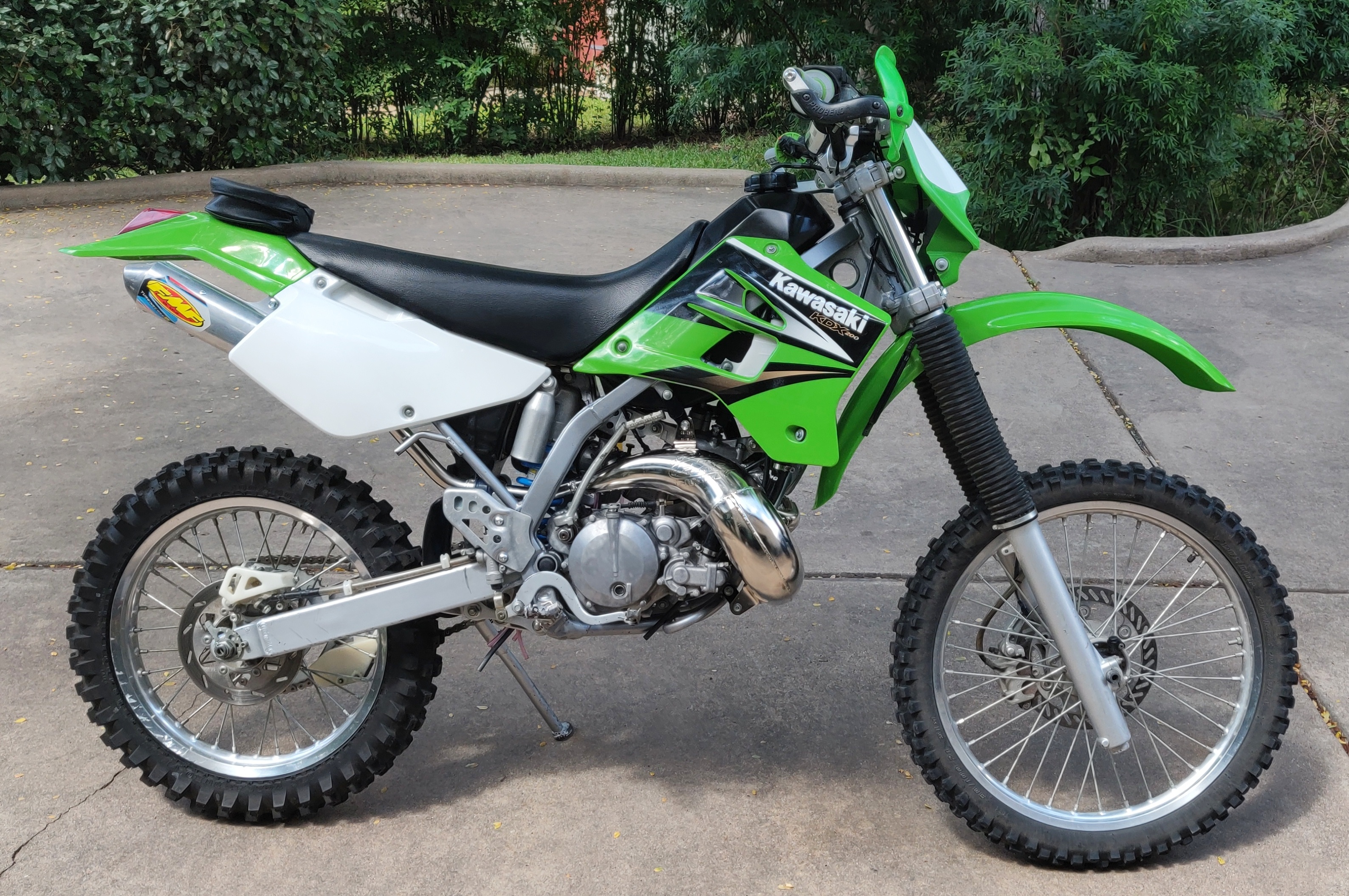

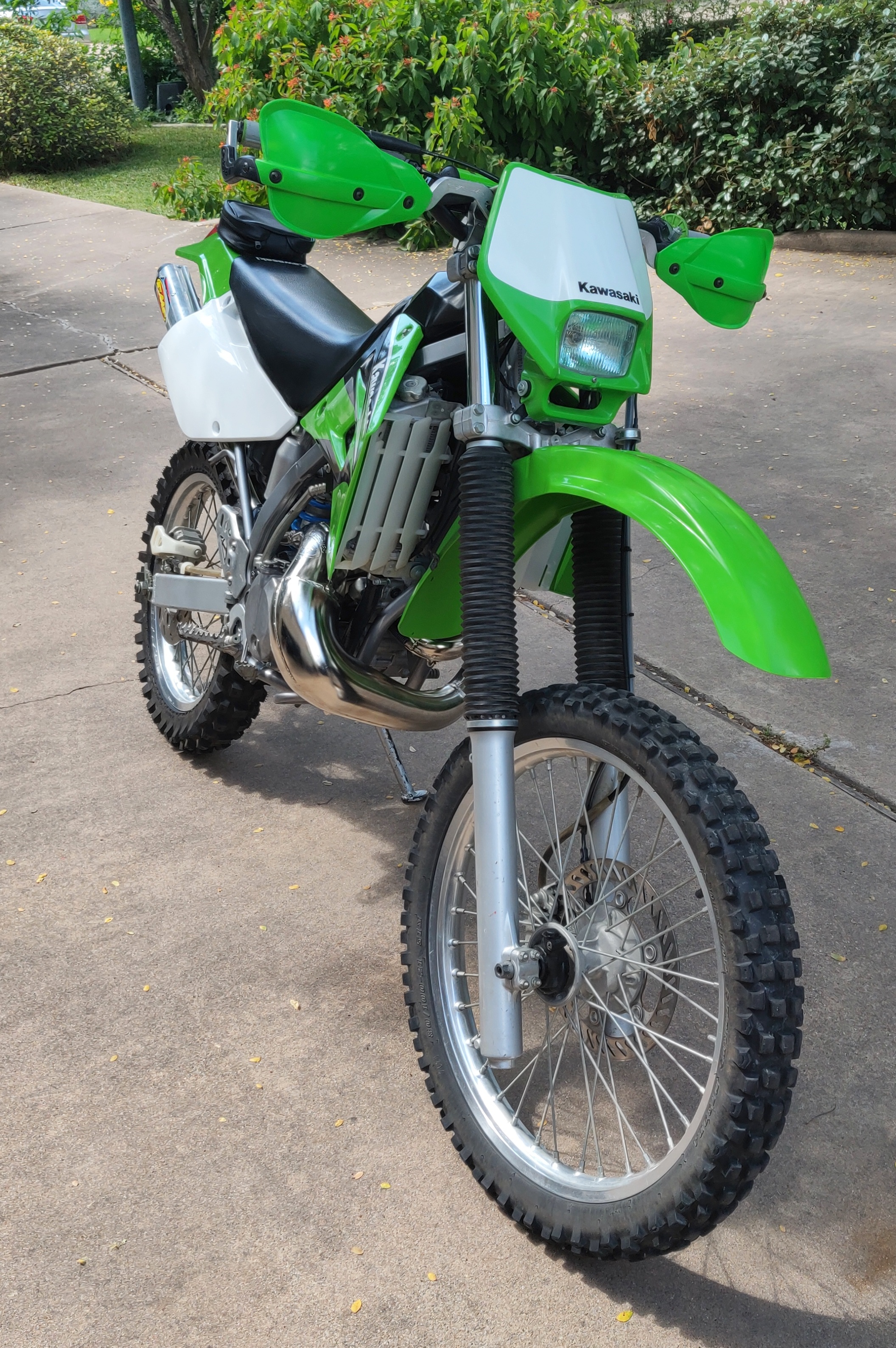

Restauration is complete

I did the recommended break-in procedure and now I need to adjust the carb.
The carb was set by Ron with 152/40 CEK-3 and 7/16 turn out from closed.
First try today with 89° and 60% humidity.
It didn't idle and the throttle response was slow, with what I think is bogging.
At 2.5 turn out the throttle response was better and I got it to idle. But it seems that it takes a long time to rev down to idle.
Maybe I'm wrong but between the bogging and the long idling down I think I'm too lean.
Anyway, I'll try different things, one at a time, lowering the needle clip, 42 PJ etc. We'll see, I guess I need to learn that like anyone else ;)
- Posts: 14747
WOW! Very clean KDX. If you are 2.5 turn out, it is time to try a different pilot jet.
