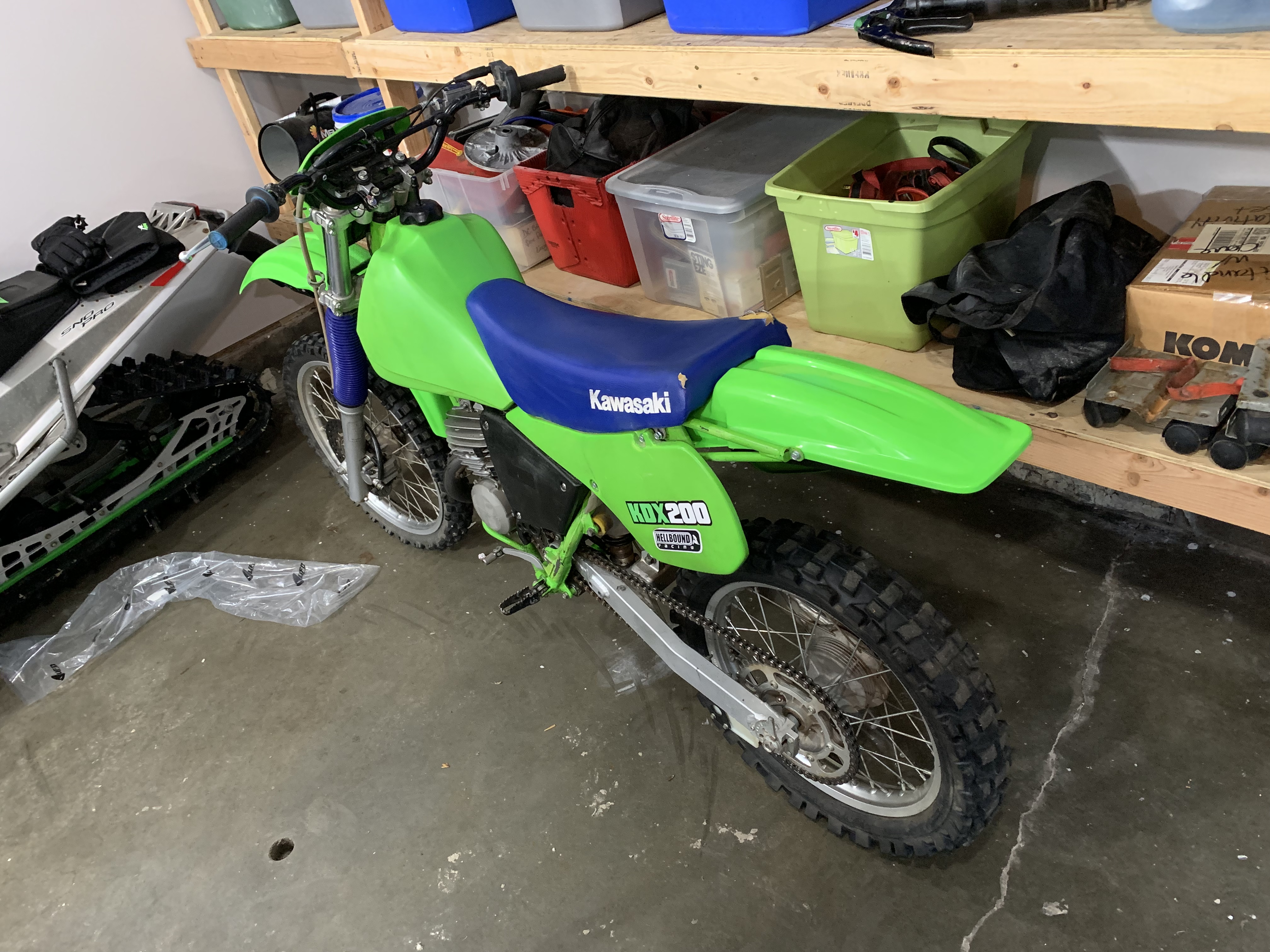

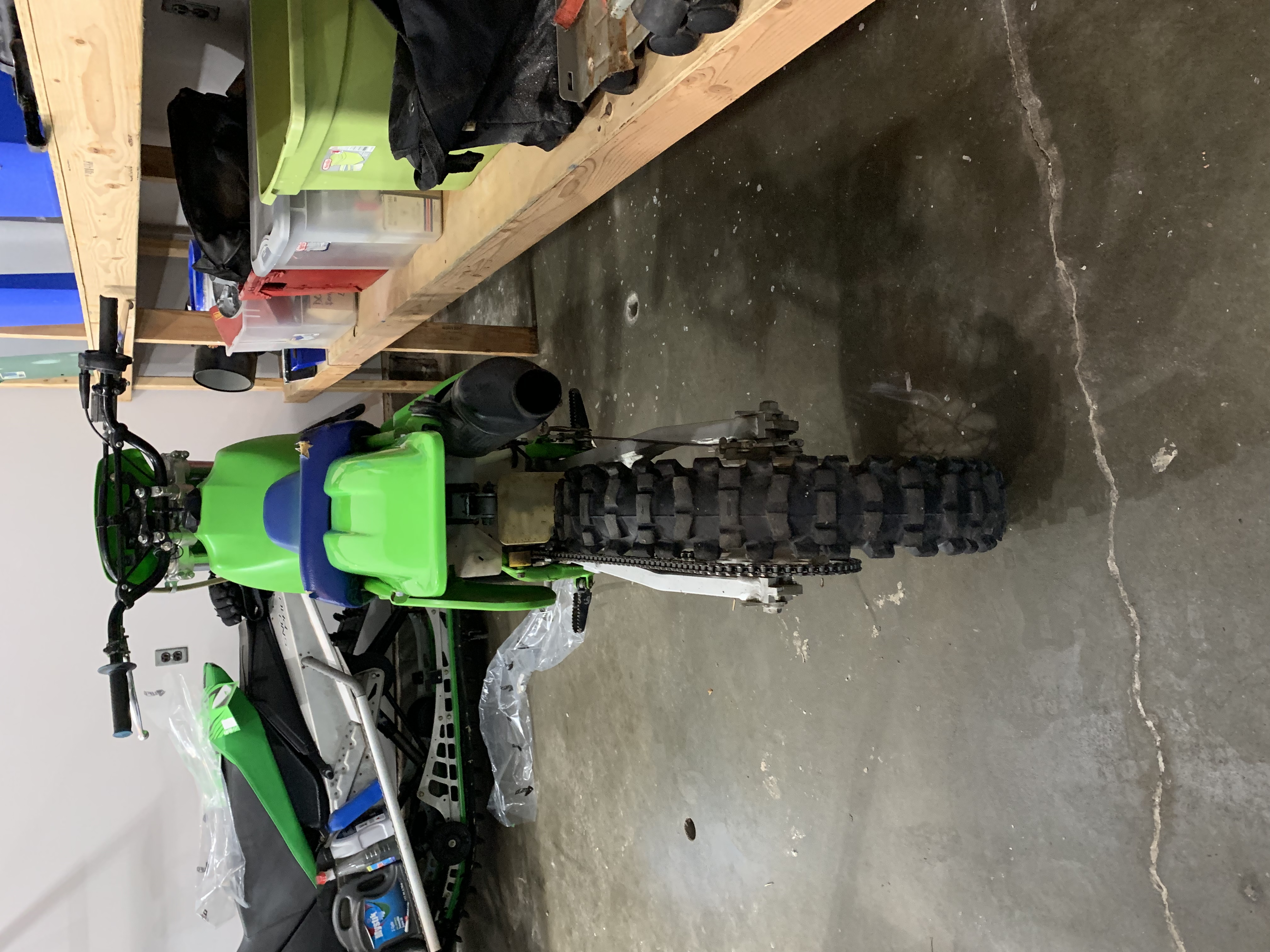

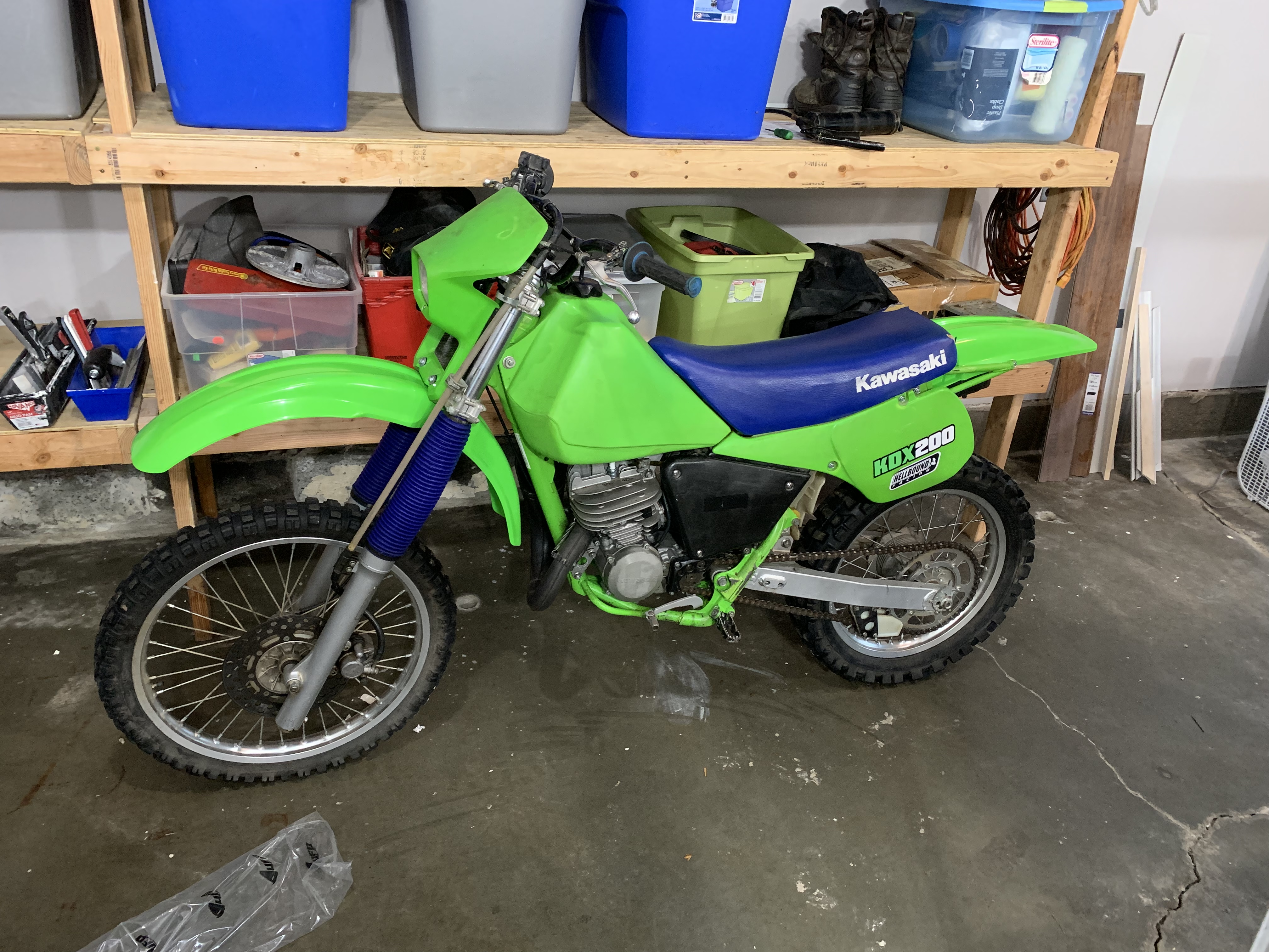

So, got some time with the bike this weekend. Installed the new fenders, fork boots, air filter, engine brackets, new levers and removed a bunch of unused wiring. This is the result so far.
The engine brackets did make a noticeable difference in vibration. Feels normal now. The headlight was missing the harness going to it so I just left the normal engine related wiring connected and secured the unused lighting wires to mess with later.
I did notice the upper bushing/bearing in the rear dogbone is hammered out though... the bolt moves a good 1/8”+ in that joint when I lift the bike up. Will need to pull the linkage apart one night this week and check the rest of it out.
Found the upper front rubber mount for the pipe had separated... guy threw on some zip ties to hold it...
So I removed the works and drilled through both plates and the rubber isolator and put a bolt and nut on it. Should hold now.
Still have to install the kill switch and grips, new seat foam and cover, exhaust gaskets and springs, kips rod oil seal and chain sliders when they show up, but it’s starting to come together.
Then clean and check carb to make sure settings are factory, add fresh gas with proper mix, change trans oil, oh, and swap out rear tire. Then I think it’ll be ready to ride.
I’ll post more as I get things done : )

- Posts: 14747
- Has thanked: 191 times
Re: Parts recommendations for 88 KDX 200
Dude.
That looks nice.
Check "All Balls" for a rebuild kit for the link. "heim bearings". OEM are SUPER expensive IF you find one.
That looks nice.
