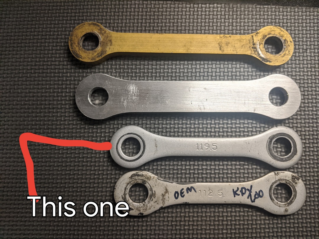

BTW- I did lower the bike about 2". I used OEM dog bones from my son's KLX 250 that I had laying around. THANKS!
Great info on the dog bones. My kdx also has the 119mm dog bones so finally I know where they came from
Glad to hear I was able to help out! Now if I could only remember where the aluminum ones came from and what bike they were meant for. Even if they don't get used for dog bones, I'll eventually put that metal to use somehow.
