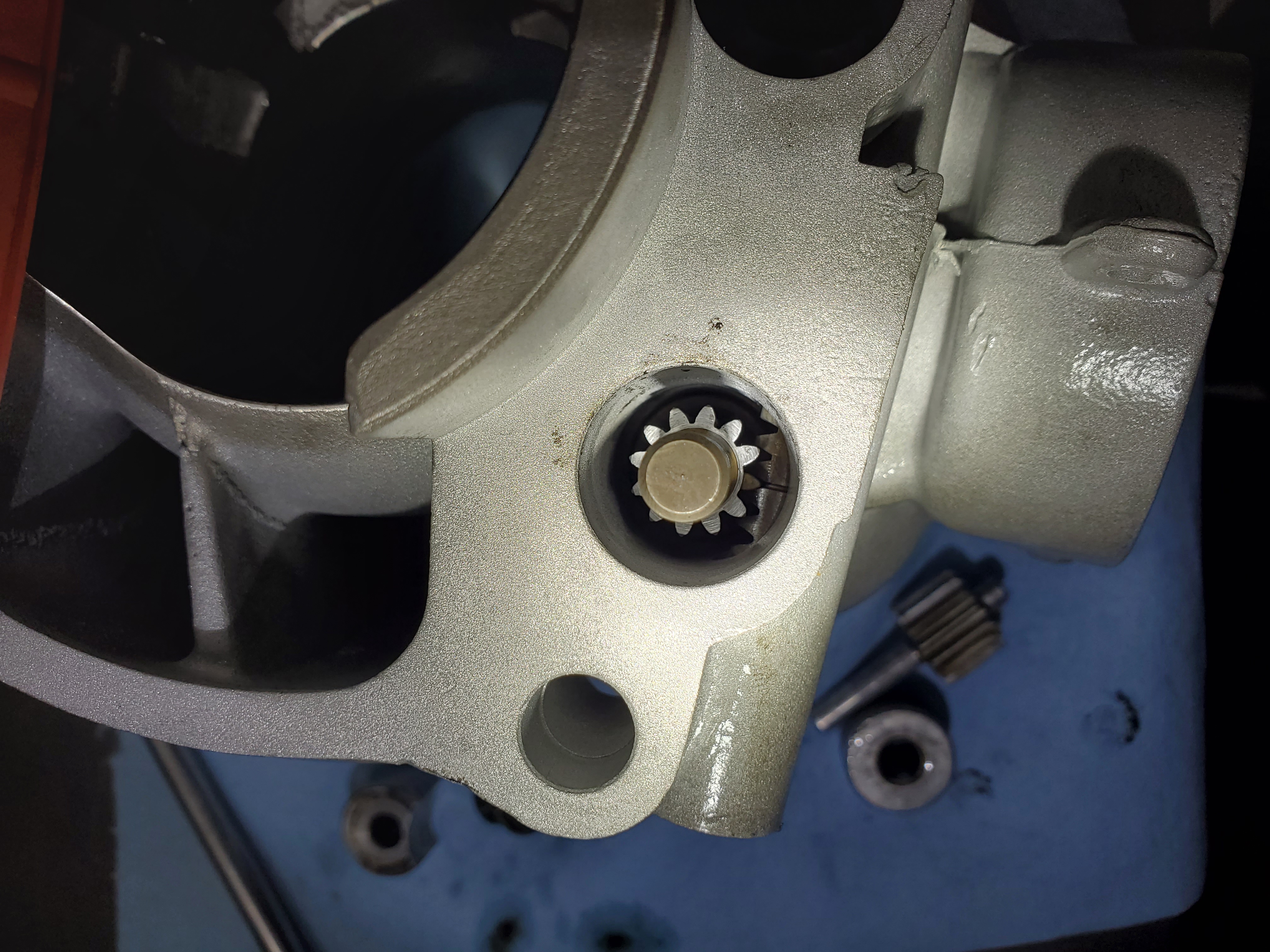

The paint is stripped during the process. They pretty much all look like that.

Understandable, I'm leaning towards clearing. I figure I'll do a cosmetic resto in the future and blast then clear the covers/ cases, guess this will give me a trial run to see how i like the clear vs silver paint.

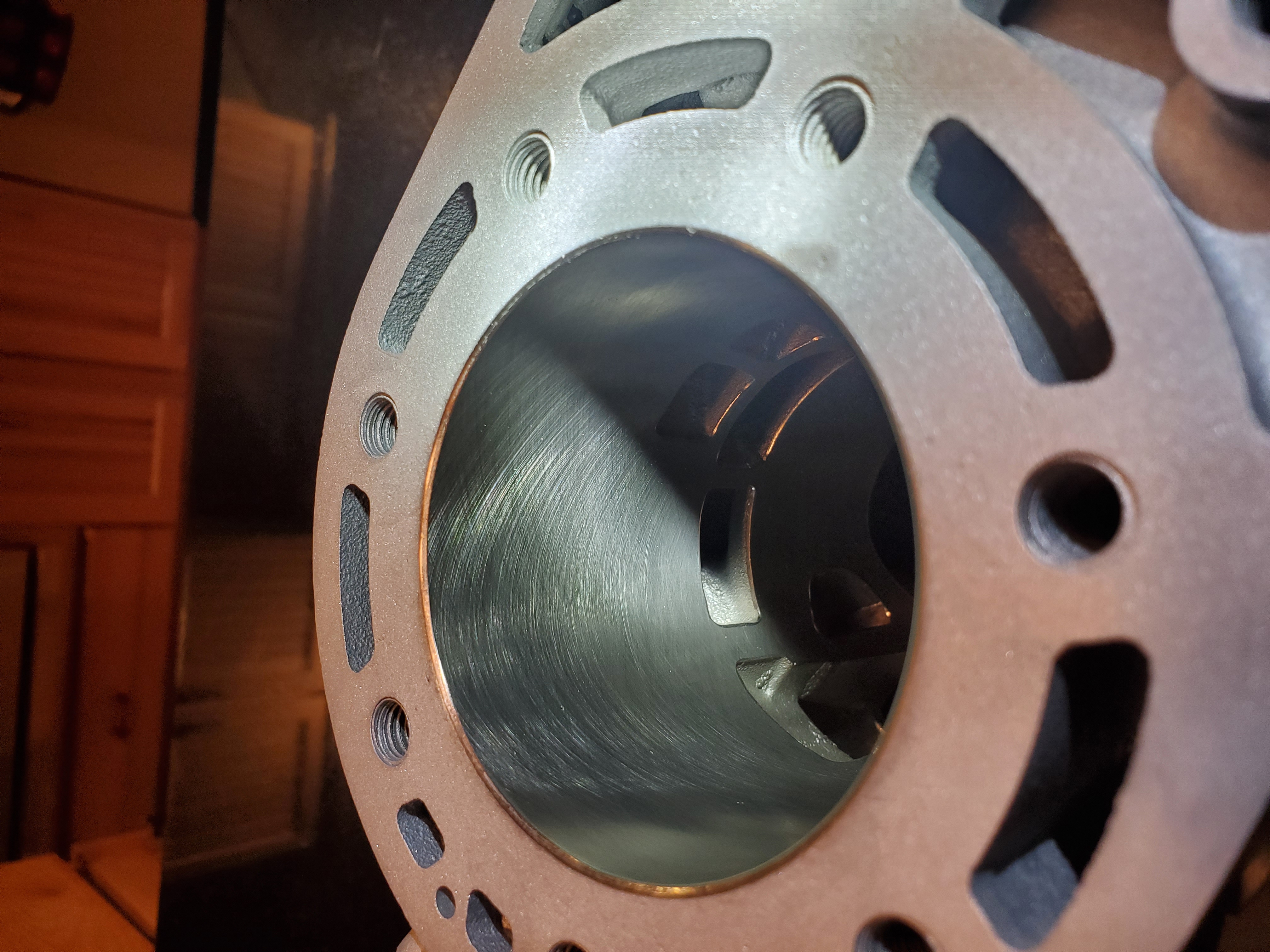

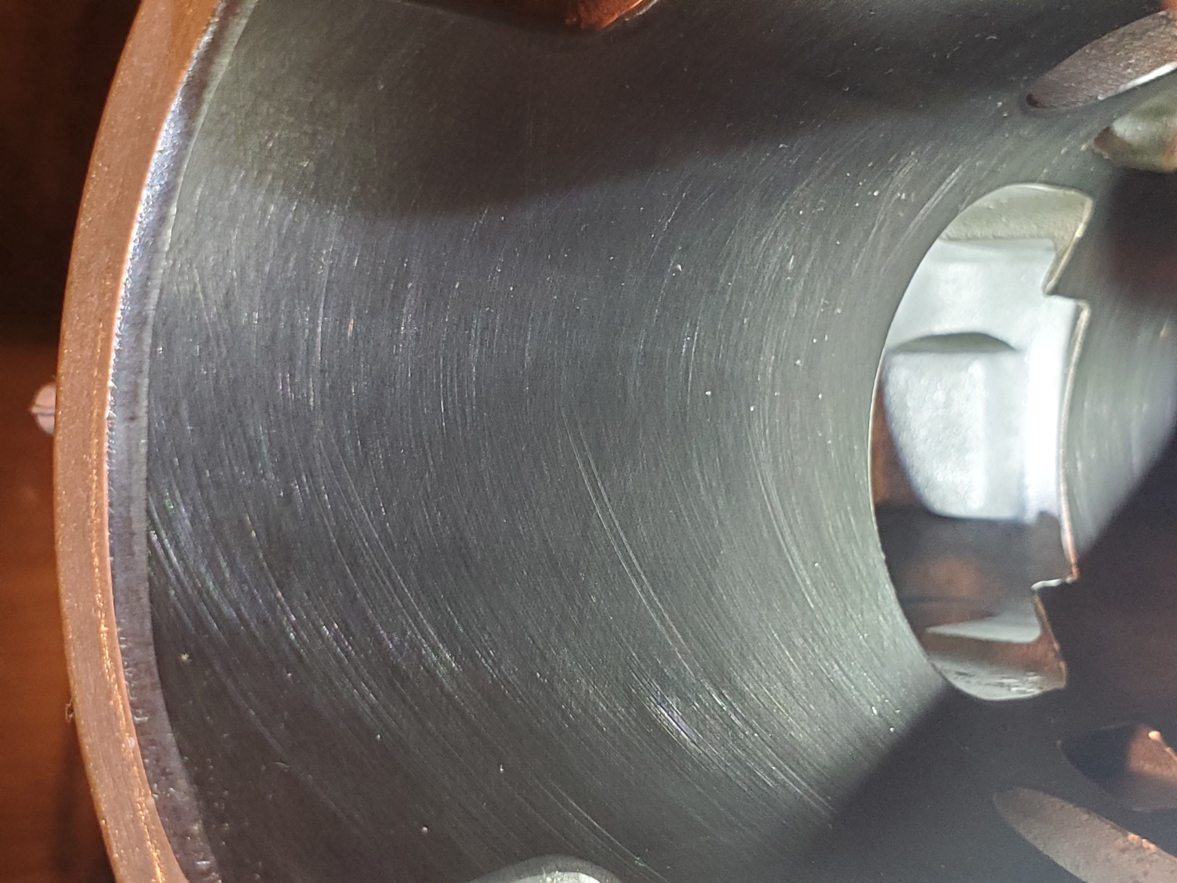

For future searches:
This is a beautiful example of aftermarket plating. Kawasaki OEM Electrofusion coating does NOT have the well pronounced cross-hatching shown here.

I was a little curious about that. Absolutely no sign of crosshatch when it came apart.

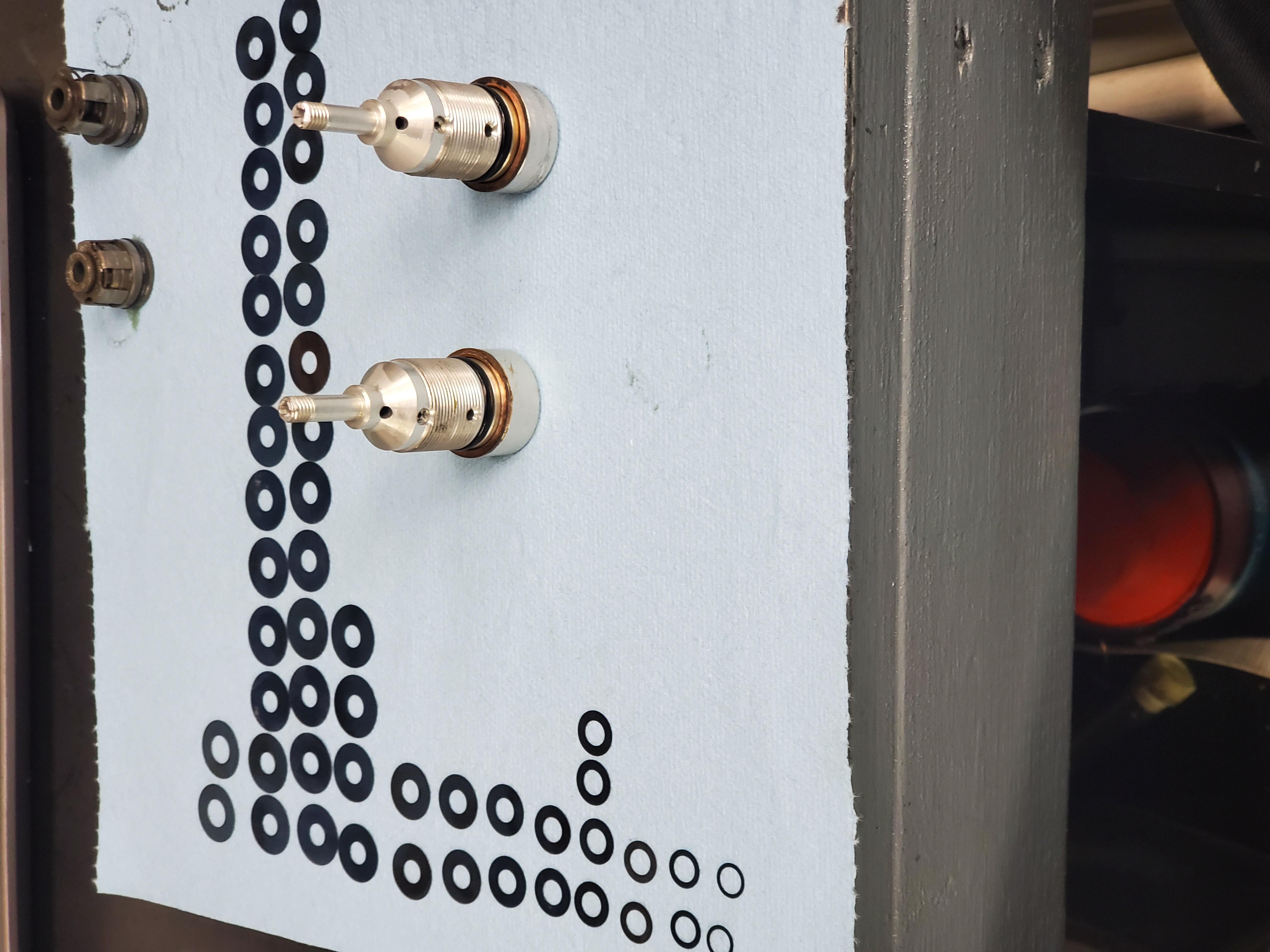

Very painless transaction with millennium. The website that tracks the progress wasn't being updated but that didn't bother me with all that's going on with covid I'm not in a hurry. When i did inquire on the status they were very prompt with a response/ update.

Also want to give a huge shout out and thanks to chad at Sudco International. Very quick responses to all emails and questions. And i know some of it was from home and off work hours. Not expected but definitely appreciated!! I've dealt with them in the past and they're always friendly and helpful.

Thank you for the additional pictures.
I had a NOS KDX175 cylinder one time. It looked smooth. I have a NOS 1989 - 1994 cylinder somewhere. It looks smooth, too. My new 2005 KX250 engine's cylinder looks pretty much the same as your cylinder.

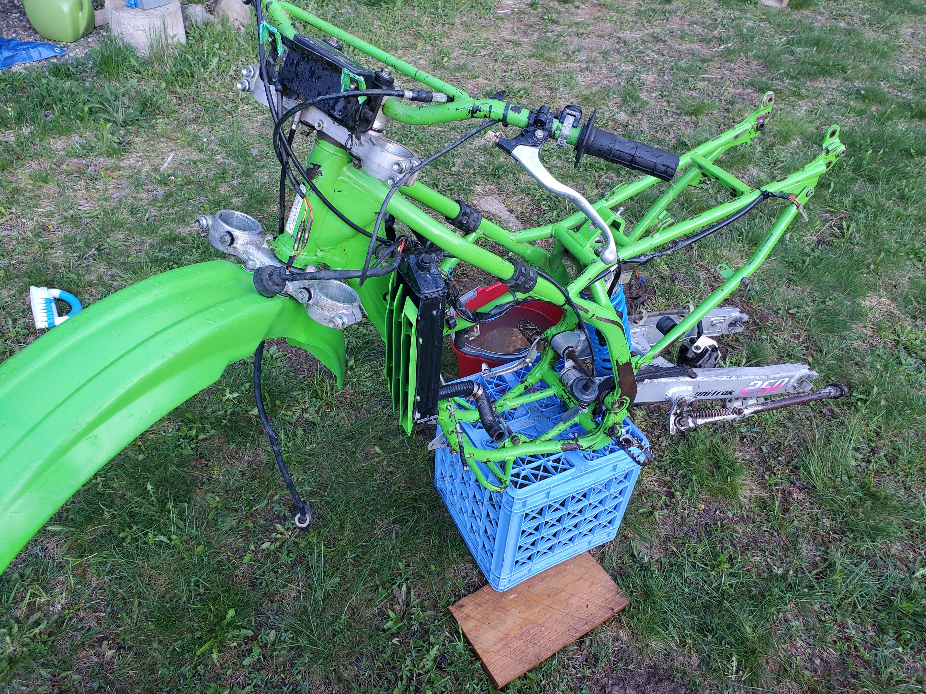

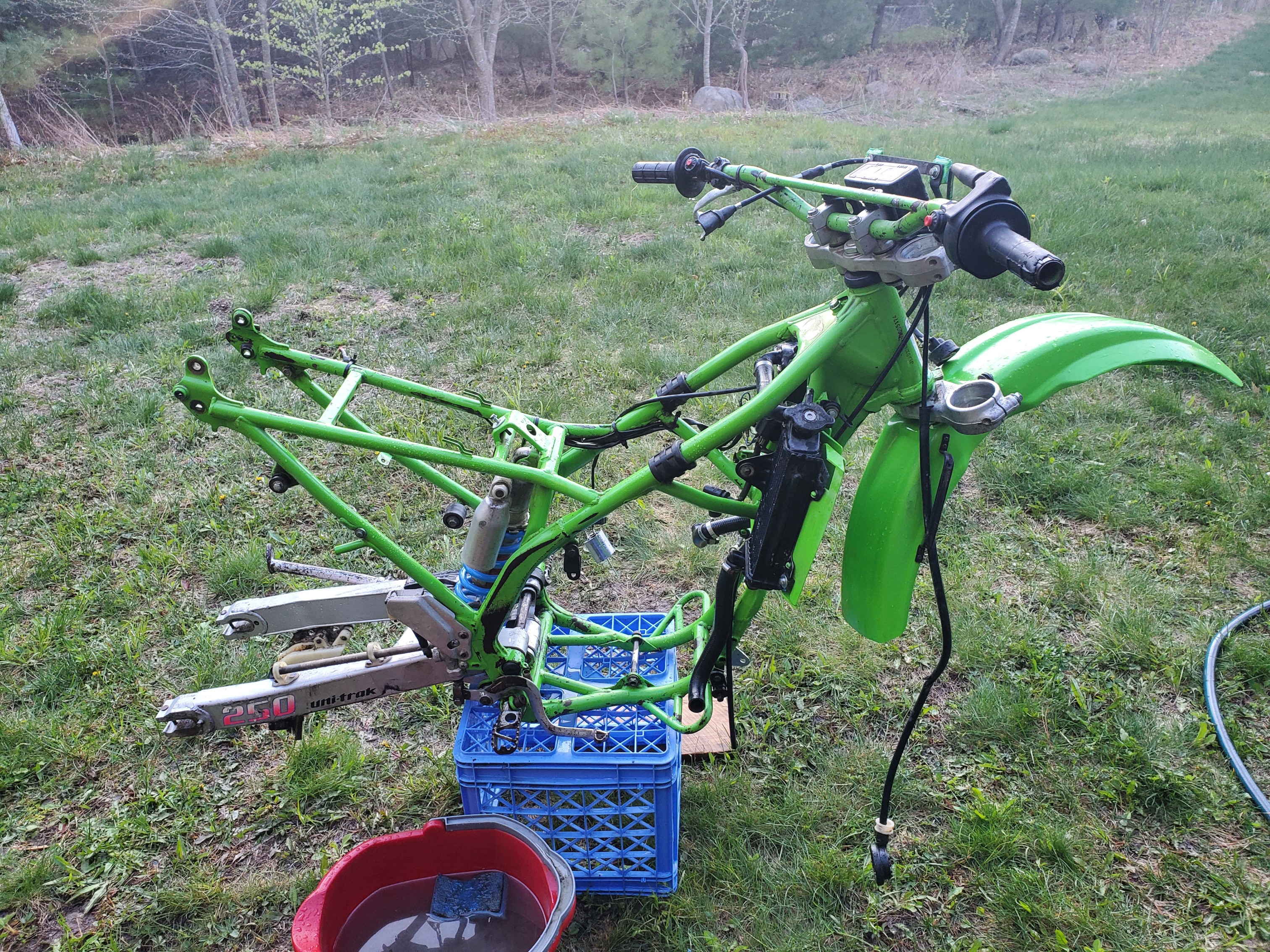

Making progress. Next time this will be a breeze lol. Also i do regret not blasting and clearing everything..... next time! Until then, full steam ahead :supz:
Got her out for a little bath while i could get to the hidden bits, again, regrets on not powdercoating the frame and swingarm but i really was going for function. I'll do the showroom resto in the future.

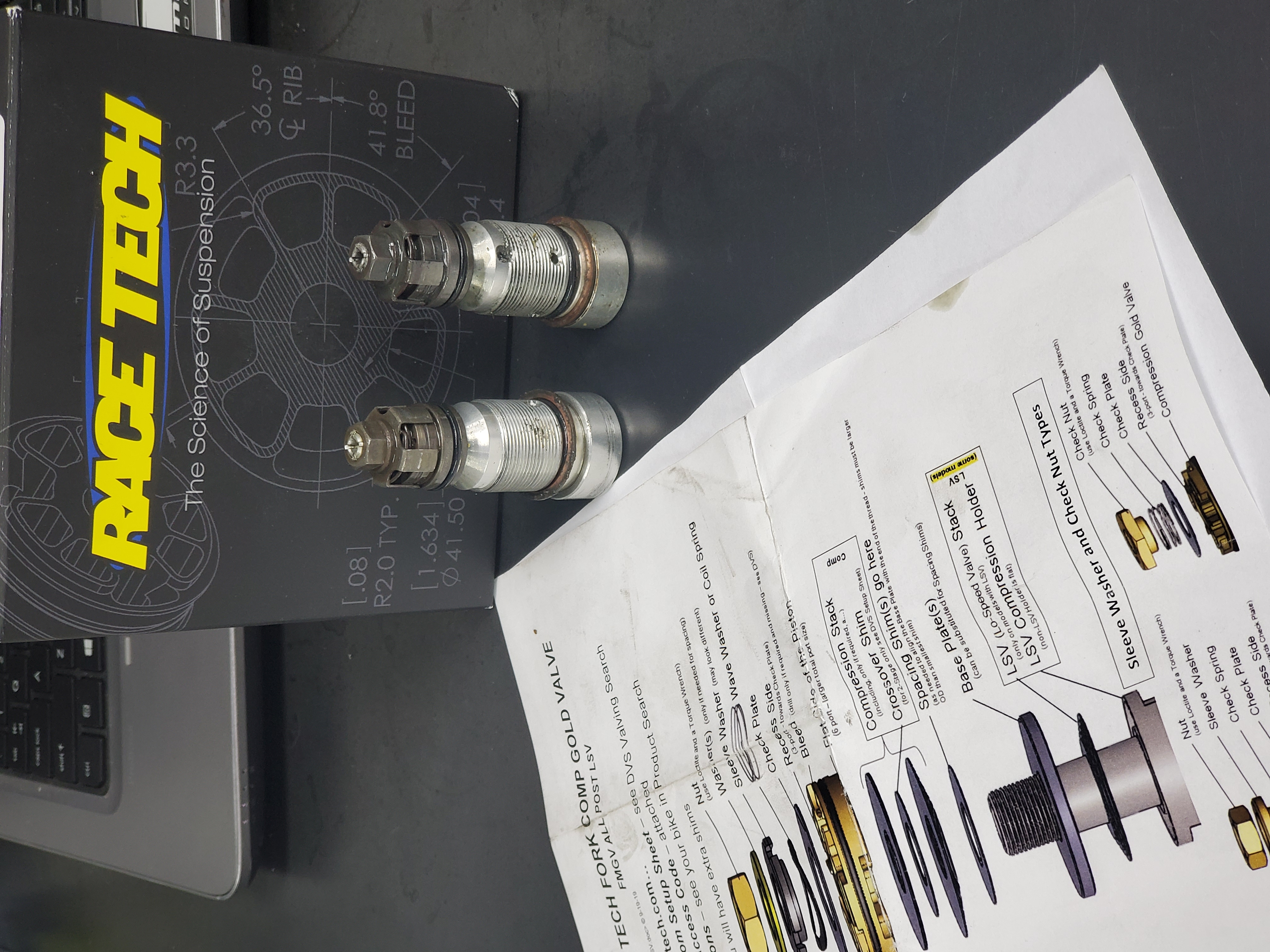

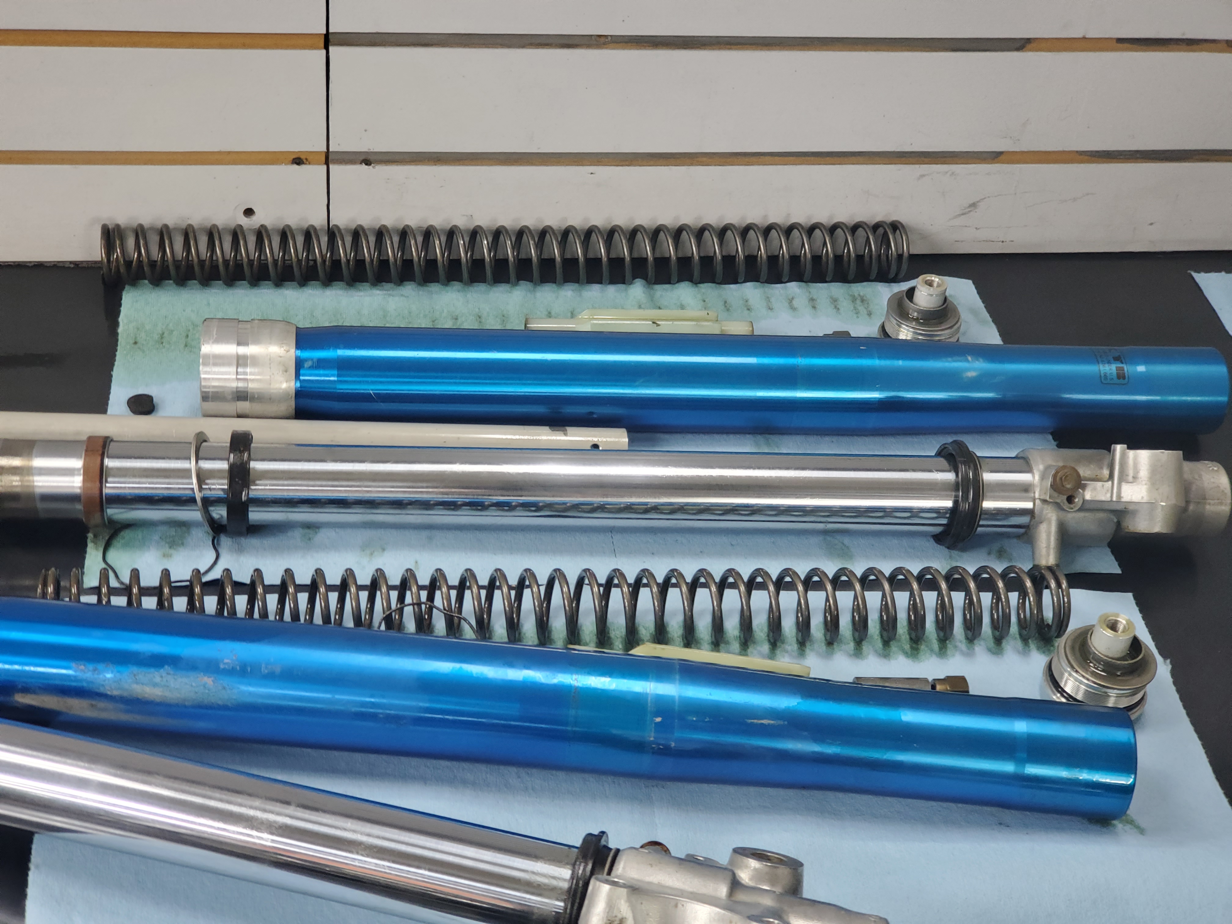

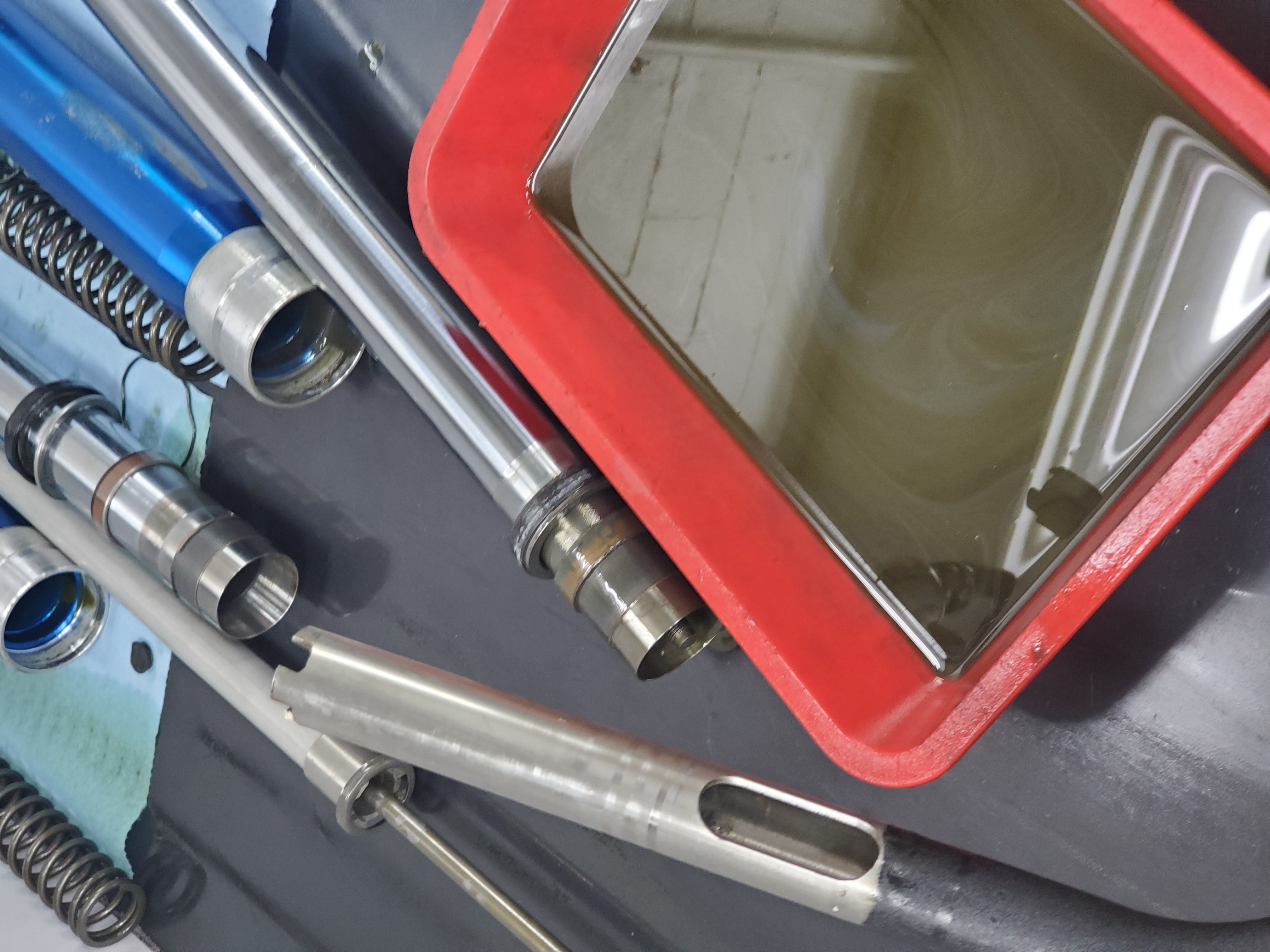

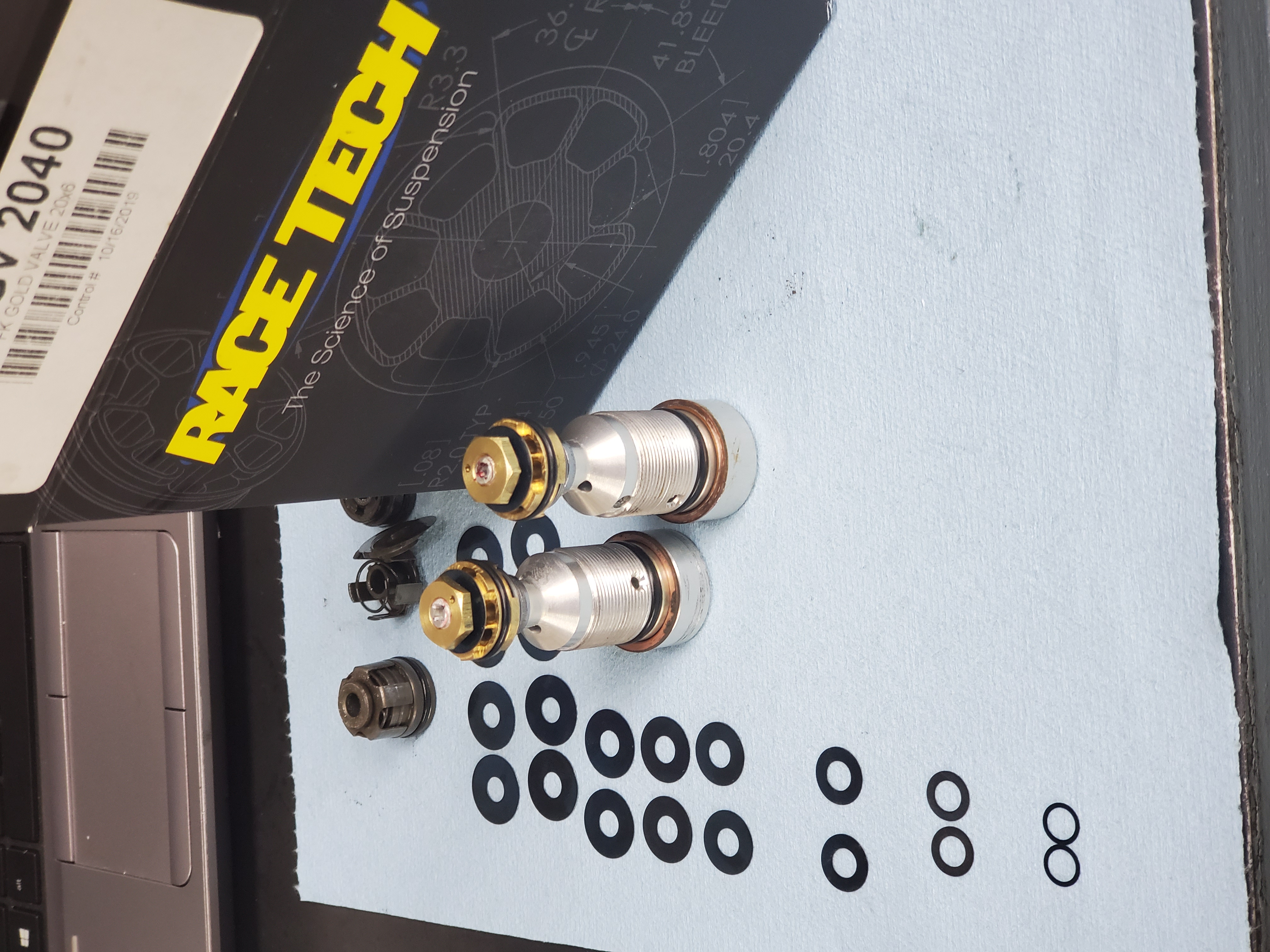

And i made some headway on the forks, just need to decide on oil and get them back together.
Improvised a cartridge holder... and the twenty eight year old oil. :vom:
Out with the old
And in with the new!

QUITE LOVELY!
Awesome gif, too!!
Congrats on the Gold Valves!

Thanks! I appreciate all the encouragement. I'm gonna be honest and say that i never thought/ knew the original forks needed help, i just rode the thing lol. It has always been a woods machine and will continue to be, but i try to learn from the more experienced and figured that since it needed oil and seals, I'd try the gold valves while I'm there. I'm also excited to get it jetted correctly, i pulled my original carb and its got stock jetting, no wonder i fouled so many plugs! But at the time i just assumed the factory knew better than i did and didn't mess with the carb.

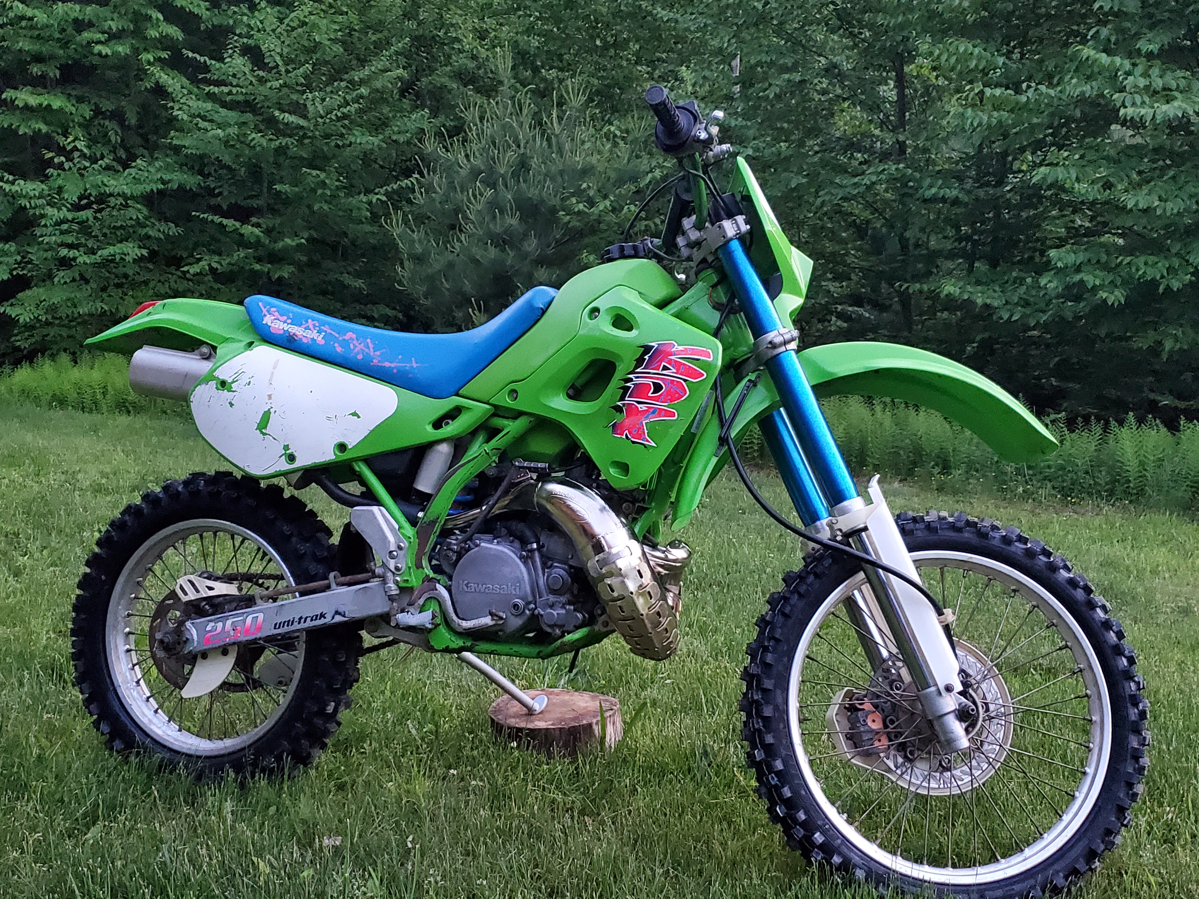

Well it's together!

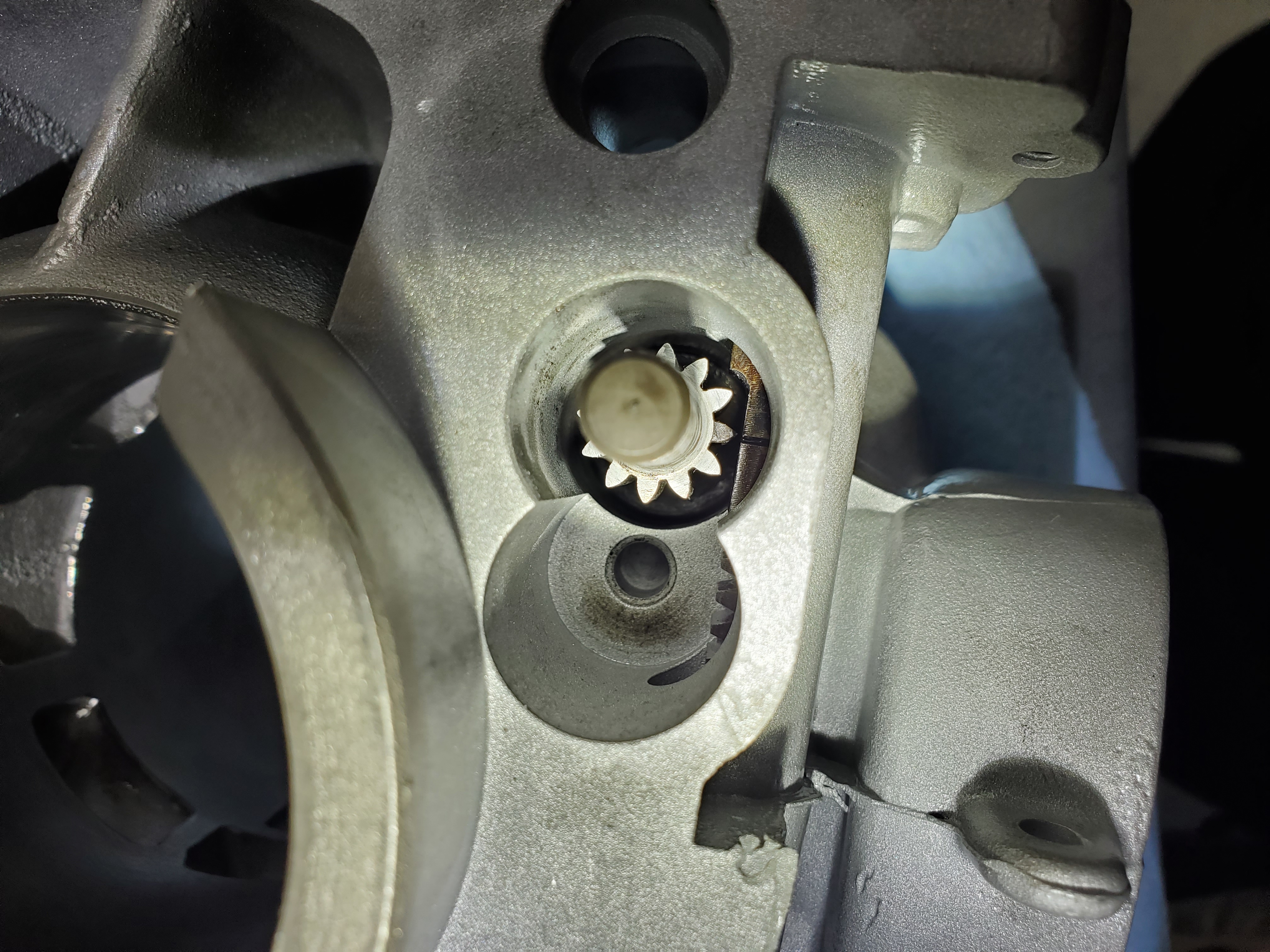

Started the break in heat cycles, and left the rotor cover off because i am having trouble doing a final torque on the rotor nut. Well it looks like the left seal didn't take? :hmm: :doh: There was oil on the ground, and some under the rotor. Quite depressing but it is what it is. I'll try pulling the rotor this weekend to get a better look.

Interesting Goat, I'll have to look into that, i think being in the sun made it worse. I put some gorilla tape on it over night and it doesn't look like it leaked yet. I will be in the lookout for a good replacement tank. Fires on first kick and sounds so good when it's warmed up!
