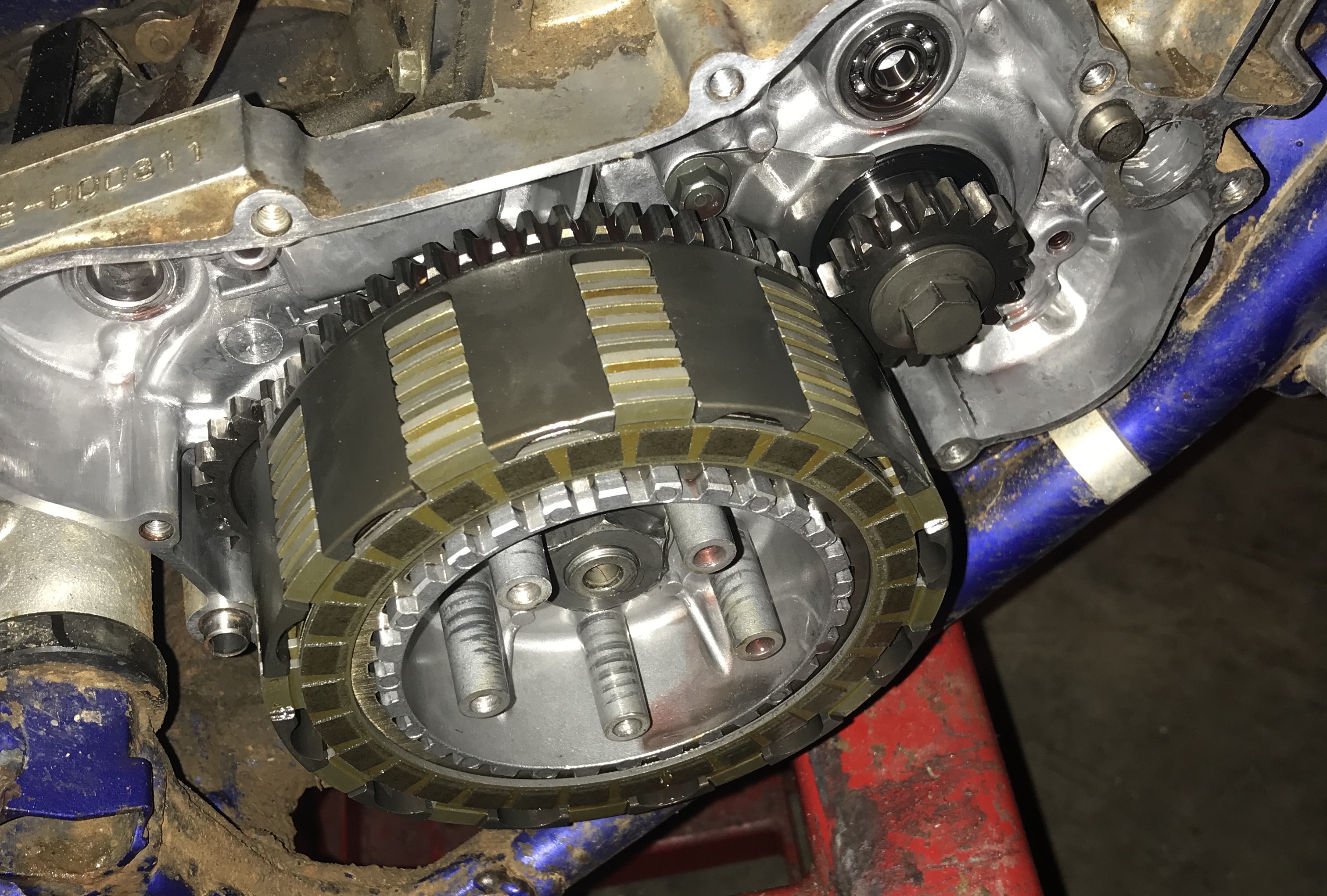

by kdxsully
- AB69A7A6-9E85-4735-9F7F-D515741DF6BB.jpeg (1.87 MiB) Viewed 22366 times
Broke it down some more. Looks like an aftermarket basket. From the photo it looks like I might need plates. I do have a good pack sitting at the house. Right side bearing felt concrete from this side. Feeling optimistic, but I’m not forking over any cash until I know what I have. I was optimistic enough to buy some yamabond.
