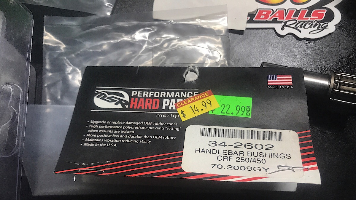

I ended on the MSR Hard Parts - Handlebar Bushings CRF250-450 which is a poly cone that has more of a firm feel compared to the stock ones but not as stiff as the billet ones would be.
First Number) 34-2606
Second Number) 70.2009GY
I will note they were on the slightly smaller size like the Ride Engineering ones Voss posted a picture of - so I just used a set of washers the same OD as the cones to get the clearance needed for the provided curved washers.
I got mine on the discount rack at the local store... so the cones may be discontinued as I can’t find any info on the MSR website about any bushings at all and lots of retailers I found with google search on the two part numbers above show out of stock unknown restock date.
Hope it helps someone!

Oops, forgot to attach a photo of the pack for reference!
MSR Bushings that fit KDX200-H8
I will grab some photos of them in the cone holes so you can see how far they set in - it’s just a few 10th of a mm but that’s why I threw and extra washer on there for clearance and worked out perfect for me! (YMMV - Goooooood luck!!)
