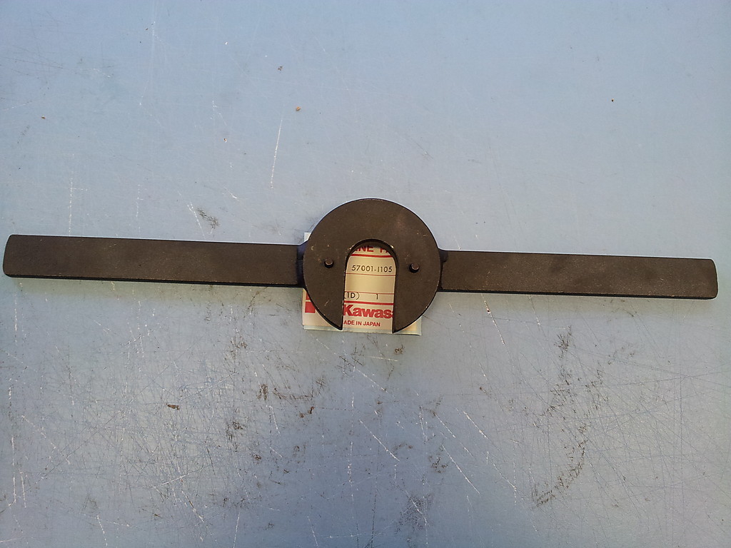

Here's a picture of the ring nut wrench for that shock. (taken off eBay seller)
Perhaps looking for a 1986 - 1988 shock would help. You can get a bumper from most places, including Parts Unlimited or Tucker dealers.
