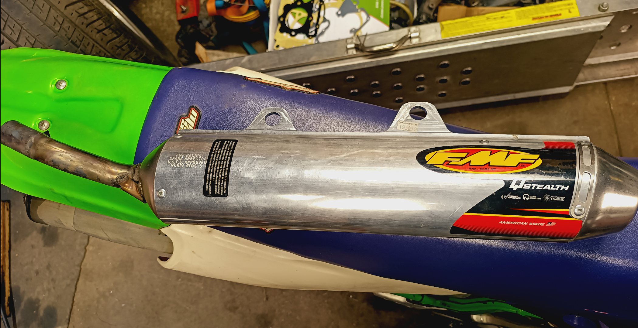

I did also pick up an FMF Q Stealth for a (Spanish-era, pre-rebadged-KTM) 2017-ish Gas Gas spark arrestor to try and fit to the KDX. I may need to graft a KDX inlet pipe onto it if I can't bend the stainless steel Gas Gas inlet stinger tubing on the Q Stealth properly.

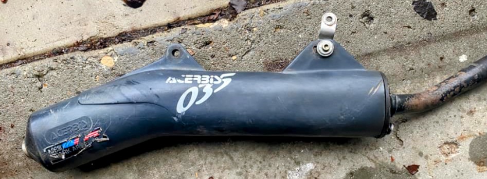

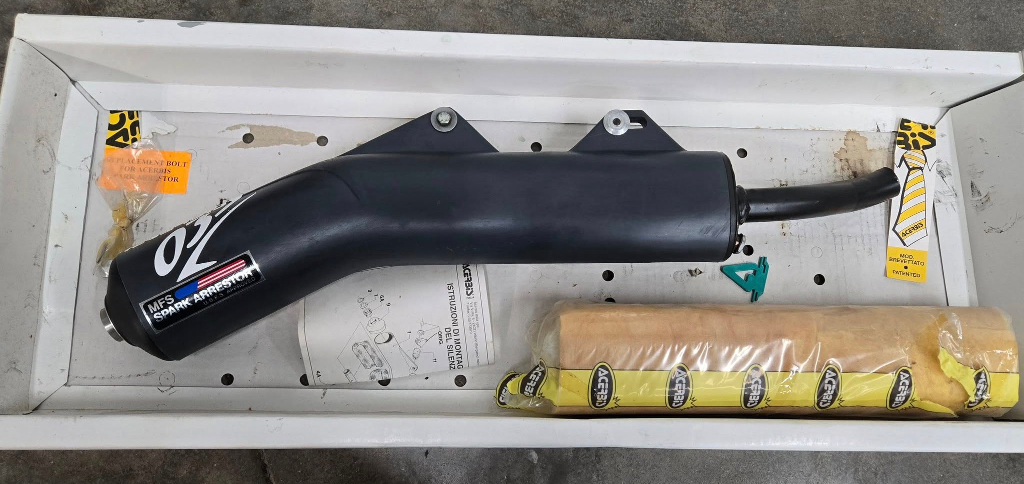

I currently have an Acerbis 035 which is very similarly shaped like a hockey stick, and made of some polyurethane/thermoplastic type material for the canister. They've been long since NLA, discontinued in the late 1990's. They've got a longer perforated baffle + Krizman turbine type spark arrestor on the INLET side. The Acerbis 035 is quieter than the NLA old FMF Q (2" longer version of an Turbine Core 2 that's at most 2-3 dB quieter than the Turbine Core 2),& also quieter than the Pro Circuit Type 296 (which is about 2dB quieter than the Turbine Core 2).
I'm not sure if the KDX250 OEM spark arrestor is a chambered design or just a really long perforated glasspack type tube, but a chambered design will be the quietest.
I'm not going back to the HEAVY stock welded steel muffler. Once they're clogged up, you mostly likely will only be able to clean them by cutting them apart and re-welding when unclogged. The substantial weight alone makes that not an option for me for an already top-heavy bike for a 2-stroke.
I'm curious how this Gas Gas FMF Q-Stealth will do once the inlet angle is adjusted. I also needed to use my plumbing) HVAC swaging tool to slightly expand the flared inlet female coupler portion.
From what I can tell, the Q-Stealth are no longer offered...?

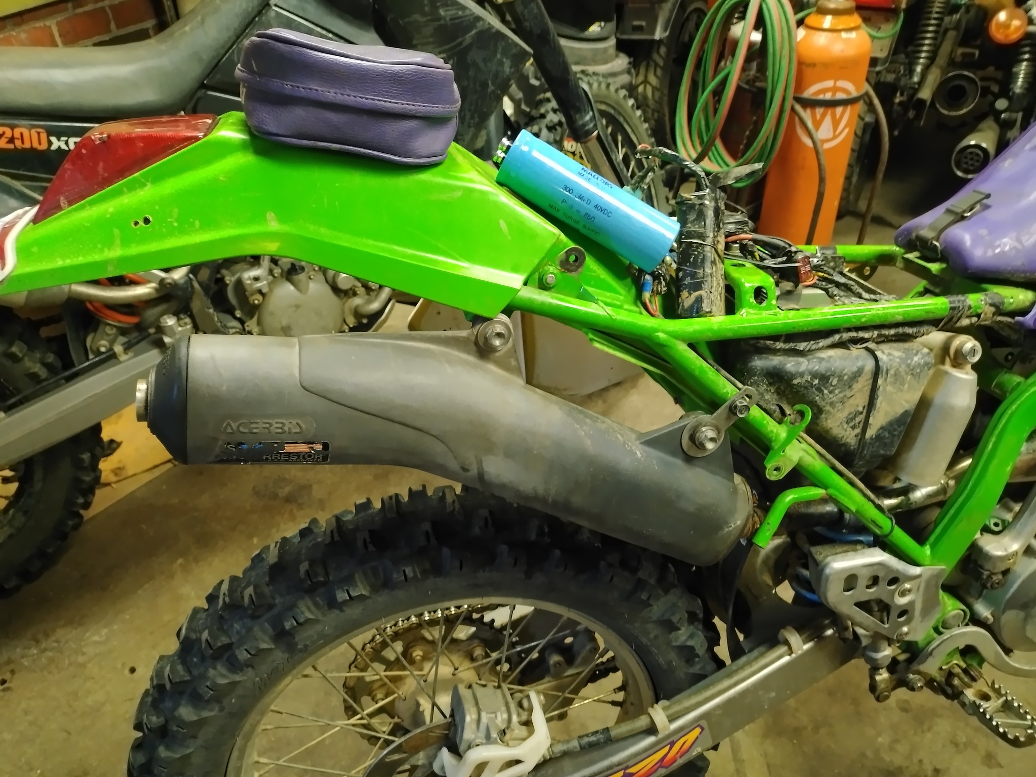

Kdx250sr muffler fitted to my kdx200 in the photo but as of yet untested as it's missing the rear baffle/chambers

kdxdazz wrote: 10:36 pm Aug 31 2025 KDX250SR muffler fitted to my KDX200 in the photo but as of yet untested as it's missing the rear baffle/chambers.
I'm flying back to Thailand this week, once I get the KDX250SR muffler up and running I'll report back on how I did the conversion and if it was worth it
A good friend of mine has a KDX250 which I've spent a fair amount of time working on for him, and I always wanted to take his stock spark & see how it would fit on my KDX 220, as looking at it, it appears very similarly configured.
I suspected the inlet pipe would be a slight bit larger diameter by perhaps 1mm or 2mm, but the mounting points certainly looked nearly identical, and your photo confirm, although uncertain if you've adjusted anything there.

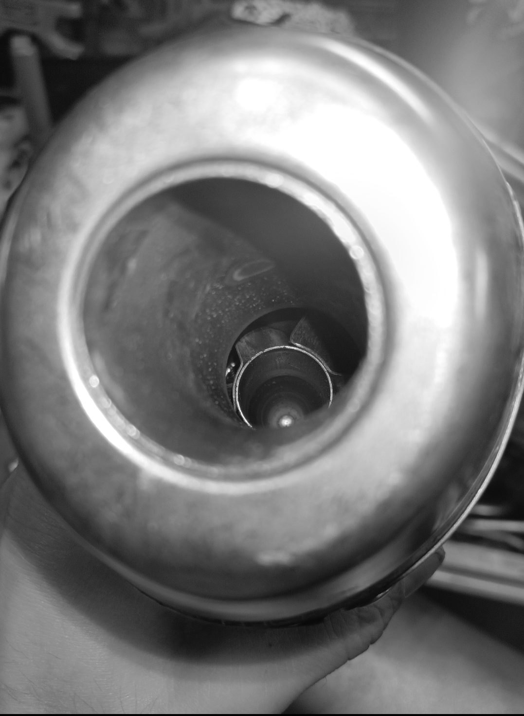

You say the KDX250 muffler is missing the rear baffle/chambers?
Is it not a spark arrestor in the end of it? Or is the spark arrestor on the inlet side like my Acerbis?
More importantly, does it not have just a standard straight through glasspack type perforated baffle pipe?
If this is in fact a chambered muffler/silencer design, I'm fairly certain this would be the ultimate in noise reduction, although a chambered exhaust does add more back pressure and may affect performance.
The FMF Q-Stealth apparently is NOT a chambered design as I'd initially suspected, I would have had mine apart already but it is a riveted design, no bolts. The Q-Stealth is just a standard turbine core style perforated baffle tube + Krizman Bullet spark arrestor, BUT with A LOT more room for fiberglass packing inside, and that is what makes it up to 8 dB quieter apparently.
I'd finally found photos of a Q-Stealth disassembled as someone was converting a CR250 Honda Q-Stealth to work on their CR500AF conversion (larger baffle tube).
This brings up a lot of insight, if FMF put a massive amount of time into designing a quieter muffler, and their quieter design basically just took the FMF Q, which the FMF Q was roughly just a Turbine Core 2 but a few inches LONGER in the baffle)packing area (I have an FMF Q, their inlet pipe bends very easily due to the extra length/leverage beyond the rear mount, and lack of gusseting on the inlet pipe the way the vastly superior Pro Circuit Type 296 has the inlet pipe gusseted + thicker walled material for more strength), and basically just made a 4-stroke-type larger diameter muffler cannister/shell version so that the packing is more loosely installed and with more volume. Perhaps there is some math and science into the lengths of everything to get the sound waves to cancel out better as well?
A lot of people say the FMF Q Stealth made more power than the Turbine Core 2, and I believe it's because the glass pack baffle tube is actually SHORTER length and the spark arrestor is buried deeper into the end. I'm not quite sure what effect that has, but the spark arrestor is roughly 3 inches into the back of the Q-Stealth.
Here is a photo I took last night out in the garage, pardon the black and white, I try it out the night vision on my camera for this:
Perhaps there is a chamber in the rear that does something to dissipate the sound waves and cancel them out, but when you look in the inlet, you see a tube that goes several inches in before you see the Krizman Bullet type spark arrestor. This plus the larger volume of more loosely installed packing must be what makes them quieter, but they are quite large in diameter.
I will pick up a KDX 250 spark arrestor here for modification then if you say they are a chambered design, that should definitely be the best for noise reduction.
I will not go back to the stock OEM spark arrestor, however, especially being so high up on the bike, that is too much weight up high for an already top-heavy bike.

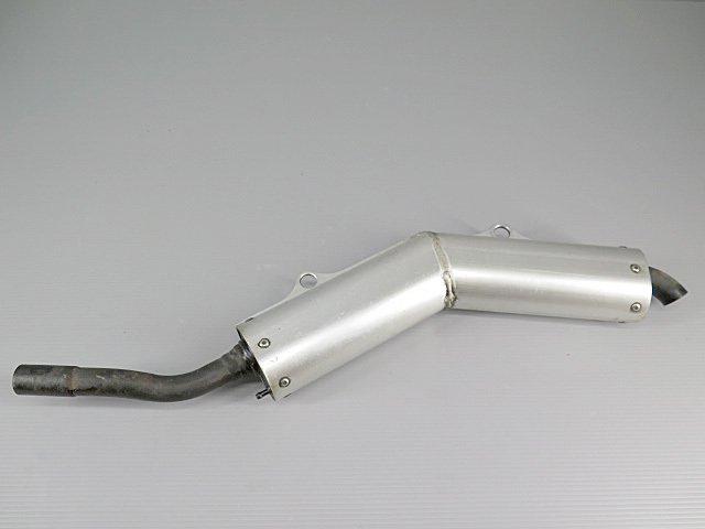

The kdx250sr is a chambered design, the first part is a resonator wrapped in fibreglass, the second part is the chambers, very complicated in design, the mounts don't bolt up at all to the H series, I had to cut off one ear and reweld it in a different position and made an offset mount for the other one, I bought it not knowing it was missing the chambers but I brought it back to Australia so I could make it fit the H series then back in my bag it goes back to Thailand, I have another kdx250sr muffler lined up to use the missing chambers
I don't believe there is any spark arrestor

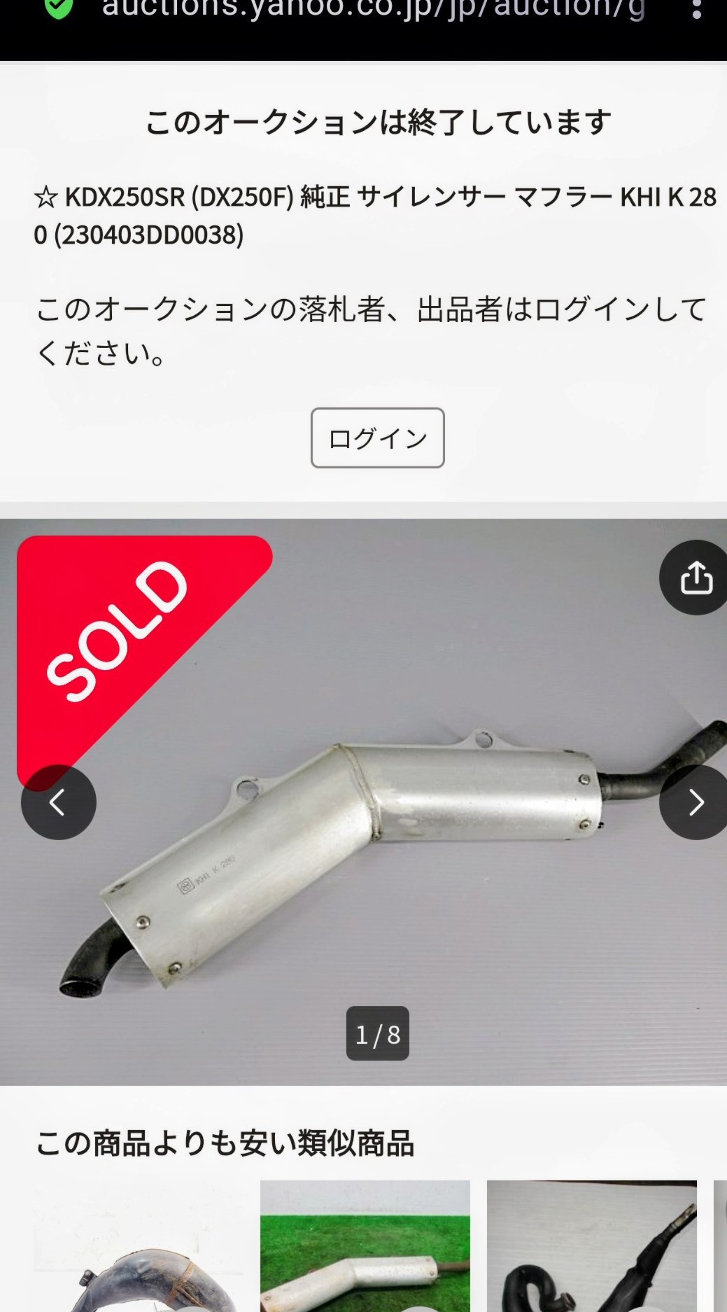

I just did some extensive searching on the majority of my 10 minute break time at work, and could find no real info on repacking the KDX 250D off-road model spark arrestor. I do recall reading somewhere that someone said it's a real pain to do, but that's been a little while now.
I was really hoping to find some pictures to see if it is the same as the SR model just without the turn down and with a spark arrestor added, or if it is a complete glass pack tube with a spark arrestor at the end like most are.
I suppose I will try browsing the Japanese auction sites again for one of these in hopes of getting lucky, but I may also just buy the off-road model version, whichever I can get a seller to give me a low priced eBay offer on, in order to disassemble it to inspect it's design first.

kdxdazz wrote: 04:51 pm Sep 02 2025 I forgot to mention the kdx250 muffler also needs the mid pipe to be cut and shut to fit the H series muffler
I found 10 of them just scanning Japanese auction sites, but 8 out of the 10 all had a note highlighted in red:
"!¡∆¡! You cannot bid on this auction at the present time."
(I assume that's because I am in the USA, where the current government and economy are very uncertain, and tariffs are a guaranteed problem for us now)
It also stated a 20% tarrif will be charged up front for shipping to the USA.
As far as the downturned exhaust tip, yes, that may be to keep oil spray directed down, but I've read multiple places that it also helps keep the sound waves localized and allow the soft dirt surfaces to somewhat diffuse and absorb the sound waves, as opposed to sending them long distances horizontally for others to hear. So this feature may not necessarily reduce the volume very much immediately in the vicinity of the bike and rider, but does in fact improve the decibel level at a distance behind the bike.
I feel that keeping the perforated tube core of the muffler clean and clear, and keeping the packing rather loosely packed in there will be critical in maximizing the sound reduction of the muffler unit. I often wondered if enlarging all of the holes in the perforated baffle tube would help more. It seems to me that it would, with more soft fiberglass packing exposed to the sound waves.
I'm not sure I'll be able to buy these from Japan or not, but I will be eagerly awaiting your reviews.
A chambered muffler certainly would seem to take away a bit of the maximum flow and top end power I'd imagine. So the above techniques as well as possibly trying out this FMF Q-Stealth spark arrestor muffler while continuing to wear earplugs while riding may suffice for the time being. In the long term, I would like to find some sort of silicone coating for the expansion chamber to take the edge off of the sound transmission.
I picked up those 220SR heads off Yahoo Auctions Japan earlier this year, but have not been able to do anything with them yet, but hope to this winter. I'm eager to see what kind of torque I can get out of those or even just making one somewhere in between the stock SR and the Ron Black 220 head profile. The 220SR head + FMF Gnarly Woods pipe RB-modified 36mm divider plate added PWK35 Air Striker or SmartCarb SC3 34 would potentially make the absolute ultimate torquey hard enduro woods weapon. I would absolutely not run a 28mm round slide carb unless I was unable to readily get any other carb, but I would consider running a 28mm flatslide carb designed for Supermini 2-stroke race bikes like the KX100/112 & KX85. The throttle response gains from the flatslide technology is undeniable.

I have been moderately pleased with my quietest spark arresters which I've ran thus far, the long since out of production 1990's Acerbis 035 models, but still looking for quieter options...
The Acerbis 035 + the dB Snorkel certainly will make a stealthy silencer if I can get the aftermarket expansion chambers coated in something to dampen the noise levels yet, but I'm still seeking and even quieter single silencer (one that won't require the long out of production dB Snorkel which is very scarce due to being an expendable silicone rubber add-on). The FMF Q-Stealth or the chambered KDX250SR may be the only quieter options. Stock is far too heavy and too high up on the bike for that kind of weight carrying.
The Acerbis 035 I'm guessing is very similar to the off-road model KDX250D spark arrester. The 035 is the longest of the perforated glass pack tube type baffles with a Krizman Bullet type USFS Spark Arrestor as well. I believe I recall the spark arrester being on the INLET side of these, whereas most are on the outlet.
The shells of the Acerbis 035 models are some sort of urethane thermoplastic material, flexible and temperature resistant. This + a thorough cleaning and burning out of carbon + a good loose repacking job with quality fiberglass packing should be as quiet as a KDX250D model spark arrester if not slightly moreso.
'94-'98 KX250 version Acerbis 035 pictured:
According to the original packaging for a brand new NOS Acerbis 035, '94-'98 KX250 application (I'd bought this & a '96 KX125/250 purple shrouds set & watching for a blown up '96-'98 KX125 for KX125/KDX220R hybrid build purposes!), the Acerbis 035 reduces OEM KX, CR, KTM etc decibel levels by up to 6dB, coming in consistently at 91.5dB to 92dB due to the longer perforated baffle tube + urethane type shell construction, vs OEM mufflers at 94, 95, 98+dB levels as tested by the FIM (ISDE sanctioning body).
While some claim 92-94dB readings with a turban core 2, this will guaranteed be quieter if using the same packing material and packing techniques.
The chambered KDX250SR may promise to be the quietest aluminum spark arrestor of all, however... I'll see if I can get one from Japan auction sites despite the tarriffs and the many international bans on shipping to the USA. I may buy a US-market KDX250D spark arrestor to compare if I can find one for a good price (& use the USFS-approved stamped cannister with SR internals whose shell bears no USFS-approved markings), or perhaps disassemble the one on my buddy's KDX250 for my inspection / his re-packing purposes only, if he ever decides to ride it again, hence requiring me swapping tires chain sprockets & cleaning the carb at minimum.

Well, I took a bit of a chance and bought one of the only three KDX250SR mufflers on Yahoo Auctions Japan that would allow me to bid on them, the rest had a warning statement "!¡∆¡! You cannot bid on this auction at the present time." (Because it saw that I was in the USA, where there is currently a great deal of economic and regulatory uncertainty to be sorted out).
$35 + taxes & regional shipping so far = $45.
The brokerage service then will receive it and charge me a fee to ship it DHL to the USA, Probably $55. Still, surprisingly cheaper than buying the off-road version directly in the USA.
Hopefully it wasn't a wasted effort. The brokerage service Buyee temporarily halted their typical 30 days of free storage fees, as you can't buy direct from the Japanese auction sites typically, you have to go through a broker because the auction sites normally will not ship to the USA even under normal times without all the economic/regulatory uncertainty. You would win the auctions through the brokerage service, the items would get shipped to their warehouse, and then they would choose the appropriate service that will ship to the usa. Currently Japan EMS Post will not ship anything to the USA whatsoever, no matter who you are in Japan (previously it was just the auction sites that would not deal with US bidders), so they have to use DHL or other services.
They typically store the item for up to 30 days for free while you are free to buy additional items from the Japanese sites, in order to consolidate your shipment into one package to save money. Now they have paused the 30-day countdown of free storage, assuming that there will be difficulties with the tariffs and shipping...
I'm fairly certain the chambered KDX250SR silencer will end up being the quietest available after modifying it to fit the KDX220R / KDX200H,
...but as Darryl points out, the chambered silencers / mufflers will limit top end RPM airflow and thus slightly restrict top end power. If it weren't for this, I would have probably bought TWO of them from Yahoo Auctions Japan.

***If anyone happens to have a beat up stock spark arrestor which they no longer care about, I would gladly accept any offers to sell them to me for a reasonable price for your time, or just send the lower half with the inlet stinger mid pipe section... Or trade me, as I believe I have a very clean original still, and no intentions of using it ever with all of these other significantly more lightweight aftermarket offerings versions that are still moderately quiet versus a Turbine Core 2, Power Core, or PC Factory Sound mufflers
I'm assuming I might have to graft the stock inlet pipe onto both the FMF Q-Stealth and the KDX250SR, although it may be possible to heat up and bend both pipes, but creasing the mid-pipe inlet tubing is a potential risk. My FMF Q (NLA KDX application, simply just a slightly longer Turbine Core 2) has been creased at least three times in crashes, and heated up and bent back, because the tubing is so thin compared to the Pro Circuit Type 296, and it lacks any gusseting unlike the Pro Circuit Type 296 which has a healthy gusset at the inlet, in conjunction with being the longest of all spark arrestors and mufflers, hanging out considerably behind the rear mounting point.
I have one stock spark arrestor from the 200/220 in my possession still, I sold another one a while back. I believe I sold the beat up one which would have been a great candidate for this! I am not attached to this remaining OEM 220R/200H muffler whatsoever if someone wanted to upgrade to a nicer one, and had a dented or rusted version to trade - as long as the inlet pipe was intact.
Even better would be a damaged FMF or Pro Circuit version that still had a good inlet pipe, as they're stainless steel.
