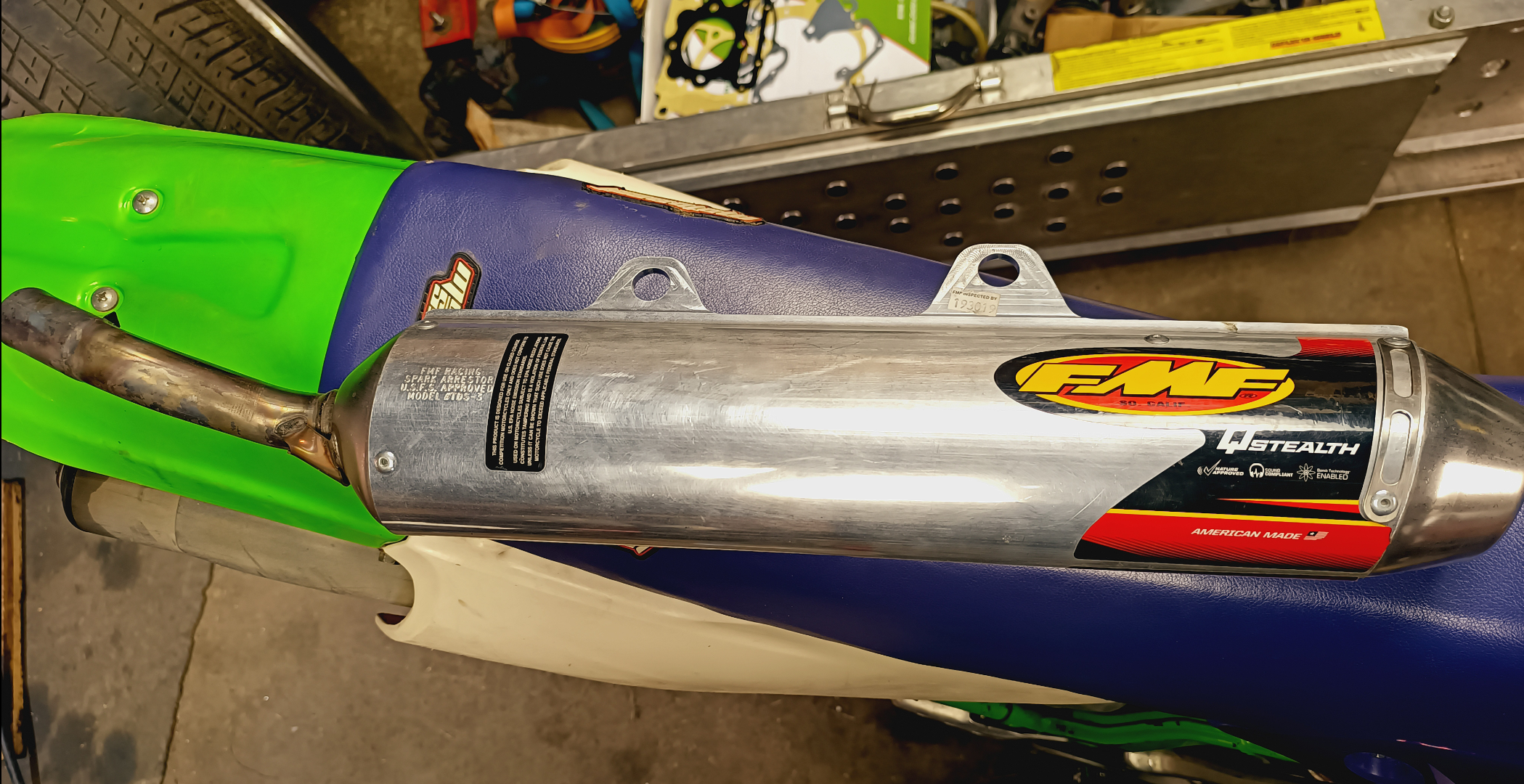

I did also pick up an FMF Q Stealth for a (Spanish-era, pre-rebadged-KTM) 2017-ish Gas Gas spark arrestor to try and fit to the KDX. I may need to graft a KDX inlet pipe onto it if I can't bend the stainless steel Gas Gas inlet stinger tubing on the Q Stealth properly.

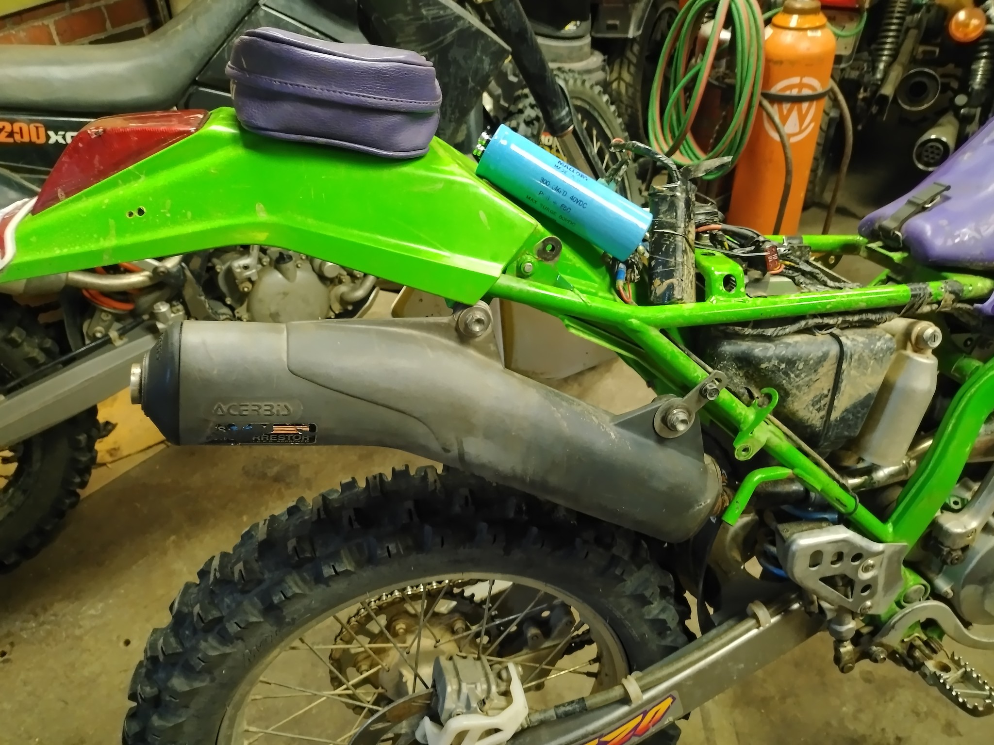

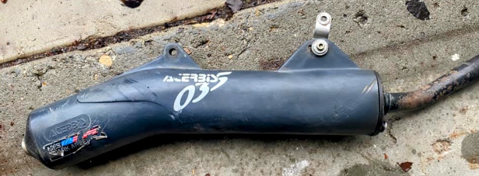

I currently have an Acerbis 035 which is very similarly shaped like a hockey stick, and made of some polyurethane/thermoplastic type material for the canister. They've been long since NLA, discontinued in the late 1990's. They've got a longer perforated baffle + Krizman turbine type spark arrestor on the INLET side. The Acerbis 035 is quieter than the NLA old FMF Q (2" longer version of an Turbine Core 2 that's at most 2-3 dB quieter than the Turbine Core 2),& also quieter than the Pro Circuit Type 296 (which is about 2dB quieter than the Turbine Core 2).
I'm not sure if the KDX250 OEM spark arrestor is a chambered design or just a really long perforated glasspack type tube, but a chambered design will be the quietest.
I'm not going back to the HEAVY stock welded steel muffler. Once they're clogged up, you mostly likely will only be able to clean them by cutting them apart and re-welding when unclogged. The substantial weight alone makes that not an option for me for an already top-heavy bike for a 2-stroke.
I'm curious how this Gas Gas FMF Q-Stealth will do once the inlet angle is adjusted. I also needed to use my plumbing) HVAC swaging tool to slightly expand the flared inlet female coupler portion.
From what I can tell, the Q-Stealth are no longer offered...?

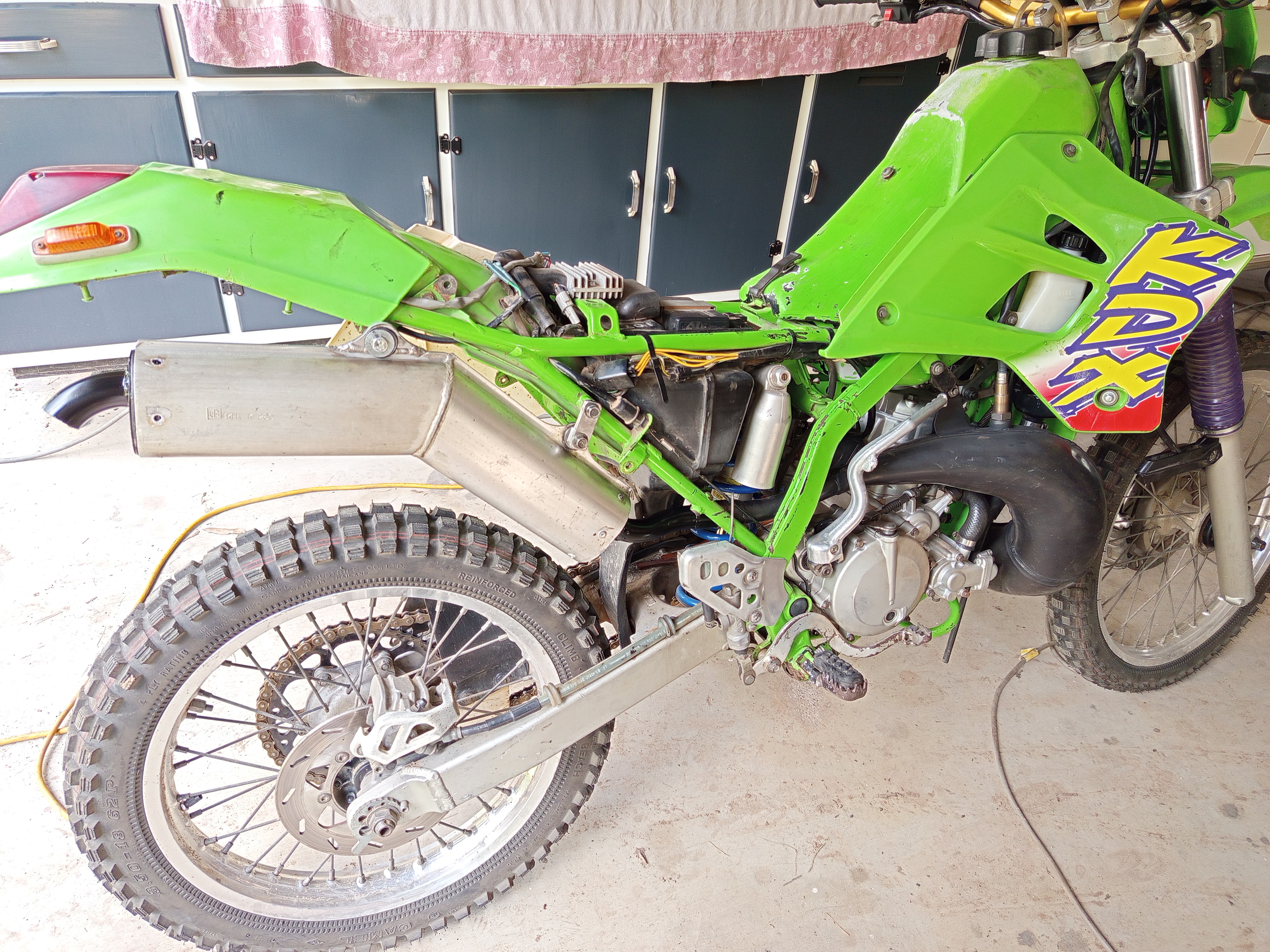

Kdx250sr muffler fitted to my kdx200 in the photo but as of yet untested as it's missing the rear baffle/chambers
Spent the last 2 days comparing the stock expansion chamber Vs procircuit platinum 2, after a while I didn't even want to ride the kdx with procircuit pipe because of the noise, OEM is 4.0kg, procircuit is 2.8kg, will try to do a write up at some point as I connected the wideband O2 sensor to both of them to monitor jetting changes needed
On the subject of muffler packing, I have here some OEM yz426 muffler packing from twenty something years ago when I bought it new, the first part of the wrap is fine steel wool, I think the idea is it allows the sound to penetrate in to the fibreglass
I've also tried the whole expansion chamber wrapping thing, my idea was wrapping with the heat proof wrap first then I cut strips of rubber from old car inner tubes, definitely a reduction in sound but nowhere near as good as OEM and then all the problems of water entrapment and rust
I'm flying back to Thailand this week, once I get the kdx250sr muffler up and running I'll report back on how I did the conversion and if it was worth it

The FMF Q-Stealth apparently is NOT a chambered design as I'd initially suspected, I would have had mine apart already but it is a riveted design, no bolts. The Q-Stealth is just a standard turbine core style perforated baffle tube + Krizman Bullet spark arrestor, BUT with A LOT more room for fiberglass packing inside, and that is what makes it up to 8 dB quieter apparently.
I'd finally found photos of a Q-Stealth disassembled as someone was converting a CR250 Honda Q-Stealth to work on their CR500AF conversion (larger baffle tube).
This brings up a lot of insight, if FMF put a massive amount of time into designing a quieter muffler, and their quieter design basically just took the FMF Q, which the FMF Q was roughly just a Turbine Core 2 but a few inches LONGER in the baffle)packing area (I have an FMF Q, their inlet pipe bends very easily due to the extra length/leverage beyond the rear mount, and lack of gusseting on the inlet pipe the way the vastly superior Pro Circuit Type 296 has the inlet pipe gusseted + thicker walled material for more strength), and basically just made a 4-stroke-type larger diameter muffler cannister/shell version so that the packing is more loosely installed and with more volume. Perhaps there is some math and science into the lengths of everything to get the sound waves to cancel out better as well?
A lot of people say the FMF Q Stealth made more power than the Turbine Core 2, and I believe it's because the glass pack baffle tube is actually SHORTER length and the spark arrestor is buried deeper into the end. I'm not quite sure what effect that has, but the spark arrestor is roughly 3 inches into the back of the Q-Stealth.

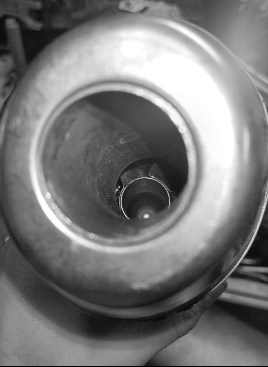

Here is a photo I took last night out in the garage, pardon the black and white, I try it out the night vision on my camera for this:
Perhaps there is a chamber in the rear that does something to dissipate the sound waves and cancel them out, but when you look in the inlet, you see a tube that goes several inches in before you see the Krizman Bullet type spark arrestor. This plus the larger volume of more loosely installed packing must be what makes them quieter, but they are quite large in diameter.
I will pick up a KDX 250 spark arrestor here for modification then if you say they are a chambered design, that should definitely be the best for noise reduction.

The kdx250sr is a chambered design, the first part is a resonator wrapped in fibreglass, the second part is the chambers, very complicated in design, the mounts don't bolt up at all to the H series, I had to cut off one ear and reweld it in a different position and made an offset mount for the other one, I bought it not knowing it was missing the chambers but I brought it back to Australia so I could make it fit the H series then back in my bag it goes back to Thailand, I have another kdx250sr muffler lined up to use the missing chambers
I don't believe there is any spark arrestor
Part of noise suppression in the expansion chamber is the thickness of the material so there is no way around it, heavier and quieter or not, the weight on the stock pipe compared to aftermarket really is negligible given the weight is carried low but like you say the procircuit has an incredible midrange hit compared to stock, I prefer stock for it's off idle performance and like you say the procircuit just seemed to wheel spin and break traction which made it exhausting to ride, I wasn't able to test it as much as I like due to noise and disturbing neighbours
I'll test the kdx250sr muffler using the wideband O2 sensor so I can see what jetting changes are needed
Not sure if you saw my drz400 hayabysa muffler conversion video but on that bike I tried 4 different mufflers and nothing beats size and chambers, it's not that the power is less but the engine was slightly less responsive which for me is a good thing as Thai asphalt is incredibly slippery

Chuck78 wrote: 12:50 pm Sep 02 2025I'll begin watching out for a good deal on a used North American Market KDX 250 off-road model muffler, as modifying one of these will most definitely be the most noise reduction possible if it is a chamber design and none of the other ones are, even the Q-Stealth.kdxdazz wrote: 03:10 pm Sep 01 2025 The KDX250SR is a chambered design, the first part is a resonator wrapped in fibreglass, the second part is the chambers, very complicated in design.
The mounts don't bolt up at all to the H series, I had to cut off one ear and reweld it in a different position and made an offset mount for the other one.
I'll test the KDX250SR muffler using the Wideband O2 sensor so I can see what jetting changes are needed
I would bet that the NLA FMF Q Stealth is probably going to be the quietest without affecting any performance however.
I was almost certain the KDX250 was a spark arrestor, but the way I see it, a chambered muffler on a two-stroke absolutely does not need any additional devices to make it a spark arrestor. It is argued that two strokes don't even need spark arrestors whatsoever, but the U.S. Forest Service just requires them regardless, 2T or 4T engine.
EDIT: comparing your photos and the stamping on the outside, versus eBay photos of US market KDX250 spark arrestors, the US market off-road model versions definitely say US FOREST SERVICE APPROVED SPARK ARRESTOR DX250D stamped into them on the rear inner portion near the outlet. Your SR model has a turn down tip also which is known to reduce the distance the sound travels since it directs the sound directly at the dirt or pavement, instead of straight out through the air. The off-road model just shoots it straight out the back with just a stub of a pipe. The off-road model can definitely have a turn down added to it however, but I'm just not certain if the off-road model is anything more than just an extra long glass pack perforated tube.
I wish I would have been looking for one of these before all of these silly tariffs, when I was using the Japanese auction sites and buying services to buy parts from Japan for dirt cheap. I don't think that is very possible at this point. We never got the SR model here obviously.
I, personally, absolutely love the Pro Circuit Platinum 2 power delivery and tune, even for compromised traction technical steep slippery woods riding, although the FMF gnarly Woods is definitely the better pipe in that department, the overall power delivery is resulting in much greater peak mid-range and upper mid-range power with the Pro Circuit, which is why I really I'm interested in doing something to quiet down the expansion chamber sound.kdxdazz wrote: 03:10 pm Sep 01 2025
Part of noise suppression in the expansion chamber is the thickness of the material so there is no way around it, heavier and quieter or not, the weight on the stock pipe compared to aftermarket really is negligible given the weight is carried low but like you say the procircuit has an incredible midrange hit compared to stock, I prefer stock for it's off idle performance and like you say the procircuit just seemed to wheel spin and break traction which made it exhausting to ride, I wasn't able to test it as much as I like due to noise and disturbing neighbours.
The muffler / silencer design definitely plays a large part as well though obviously, because KTM 200 models with their OEM non-spark arrested very very long glass pack mufflers are considerably quieter than any thing I have ran on my KDX's even freshly packed, while those bikes also had FMF aftermarket pipes instead of the slightly thicker OEM versions. That alone tells me there are significant gains to be had with a better noise canceling noise suppressing silencer design, although the stock KDX double walled pipe would absolutely be the quietest expansion chamber, but I'm not sold on the performance trade off if I could possibly do something further to suppress a bit of noise from the Pro Circuit expansion chamber.
I'm fairly convinced that the metal is slightly thicker on the FMF expansion chambers, but it's still a significantly louder than the stock double walled expansion chamber. Some of the KTM models even came with an oem expansion chamber made by FMF, however most people are running the aftermarket versions out of the guys I ride with after years and years of slamming the bikes down and damaging the chambers.
Had you made any write-ups yet about your take on jetting for the stock pipe versus the Pro Circuit? Or are you just done with the Pro Circuit due to the noise?
I haven't done any write ups yet, I only ran them back to back and wrote down the AFR numbers, I only had a very short straight road with an incline to test on so it was hard to get accurate readings, acceleration Vs constant throttle gives very different AFR numbers and that's something I need to improve my knowledge on. I also tested shell E10 fuel as in Thailand it's almost exclusively E10. Either way I didn't want the noise, I've decided to keep my kdx220 as a dedicated road/race bike so I want it to be as quiet as possible given it's illegal to ride it on the road, the other kdx220 with the keihin pe28 will be my dedicated jungle bike as that thing is an off idle torque monster
The downward facing tip is not really for noise reduction, as I found out the hard way I was going out for dinner, waiting at the traffic lights behind an nsr150 with an aftermarket muffler which had the straight tip, it sprayed oil all over my crisp white shirt, I wasn't happy and that was the end of the shirt
If you like I can link you to the Thai kdx group, they sometimes have kdx250sr exhausts come up for sale although they don't use PayPal,it's only direct bank transfer so it's always a risk
When I do a write up I'll also talk about the strength of pipes compared, the procircuit feels like it's made of baked bean tins compared to OEM as I had to straighten both of them and remove dents
I will say that I could never get the top end performance back on the kdx200 after I sold the aftermarket muffler and went back to OEM, although it's night and day after decarbonising, it still doesn't have the top end rush of whatever aftermarket muffler that was on it

I have been moderately pleased with my quietest spark arresters which I've ran thus far, the long since out of production 1990's Acerbis 035 models, but still looking for quieter options...
The Acerbis 035 + the dB Snorkel certainly will make a stealthy silencer if I can get the aftermarket expansion chambers coated in something to dampen the noise levels yet, but I'm still seeking and even quieter single silencer (one that won't require the long out of production dB Snorkel which is very scarce due to being an expendable silicone rubber add-on). The FMF Q-Stealth or the chambered KDX250SR may be the only quieter options. Stock is far too heavy and too high up on the bike for that kind of weight carrying.
The Acerbis 035 I'm guessing is very similar to the off-road model KDX250D spark arrester. The 035 is the longest of the perforated glass pack tube type baffles with a Krizman Bullet type USFS Spark Arrestor as well. I believe I recall the spark arrester being on the INLET side of these, whereas most are on the outlet.
The shells of the Acerbis 035 models are some sort of urethane thermoplastic material, flexible and temperature resistant. This + a thorough cleaning and burning out of carbon + a good loose repacking job with quality fiberglass packing should be as quiet as a KDX250D model spark arrester if not slightly moreso.

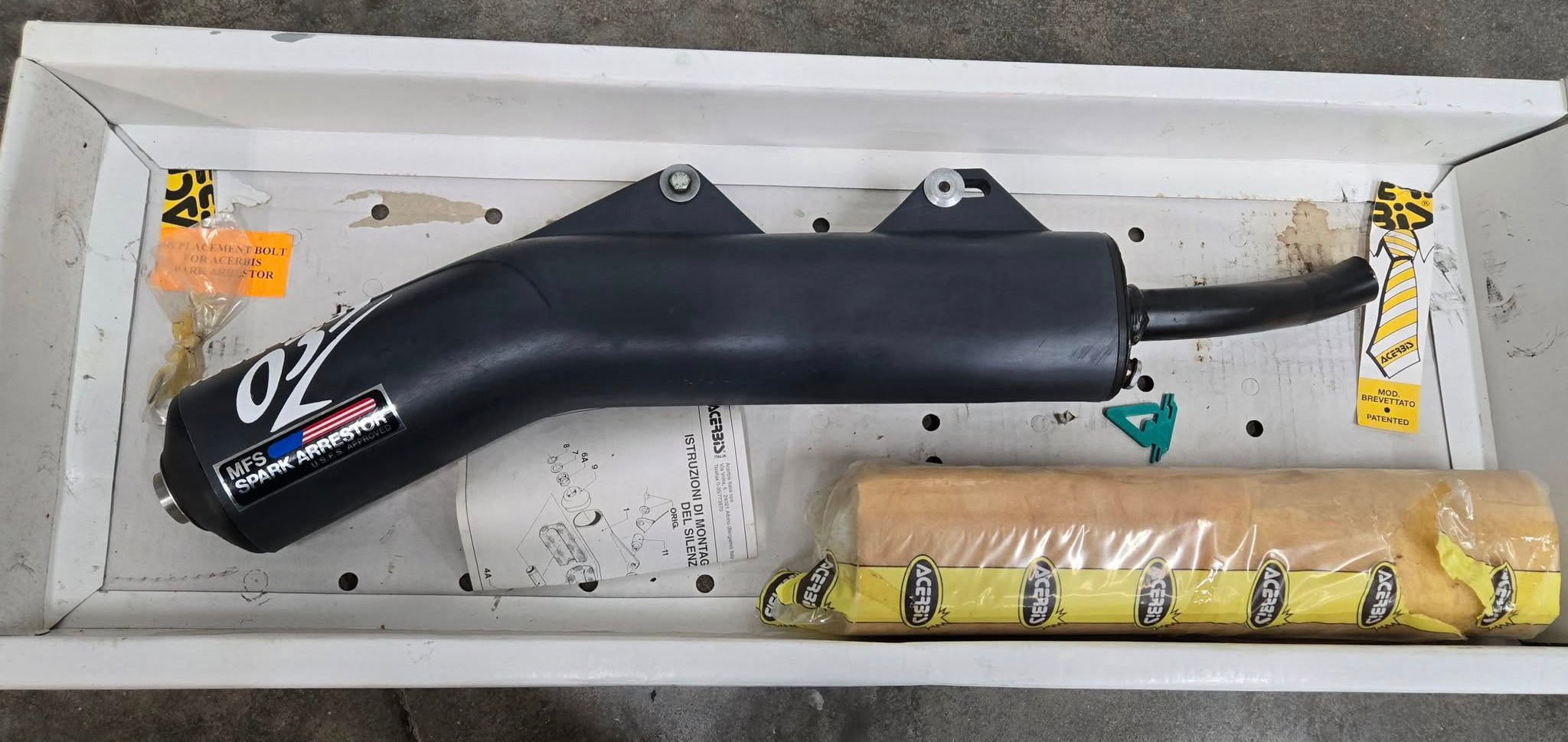

'94-'98 KX250 version Acerbis 035 pictured:
According to the original packaging for a brand new NOS Acerbis 035, '94-'98 KX250 application (I'd bought this & a '96 KX125/250 purple shrouds set & watching for a blown up '96-'98 KX125 for KX125/KDX220R hybrid build purposes!), the Acerbis 035 reduces OEM KX, CR, KTM etc decibel levels by up to 6dB, coming in consistently at 91.5dB to 92dB due to the longer perforated baffle tube + urethane type shell construction, vs OEM mufflers at 94, 95, 98+dB levels as tested by the FIM (ISDE sanctioning body).
While some claim 92-94dB readings with a turban core 2, this will guaranteed be quieter if using the same packing material and packing techniques.
The chambered KDX250SR may promise to be the quietest aluminum spark arrestor of all, however... I'll see if I can get one from Japan auction sites despite the tarriffs and the many international bans on shipping to the USA. I may buy a US-market KDX250D spark arrestor to compare if I can find one for a good price (& use the USFS-approved stamped cannister with SR internals whose shell bears no USFS-approved markings), or perhaps disassemble the one on my buddy's KDX250 for my inspection / his re-packing purposes only, if he ever decides to ride it again, hence requiring me swapping tires chain sprockets & cleaning the carb at minimum.
